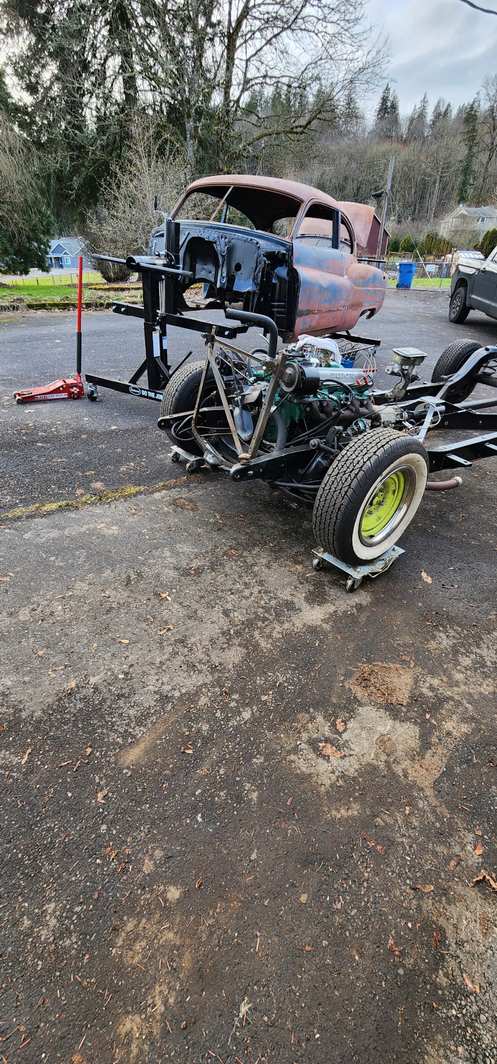

    Been grinding away on a 50 jetback. Basically the entire bottom 6" of the car was gone. another 50 jetback came up about 2 hours from me. I couldn't resist and had to go take a look.
    What a find....Car was blown apart in the mid 70's and kept in a garage. Every thing has been bagged and labeled, including every factory nut and bolt. Totally rust free except floor pans. No biggie. Much easier than inner and outer rockers plus the entire floor that I've been working on.
    Factory visor, all the gl***. (including the rear!) Perfect rockers and doors. Not a piece missing. I even have seats, which I didn't have before!! None of the door and window parts are rusty and stuck.
    Took it home, next day swapped bodies onto the ch***is I have already dialed with a Nailhead.
    Couldn't be more stoked. Just need to order rubber for the gl*** and the dash can go in after the windshield and can wire it. This saved me a TON of time. Now I'm confident I can get it back together and on the road by mid May and enjoy the hell out if it all summer!
    Really happy. Wife doesn't care, so I had to share with people who understand. Thanks for entertaining my giddyness...

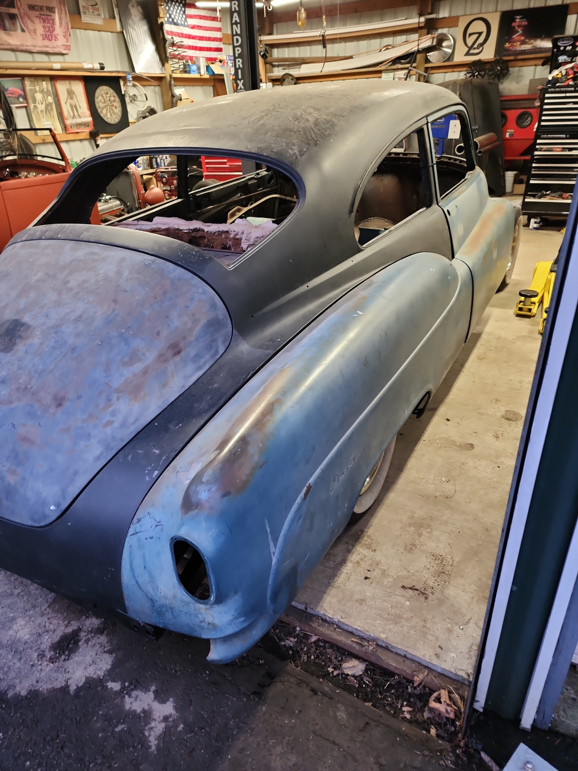

    Is there a long welded seam along the roof skin, just above the driver's door and quarter window? What was that from?
    Floors look nice, and the second car sure seems like the way to go. Once you're all done, you can eBay the leftovers/duplicates, those cars part out really well. They're good looking cars, and the Nailhead is neat, too.
  15. OZCAST
    Joined: Oct 12, 2020
    Posts: 279
    OZCAST
    Sometime in the last 75 years the roof was cut off and put back on. No idea when or why. Whoever did it did one hell of a job though. I've been all through it. No pinhole, really straight. No warping. Very strange though
    Squablow likes this.
  16. Squablow
    Joined: Apr 26, 2005
    Posts: 18,694
    Squablow
    That's interesting, I wish that car could tell that story. That's a pretty unusual repair for a 50's car, something would really have to tear up that roof to get a whole new one put on, or just to cut it off and put it back on. Today you'd do that for hail damage, but not on that car. Also a very difficult welding repair on a huge open panel like that.

    Really strange. The whole roof was taken to bare metal and primed as well. And not with a rattle can. It had to be a body shop and from what I can tell, a really good one. Roof is dead straight

    Could be. Who knows... I'm just gunna wire wheel and seam seal the inside and call it good. Headliner will take care of the eye sore.
