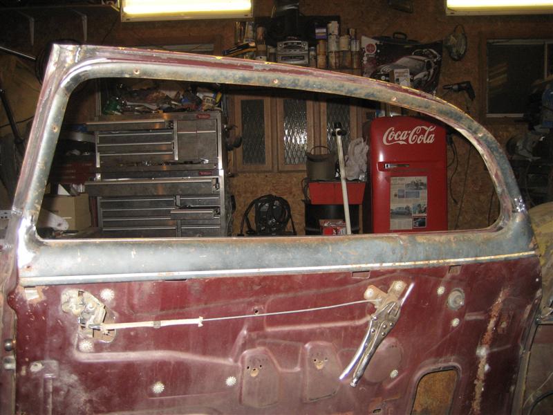

    Little vent window work
    Tear it apart
    Measure it up
    Bend er up. No idea if theirs a better way to do this has to be a better way that don't screw up the chrome.
    Check for fit
