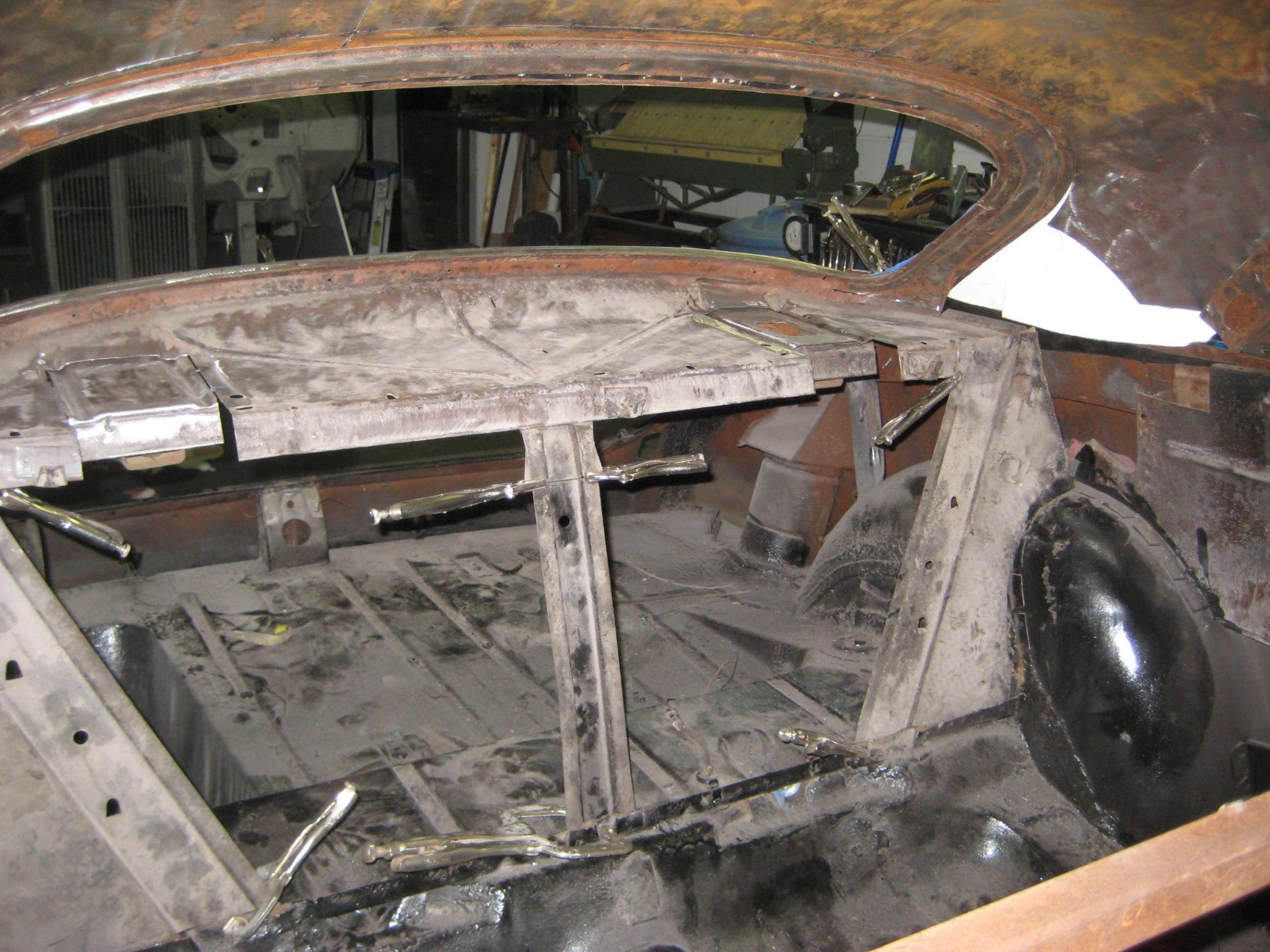

    Working on the catwalk panels- In some respects this may be the coolest and most unusual element of this chop. moving the rear window forward is something we've seen on other chops, but never on a Chevy. I don't doubt someone has done it, and would love to see it if they have.

    Just a couple of pics. from today. The rear of the car is starting to take shape.

  5. That cat walk... mm nice! great flow in the rear

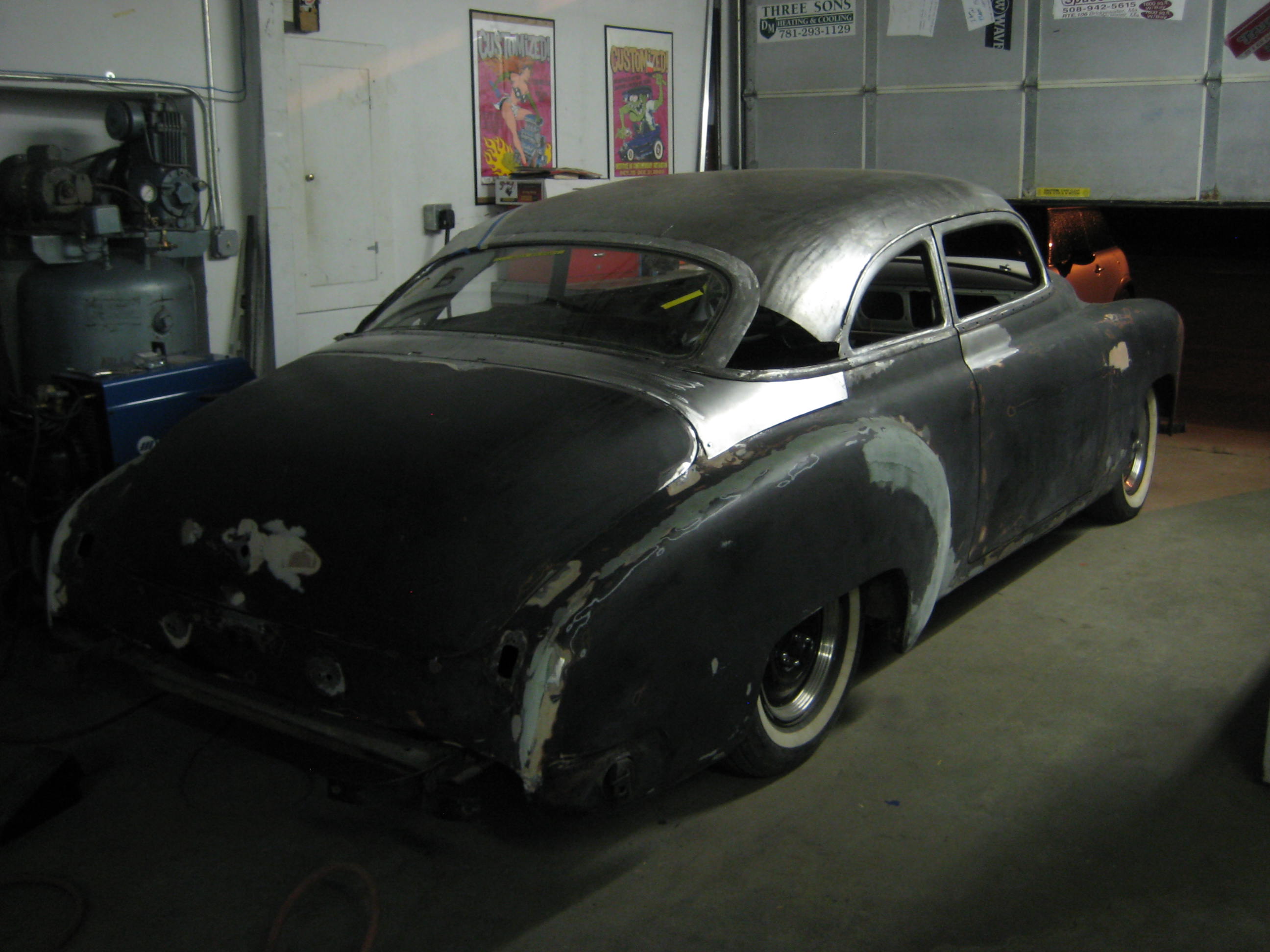

    Great looking chop, now your roof line has a sweet flow to the deck lid. I Like It!!

    A couple more pics. from today. Rear of the roof is starting to come together.

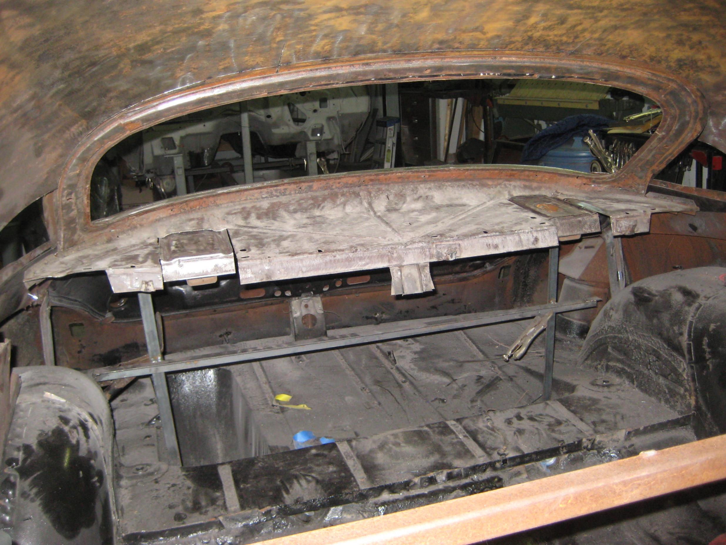

    More pics., Got the trunk working with no flex in the package tray. Started the miles of welding that this thing is going to have. The amount of extra work to get just 2" of forward movement with the window is so worth it. The lines on this car are just coming together nicely. We do plan on using the beltline trim, it is going to take some tweaking to make it fit. Thanks for all the great comments. Thanks, Jon.

    more pics. Starting to take shape.

    and some more.

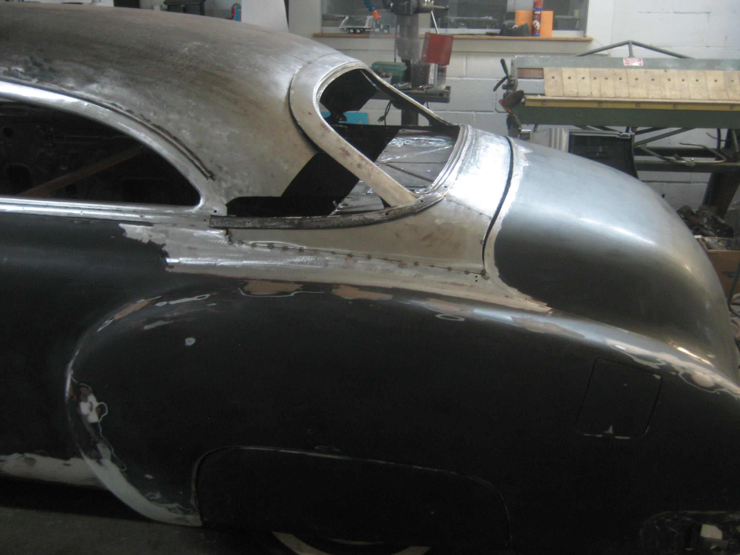

    Today was one of those great days that keep ya going on a build..The Sail panels areall fabbed and tacked in place. It's awesome and energizing finally get to see the whole profile and I'm freakin' thrilled. Everything flows and rolls just the way I had hoped and Jon's idea of moving the rear window forward ..well..I love the result..

    Great idea on the extra long vise grips:D!!! That chop is slick too!

    Lookin Sweet! Killer Profile! Flows just right...

    Amen! Killer profile...one of the best!

  28. Absolutely stunning flow on your roof.Great lookin car too....I love hearing how you were working on getting the stance where you wanted it . Roof is one of the best I have seen on a chevy,great lookin Custom.
