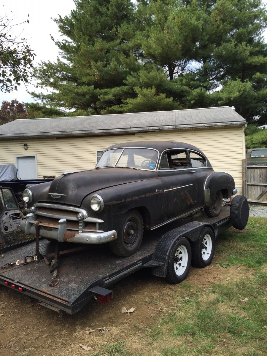

    Hey guys I'm new to the hamb but not new to old cars. I recently just bought this 1950 Chevy fleeline deluxe from a small town in Pennsylvania.My future plans are too fix the sheet metal and clear the original patina, lower the car and insert a newer gm 4.8 ls motor with a carb along with a newer auto of some sort and a 8.5 10 bolt rear. my question is what is the best way to go with the suspension? I'm currently looking at the Jimenez bros front mustang 2 front suspension and might go with posie springs in the rear. Opinions?
