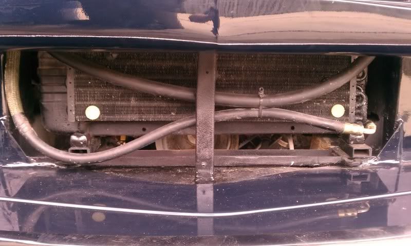

  12. I've been researching radiator upgrades for my car ('51 Mercury) and I think folks go with overkill on radiators. I know folks who go with like $800 3 core radiators for small block setups.
    I have a highly inefficient setup in front of my cammed SBC with a 16" electric fan and it keeps up... And my buddy says it's a 4 cylinder Pinto rad.
    http://i638.photobucket.com/albums/uu101/ProStockJohn/1951 Mercury Project Mercula/IMAG0336.jpg
    I'm looking at some of those Jegs/Summit OEM style replacement radiators in the 25x19 range...
