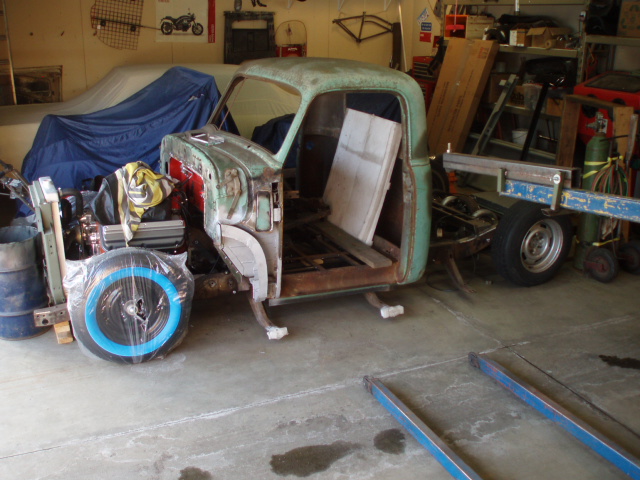

    As some might know, I bought a 50 truck for my next project. It has taken a while to get it all stripped down, and the extra frame bits cut off. The good news is the frame is straight and only a couple of things to weld up.
    I just finished welding up and installing up the No Limit air bag front end, went pretty well.
    I think this will drop it quite a bit, I am getting a 9" rear from Tuck, and starting the rear when I get back from Strugis.

    More progress! Having secured a 9" from Tuck's place last Thursday {only getting stung by bees several times} I mocked it in place this weekend. I think I will move the lower shock mounts to the front of the axel for clearance, the panhard bar is too close to mount them in the rear. I still have to get a front mount for the truck arms, would like to find a stock setup- but I can build one if I have to.[​IMG]

    Ok I have been busy on this for a few days, progress is got the C-notches in, moched the front crossmember in, placed the air bags and mounts, and I think am happy with the location of the shocks{driver side mounted for now.I am thinking of putting some 2" blocks also, but I need to get longer U-bolts. Right now its all tac ked together. If I do the blocks, will move the panhard bar up.
    [​IMG][​IMG][​IMG]
    What do you think so far........?

    No kit, I am using stock trailing arms from a later truck, and a dropped crossmember from CCP, and then some parts from the welder series place, I have about 300 less tha going with a 4 link, but if I was to do over I would prob go with the 4-link from No-Limit, running exhaust will be interesting.I am tring to get really low without putting the rear into the bed, so stock bed.Won't be dragging frame but, I want to use as a truck also.

    The front of the boards should touch, but the rears prob 2-3 inches from touching, I not putting a big notch in the bed, on tires prob run 205 or 215/75/15's front and 235/75/15 rear, should fit, going to get Diamond back wide whites, going mild custom on it.

    More Progress, and Pics! I have mocked up the drivetrain...
    Theres a couple of things I have to changs on the motor but looks like could be the spot, and if I ever get another early car/truck I can swap in a sbc and keep the hemi. Oh now I am looking for a radiator.

    Just curious, but when is the last time you mocked it up with tires and fenders on the front and got the truck off the jack stands? From what I can see, I think Id be cautious that your front end isnt sitting way high after you get it on the ground.

    New pics, I have been doing som work, brake lines are run, the front lines under the motor need to be finished and bolted down. will finish those when I pull the cab and drivetrain, put the tires on, if anybody was thinking that was going to be too high-NOT! check the pics... oh theres 3 2x4's under the front... might have to raise it.

    I am using the stock brake ***embly , adding a remote booster, fits ok, exhaust should be fun.
