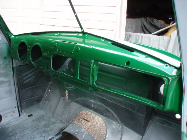

    Finally a good update. There is Green paint on the firewall and the insides!!!!!!! P8100001.JPG P8100003.JPG
    Looks really great in the sun- 69 camero green! I made the tape line where it will be under the cowl seal, so hopefully will look ok.
    Now to let it dry real good and ger the cab on the frame and shimed/leveled, tweek the doors again then pull the bed off and paint the rest.

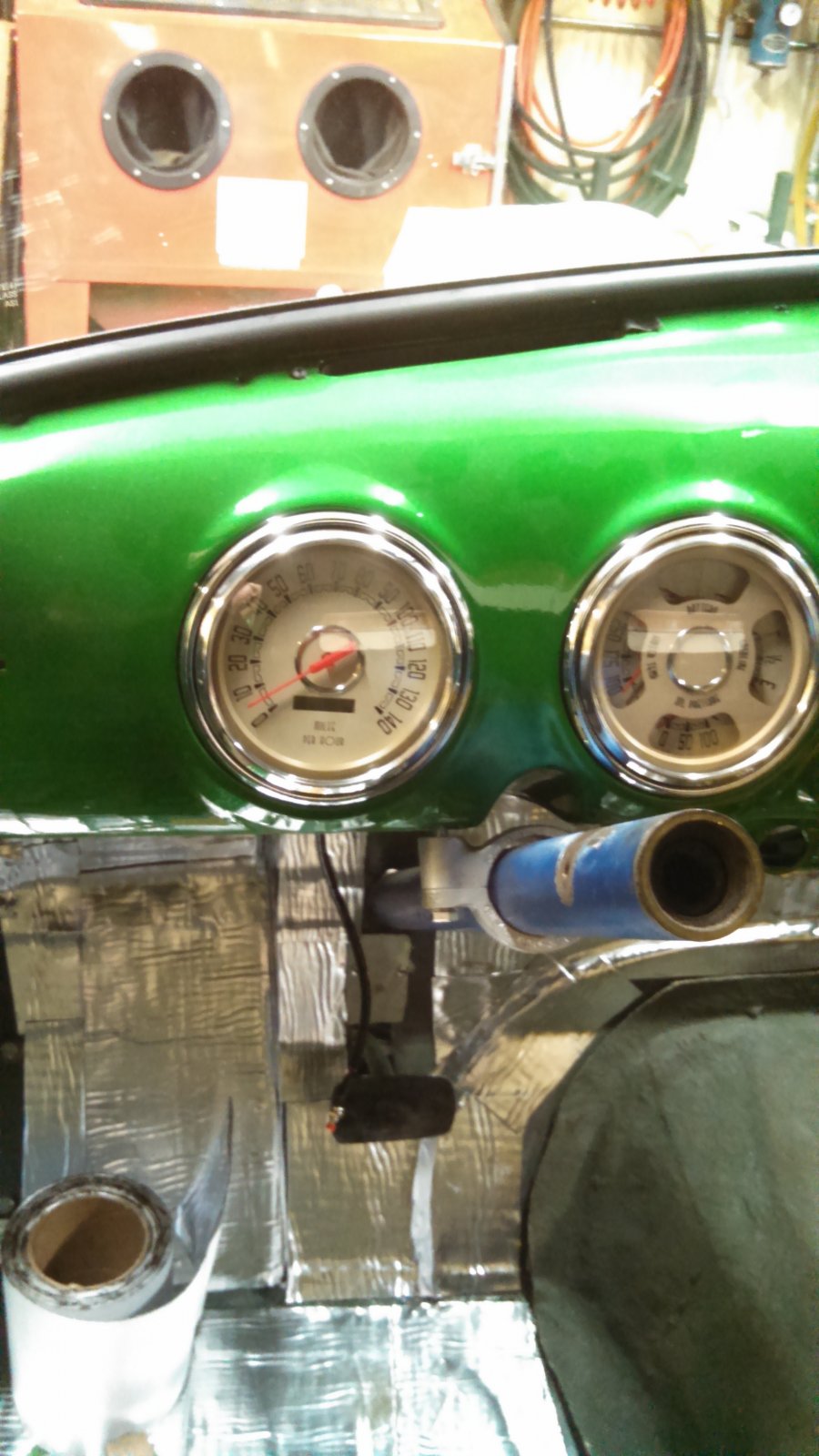

    Test fitting the new gauges- nice. wire harness should be here friday, and I can stsrt getting more done
