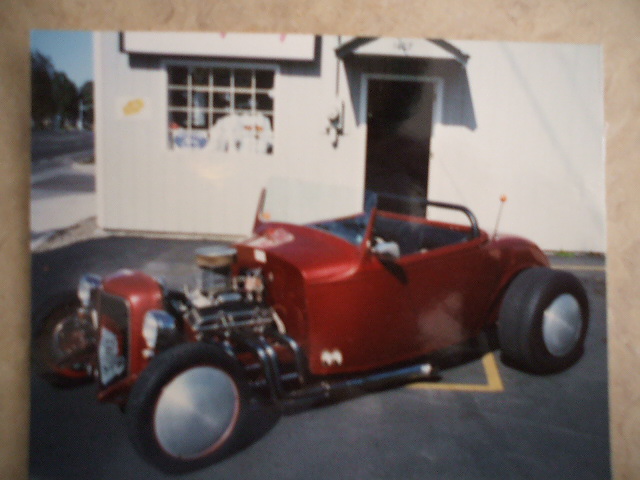

    ..reminds me of the old coupster that my son and I threw together in 30 days back in 1986 to go to Yakima Nats......didn't get'er done:(....we were so burned out we pushed it back in the shed and didn't touch it for a year.....next July, the week before Graffiti Weekend, my son, a buddy, and I thrashed again and we drove that ****er to Roseburg :)...a month and a week.
