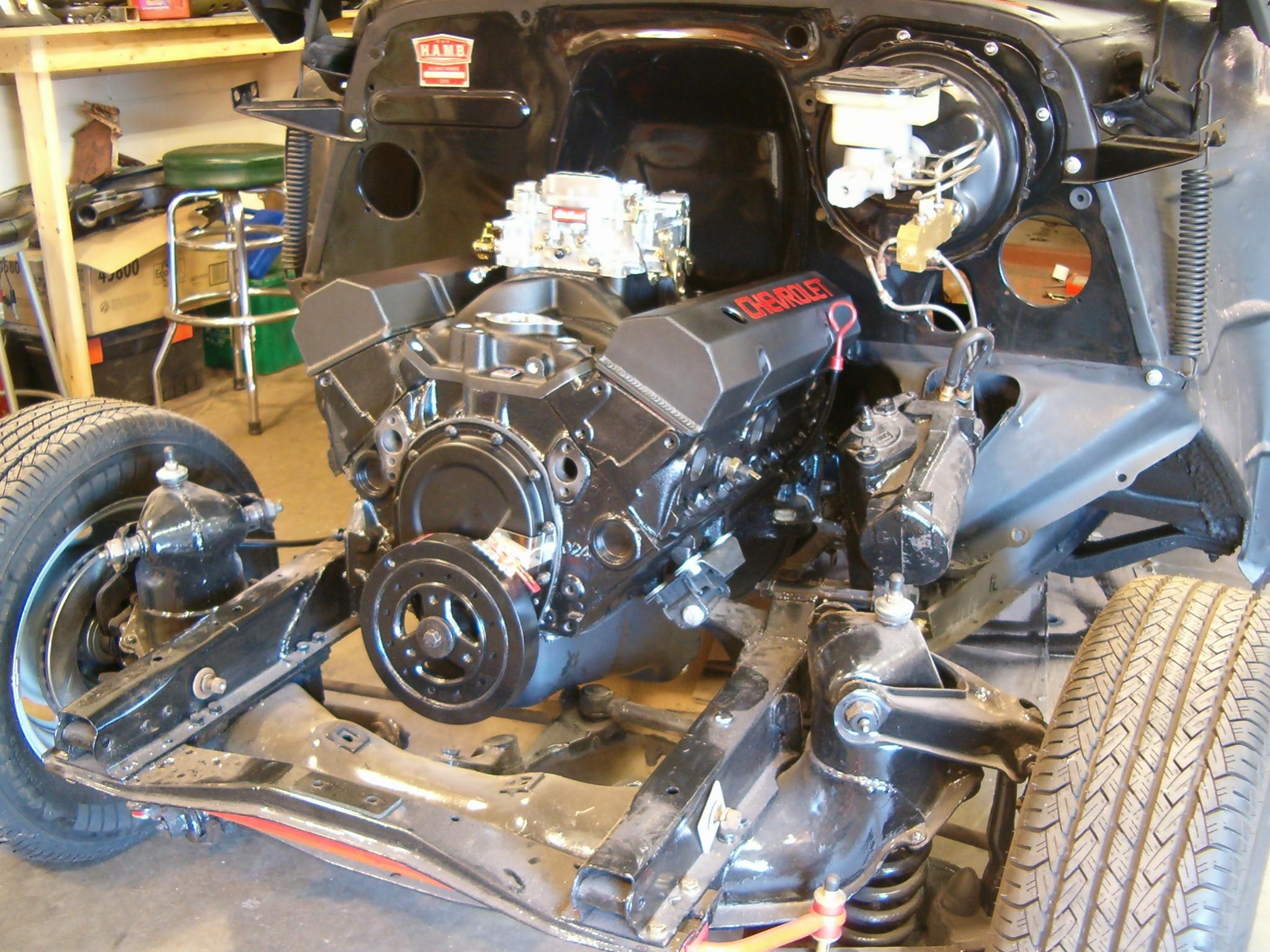

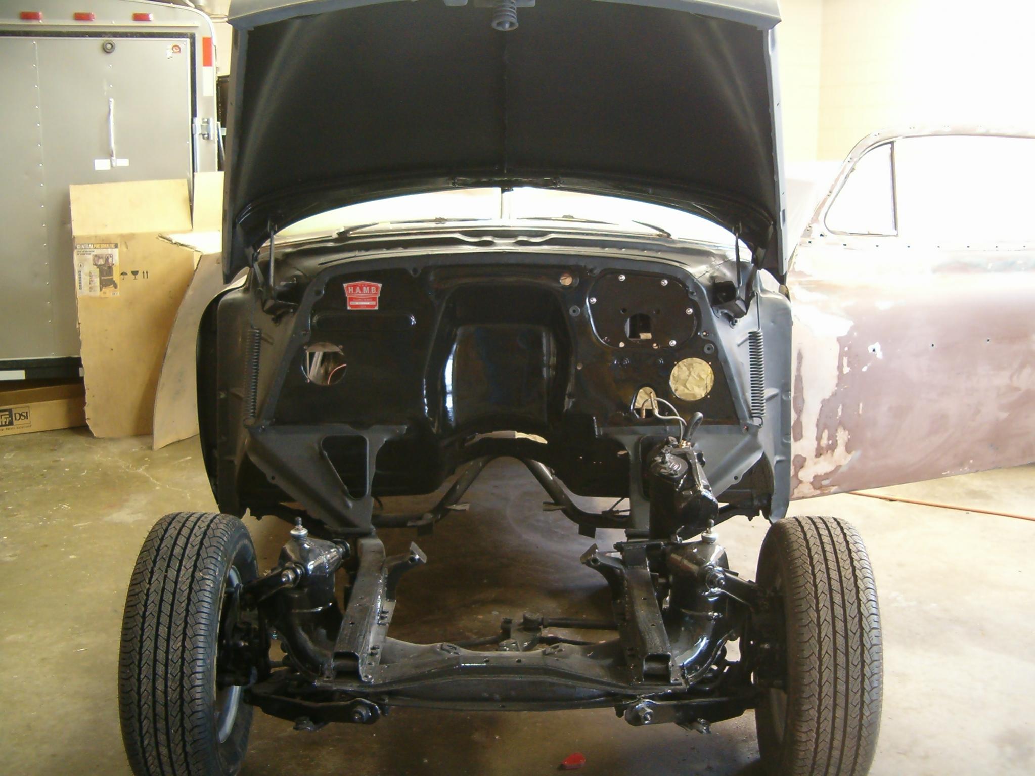

    Haven't checked in on you in a while, you really got a lot done. Looks awesome! Here are a few update pictures of mine.

    50 Fastback, Good to see your making progress too. Is that color on the dash and steering wheel any clue to your thoughts on an exterior color?

    johnwd98, the interior is going to be all red, exterior will be matte black.

    It looks like the dash and steering wheel are red metalflake.
