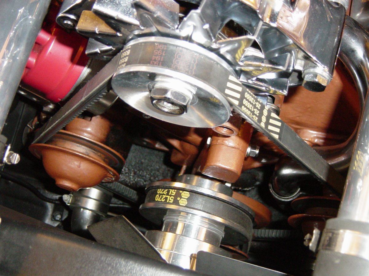

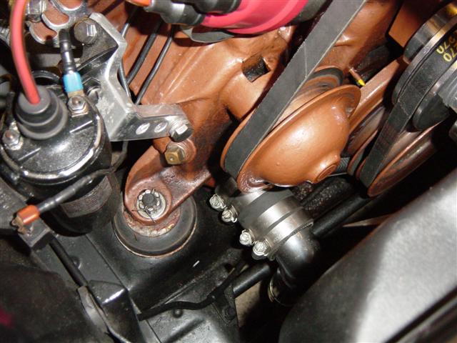

    Flathead Dave:
    Please post photos of your complete crank pulley, fan pulley
    and water pump pulley set up. Fan is 6 blade stainless 17 in dia. from Super shops in 1999.
    Here's a photo of an 8BA with 8RT wide belt water pumps, 2 sheave wide belt 50 Merc crank pulley and wide belt fan pulley similar to 50 Ford pick up trucks.. except that the fan pulley is home made.
    Alternator has wide belt pulley and is driven off the water pump belt. Fan is driven off the crank pulley.
    Big AL Neenyo likes this.
