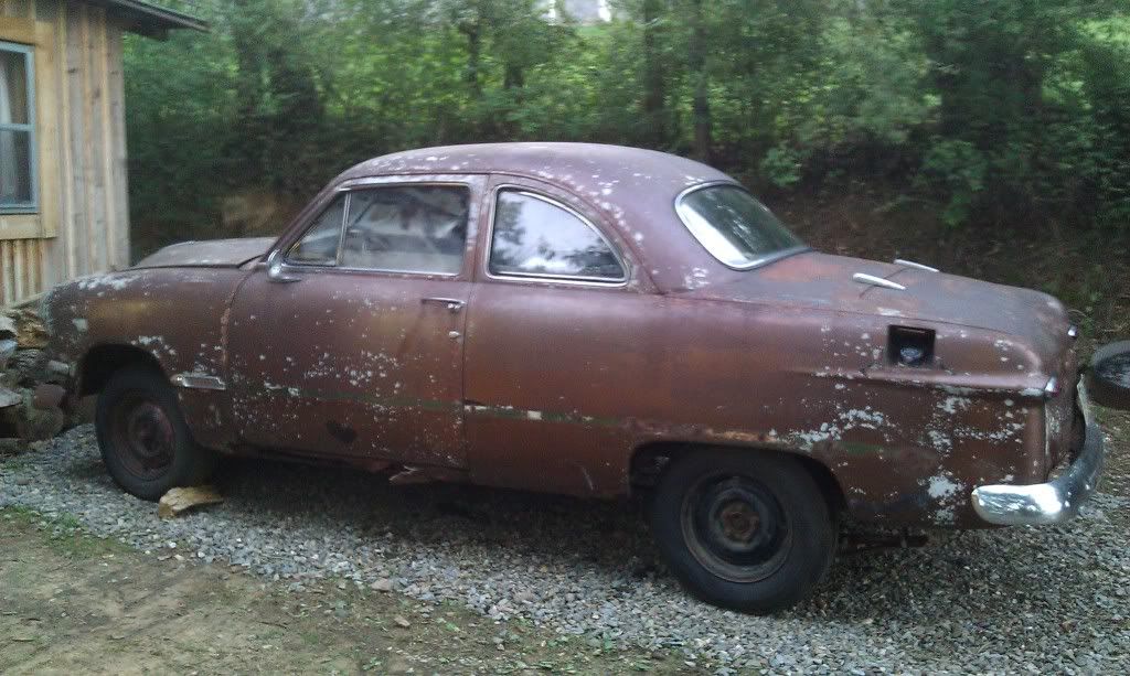

    This is my 50 ford coupe I bought in june of this year. I'm kind of living a dream right now this has been my dream car since being a kid and watching thunder road and my dads first car was a 51 hardtop in the 70s so I've got a good wealth of knowledge to help me along the way. Plan is to get the motor back going and getting a weekenddriver while I collect parts.
    Caught a pic of it with the 50 model 8n tractor that's been in the family and has worked wonders clearing brush and workin around the house

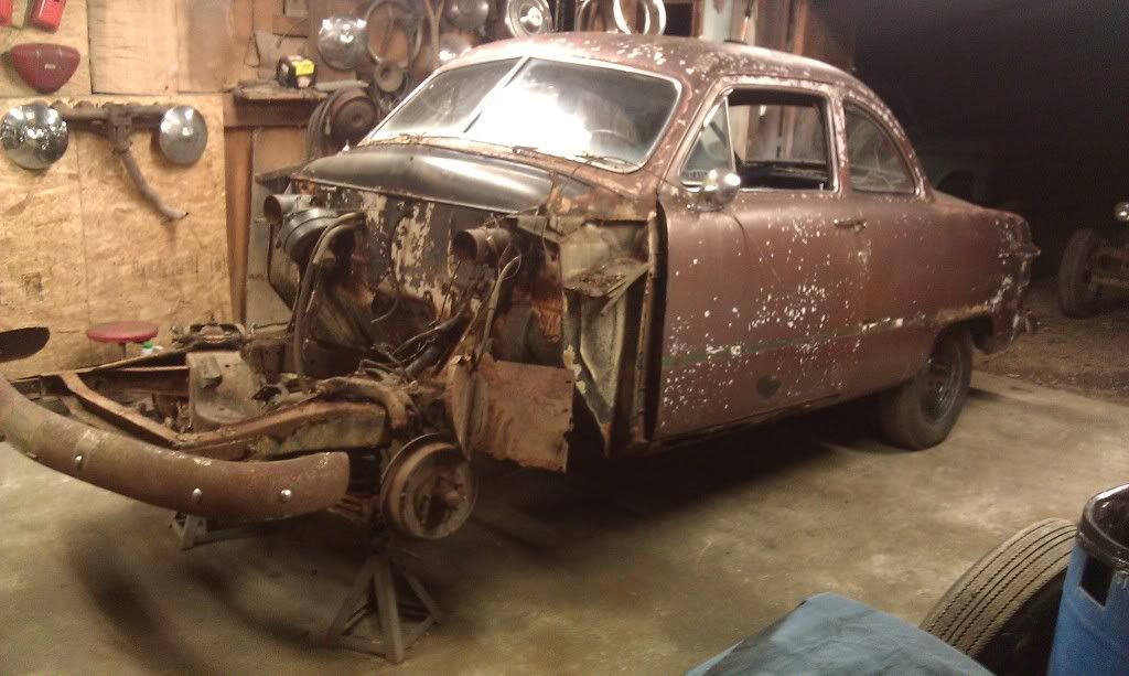

    Started dis***embly while the block is at the machine shop

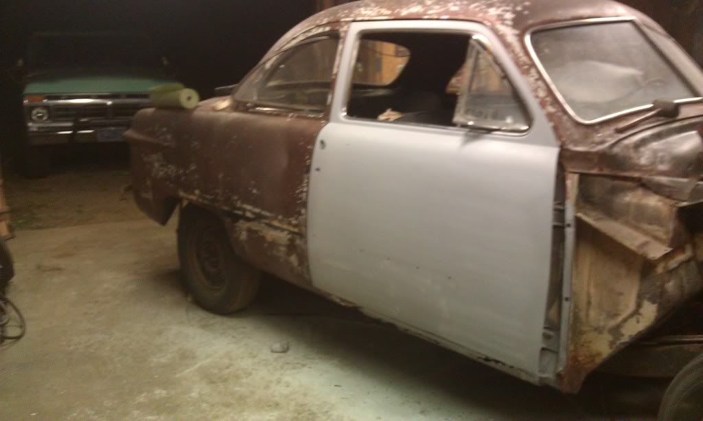

    Got some more dis***embly done this week. Got thep***enger door lined up and finished shaping and welding in the lower front door patch still waiting on the rockers to show up. I'm experiencing the horror stories ive heard on here about the factory undercoating removal. I cleaned up the trunk and dropped the tank tonight its not as bad as I thought after removing the tar and factory trunk mat.

    Thanks for the advice this is as far as dis***embly is gonna go my next step is to start stripping the car to bare metal and get it in primer I've already got the door done found 7 different layers and colors of paint on it. The interior cleaned up pretty good I'm gonna leave it alone for now just replace the headliner and restore the steering wheel and dash. Plan for now is to get everything shutting latching and in primer while I'm waiting to get the block back from the shop and savin money for the rings and bearings

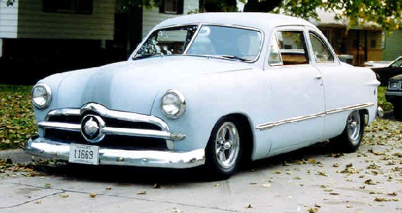

    And here's my inspiration goin for a hotrod look opposed to a kustom would really like some more info on this car

    Here was my 50 Coupe when I got it. It was set up more as a Hot Rod style. It had a nice rake and hood pins. It has the aerostar front springs and fatman drop spindels. Thaught you might want some more pics to look at.
    Your car is coming along great. Keep it up.
    Now
  14. chopd top
    Joined: Jun 25, 2008
    Posts: 475
    chopd top
    from Florida
    I agree, the hotrod stance suits this body style well and I prefer it over the kustom look too. Good luck, I'll be watching this one.

    Thanks big a does anyone have any experience with the axis direct to metal primer that's what I used on the door I was just wandering how it will hold up I just bought a quart kit so the door will have some protection I'm takin the car down to metal all over I'm on a tight budget but I also dnt want to skimp my local paint store recommended transtar its supposed to be a higher build and he said better quality for over bare metal.
