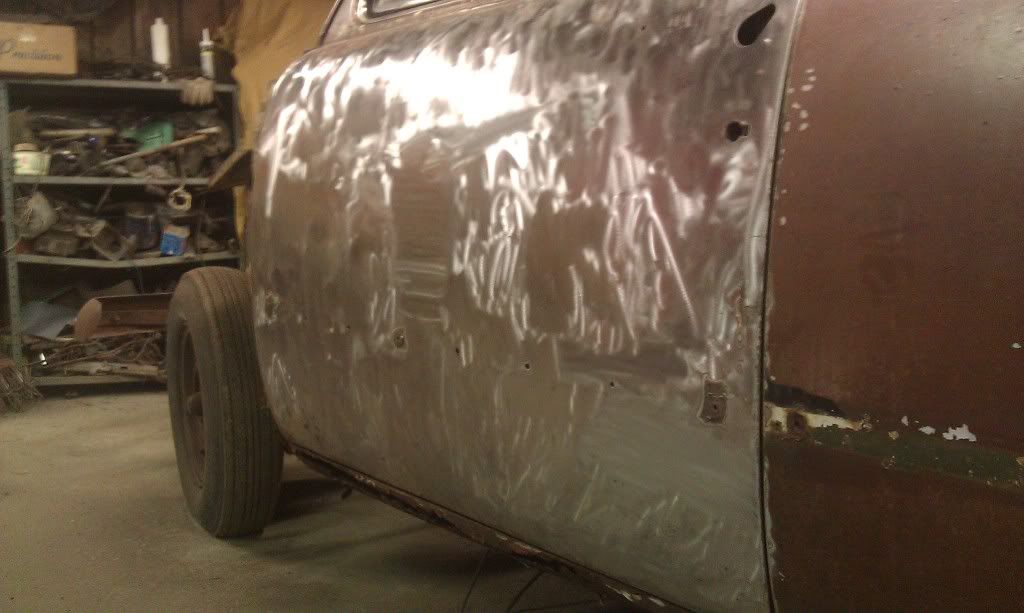

    Since I'm waiting on rockers thought I would get a start on the drivers side. Was a big relief to actually take a panel down to bare metal that doesent require patches its looking like ill get by with just rockers and lower front quarter patches on drivers side. Here's a few pics.
    My son got in on some of the action too
    Also got the lower front quarter patches in p***enger side not perfect but I'm getting a lot better at **** welding panels

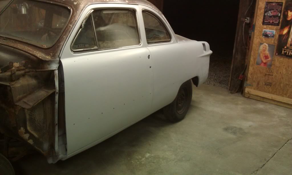

    Finally got some real progress got the rocker in and finished the lower quarter patches. I picked up some dtm high build primer and shot the quarter and rocker. Now since all the metal repairs are done on p***enger I can move to driver side.

    Got the driver side rust repair done the hard part is over. All I have left is the roof and the tail pan very little rust repair left on those so I think ill make my deadline of having it in primer so the engine rebuild can start this winter

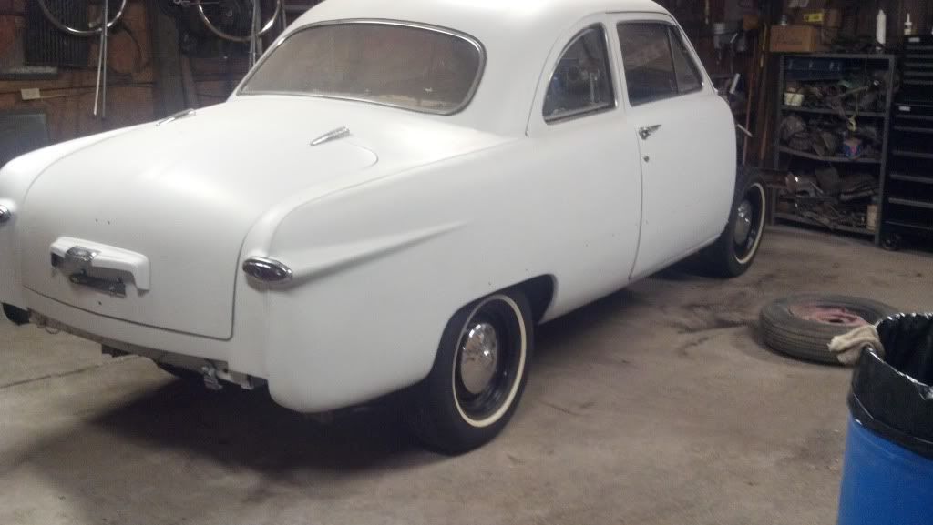

    I havent done an update in a while but have made some good progress all rust repair is done and everything in primer. I couldnt resist sticking the wheels on and putting on the trim on. My next step is going thru the brakes and starting ***embly of the engine.

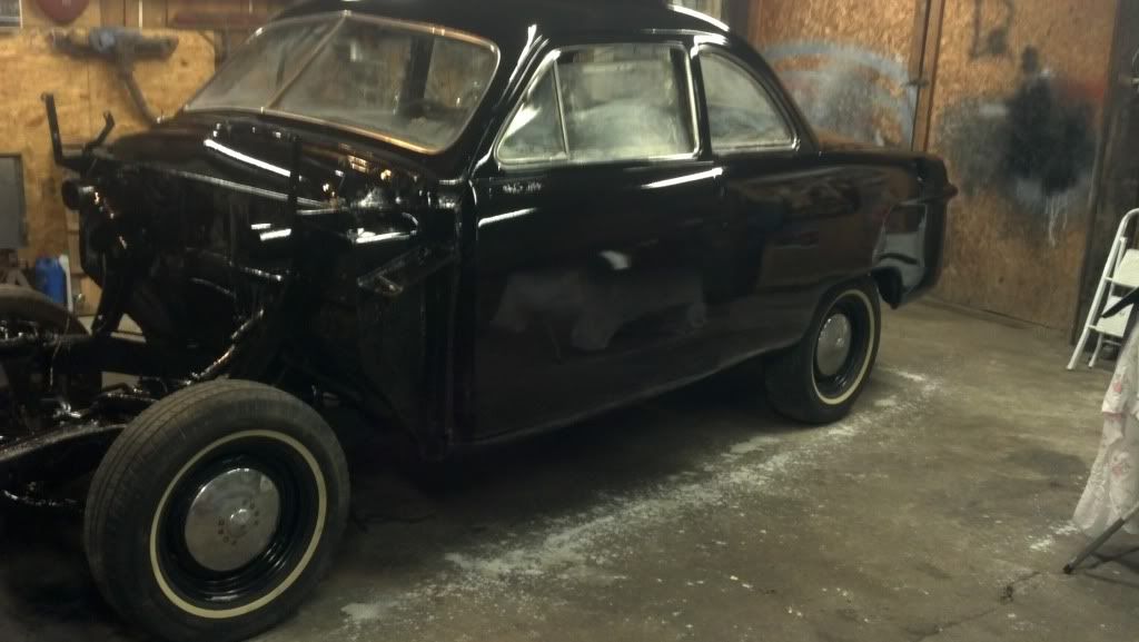

    Havent updated in a while but have made progress. Been block sanding and getting ready for paint . Im pretty happy with the results especially for a garage paint job a few sags Ihave to smooth out but im satisfied.
