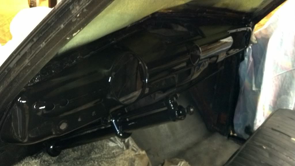

    Thanks for the comments had a warm day finally and got the dash and garnish moldings ready for paint also repaired the pivot on the driver rear flip out window. Hopefully have some pics of the dash and trim painted tomorrow if the weather holds out. Does anyone know the paint code or name for the stock steering wheel color and will regular basecoat clear hold up

    Painted all the interior

    Oooh , super shiney ! Looks darn good . My dash was also black when I got it :
    It's a bit different now - tastey gold metalflake :

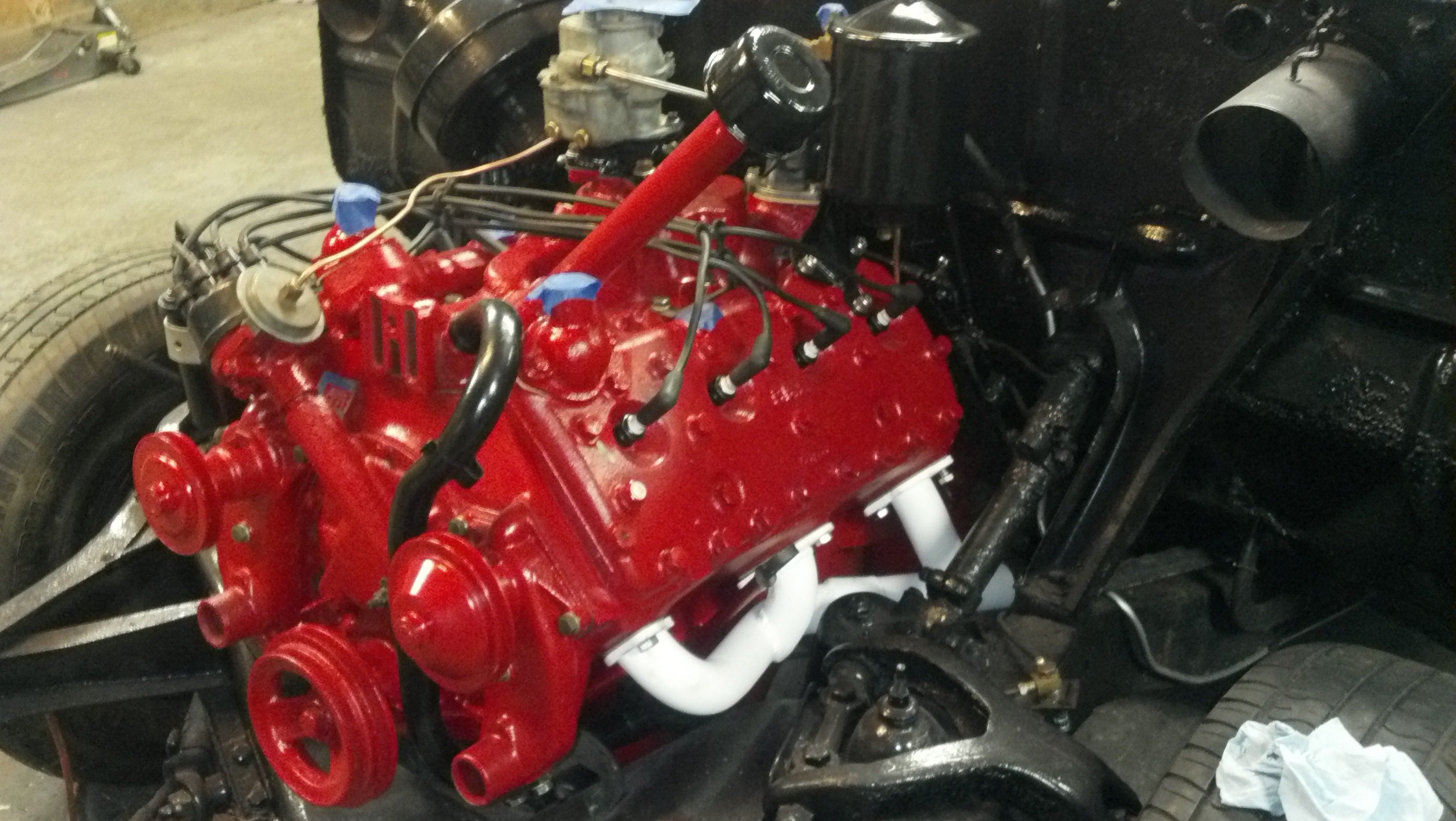

    Been doin side work to fund my projects but i have started engine assembly new rod,main,cam bearings,and new rings. Got the heads at local machine shop getting heads tanked and shaved. Waiting on my dennis carpenter water pumps, new clutch and pressure plate then will be ready to install engine. Also have installed all new brake lines and hoses along with new brake shoes and turned drums. Got a pic of engine assembly still indecided on whether to paint engine ford bronze or just red.

    Engine done waiting on water pumps and clutch kit to b able to sit it in and finished restoring my steering wheel

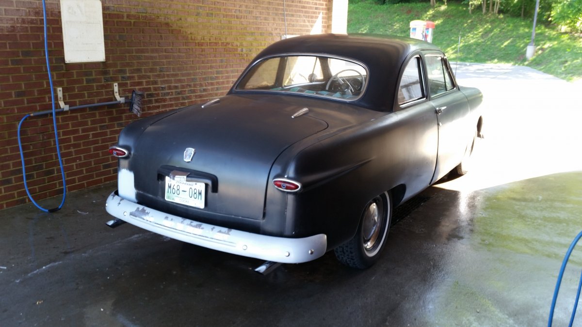

    Got the front sheet metal assembled and everything wired except lights. Now i just got to find me a descent set of driver quality bumpers

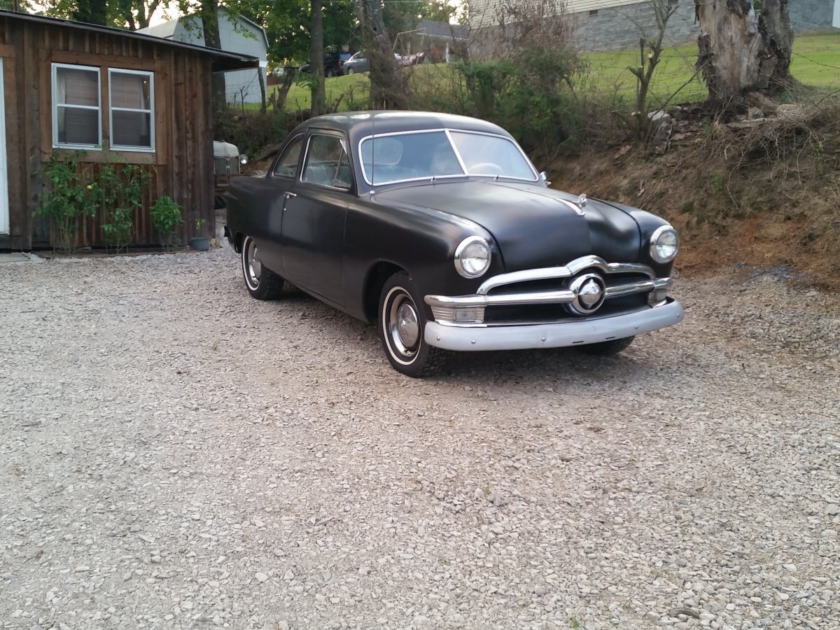

    Hadn't been on here in a while managed to work some kinks out and take a few test drive still alot of odds and ends to a dress but u can't beat that first drive it's by no means a show car but I couldn't be happier

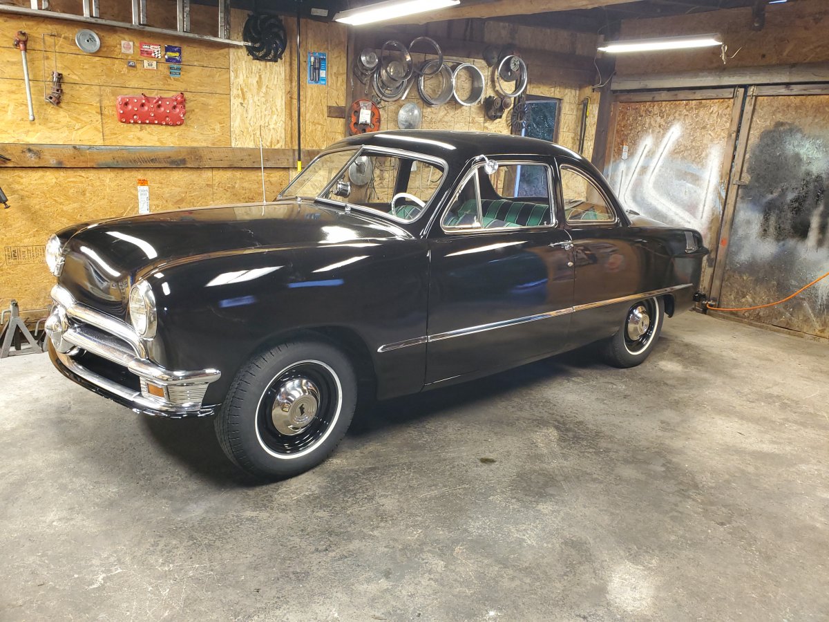

    Its been a few years since I've posted updates. After getting the parts car I decided to tear it back apart and use the best of both cars. Paint is done and all new glass and weatherstriping. Bumpers are back from being replated will get pics when installed.

    '51 Caps. I see a little Robert Mitchum there.:)
    Me Likey.
