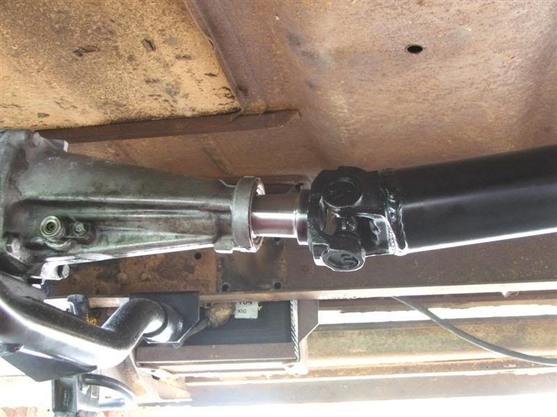

    today, got the pinion angle dialed in and mocked up the drive shaft i had made for my dimensions. also got the front motor mounts cut, fitted and welded on (most of the way, gotta take out the motor to get to some other spots) and the trans cross member is secured (also need to remove to finish welding). readjusted the rear axle shock brackets and started those welds too. took apart the complete rear suspension. figured out the "column saver", cut my stock column and found out i got the wrong kit, so CPP is sending me the right one and im returning this one, at least its figured out and being worked out. wire wheeled the rear half of the chassis and coated it with some POR-15. that stuffs the best!
    i have also lined up a bunch of parts in the meantime and now i only need to order the radiator and shorty headers tomorrow. i think ill be just about done ordering stuff, most everything else will be local purchases.

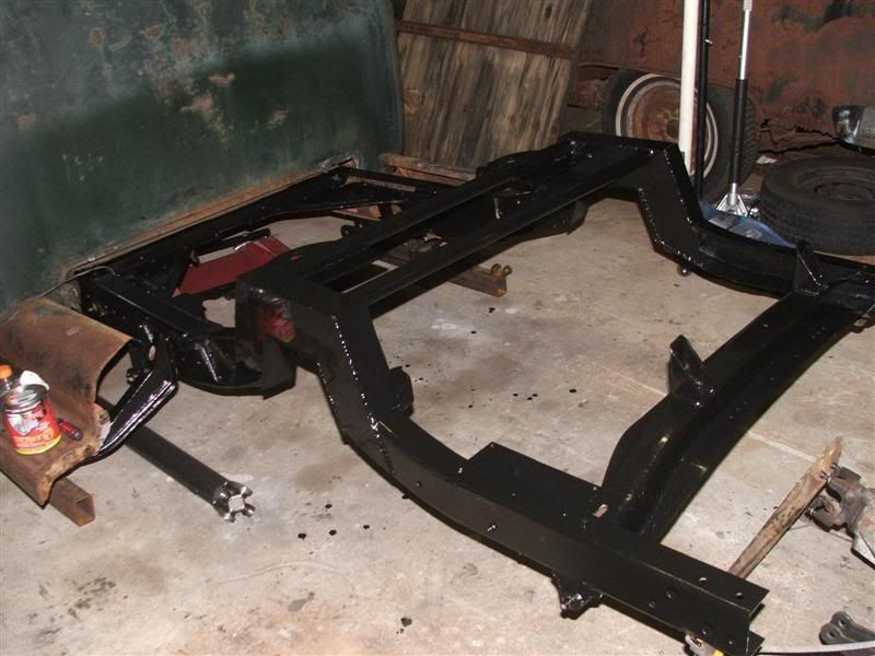

    what did i get done today? painting, lots and lots of painting.
    painted the rotors front and rear as well as all the front end suspension components, spindles, shocks...:
    finished painting the chassis:
    installed the bags & shocks on the rear and put the bed back on the truck:

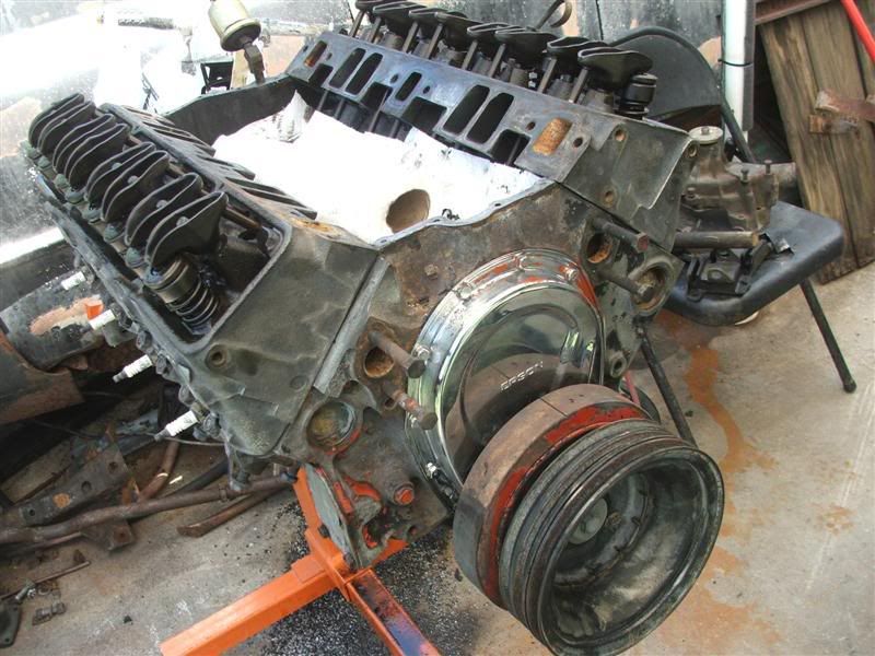

    then i worked on tearing down the motor a bit more:
    painted it with the silver por-15:
    then 53+ Buick green:
    cleaned up the main pulley and also painted the water pump and pulley to match, i really really like the green it matches the pinstripe that is on the cab at the belt line, now i cant wait to put the new manifold, valve covers and block hugger ceramic coated headers:
