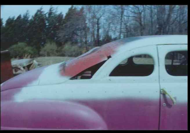

    I blew it up for better viewing...From the side,the bottom of the window looks worse! If you cut the bottom loose and lower it a little it will solve both issues. Top and bottom.

    Looks like your dealing with two challenges here. The top of the gl*** is too low and the bottom of the gl*** is two high. Looks like there a lump in the roof line. While the cars outside get some good side shots about 20' back from the car, so you can get a good visual of whats going on. Then take the pictures 8 X 11 and rework them to get the right line for the roof. This will give you an idea of what you've got to do to the car.
    This is what happens when you can't stand back and see how things look. In the garage it will look great!!
    The Old Tinbasher

    I know this is a different car, but the principles are the same! And besides, no one has offered pics of "real" cars being fixed, so this guy can ***ess the amount and type of work ahead of him before he attempts to do this.
    These are from the thread I mentioned back in the beginning of this thread.
    The 48 Merc here was bought by by great friend Vic Collins, as an unfinished project that was actually being done by my old mentor. Unfortunately, in his declining years, he suffered from senility/Alzheimers, or some other condition. His workmanship, after he lost his shop, was bad, to say the least.
    Anyway, we set out to undo some of the work that was done and finish up this car.
    You can see the rear window angle is wrong, and the work is pretty poor.
