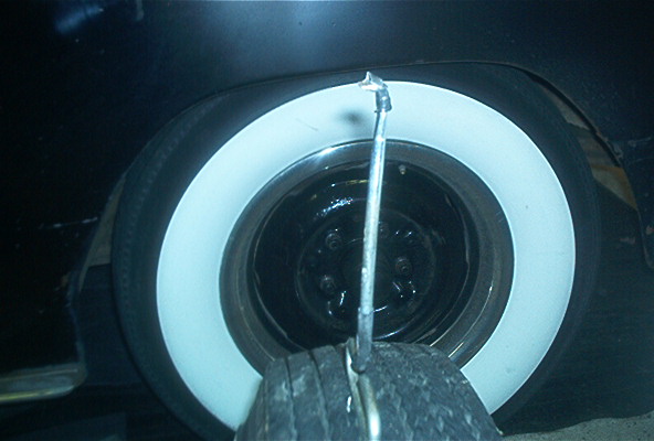

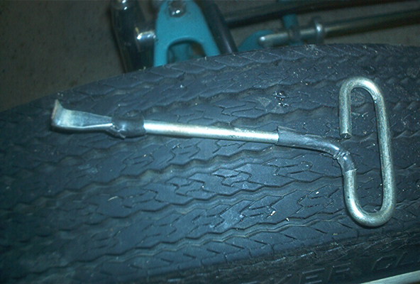

    I made a tool with a curved end to pop the hub-cap off
  5. spoons
    Joined: Jan 1, 2004
    Posts: 1,738
    spoons
    from ohio
    Here's the pics....
    I use it for 49, 50 51 Ford and 50' merc caps...
