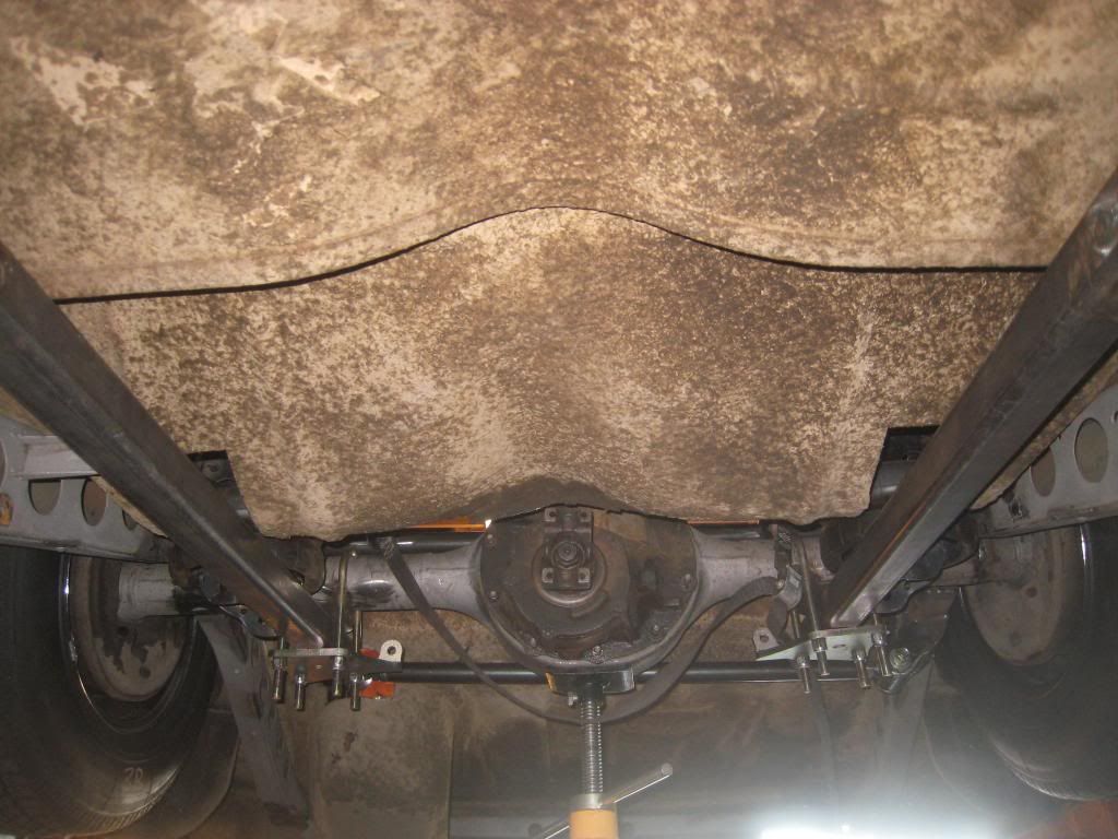

    got the housing cleaned up alittle, it looked like the axle pads had been moved a few times in the past on this housing,so there was some gouges to fill, fully welded on the axle pads, and got it narrowed.
    pinion is now centered in car,instead of the stock 4"offset.
    new moser axles.
    also got the new "tanks" gas tank installed. fab'd up a front hanger, basically mounted it like the stock one, but it now goes up to the new x member, and had to clear the pan hard bar. had to also clearence the rear frame alittle, the new tank has reinforcement plates at the mounting points that where not allowing it to align up properly.

    Im digging the frame. Did you pin the trailingbarms to the axle pads? I assume using the 2 link will eliminate the need for excessive floor pan cutting required in using a 4 link?

    yes the rear arms will get locating pins, just like a leave spring. i will do that next time the body is off and i can get a better shot at double checking the wheel base.
    yes this link set up does not require a lot of floor to be cut out, only made 2 cuts for the arms to clear the floor.

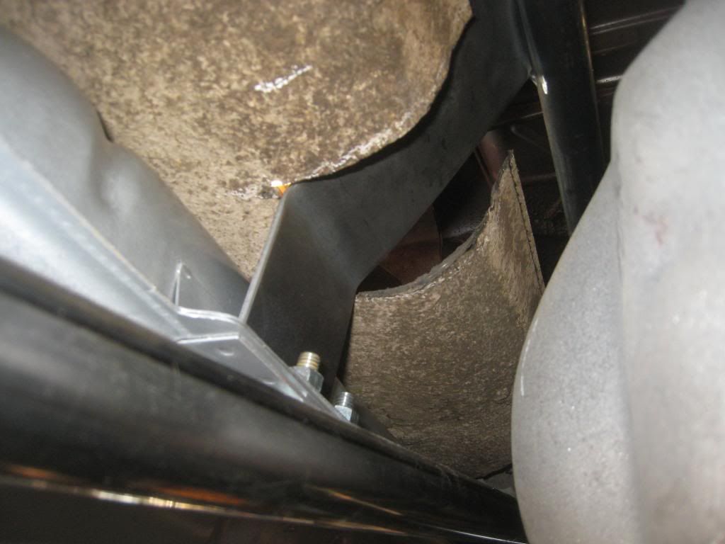

    the car is set up for a sbc and turbo 350. as mentioned i custom made all the amounts. with the frame completely laying flat on the ground i had to raise up the engine and transmission. the stock transmission cover bolts to the floor, with coarse sheet metal screws and 10 gallons of undercoating!
    the idea was to make the stock one fit like factory , but work for our new drive line.
    the cover will now bolt in with nut serts and some kind of cool fastener.
    it will be body worked,painted, and pinstriped to match the body.
