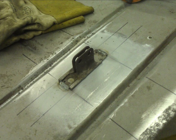

    It's been a little while since I've got a chance to do anything on the merc, life gets in the way sometimes. So here's the rest of the rust repair. The floor goes back in it next week. ImageUploadedByH.A.M.B.1395025649.016888.jpg ImageUploadedByH.A.M.B.1395025679.423184.jpg ImageUploadedByH.A.M.B.1395025720.561677.jpg ImageUploadedByH.A.M.B.1395025736.178831.jpg ImageUploadedByH.A.M.B.1395025761.673928.jpg

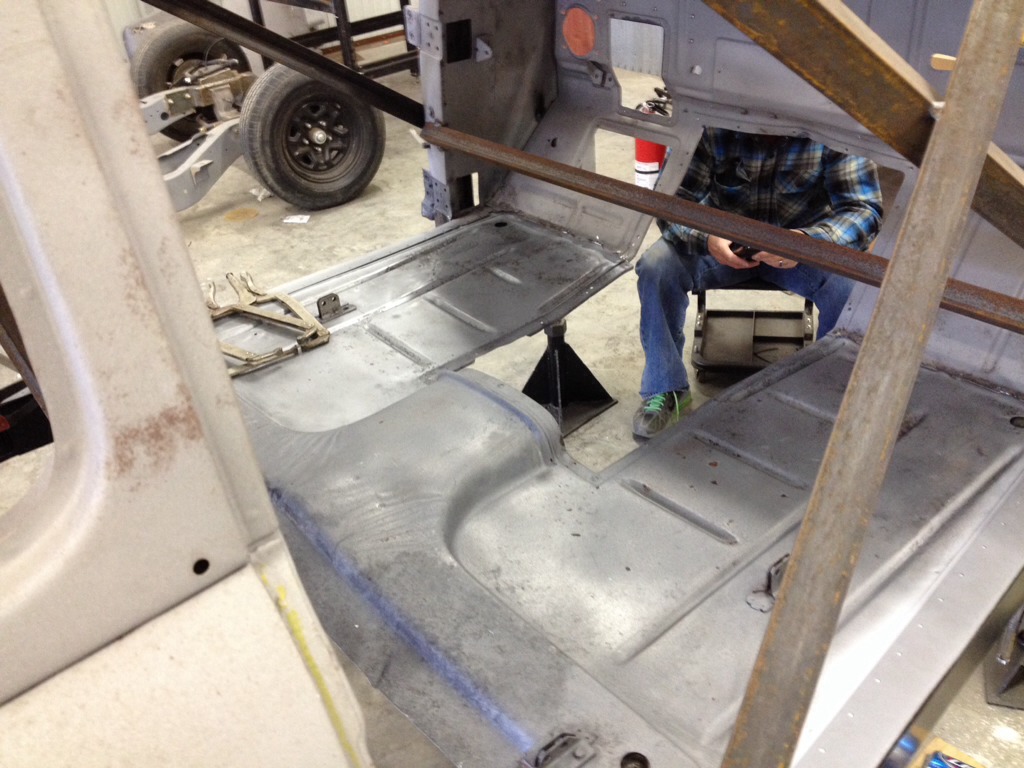

    Got the floor back in it,we'll the front half. The new body mounts should be in next week, so we can put the body back on the frame. ImageUploadedByH.A.M.B.1395796919.768982.jpg
