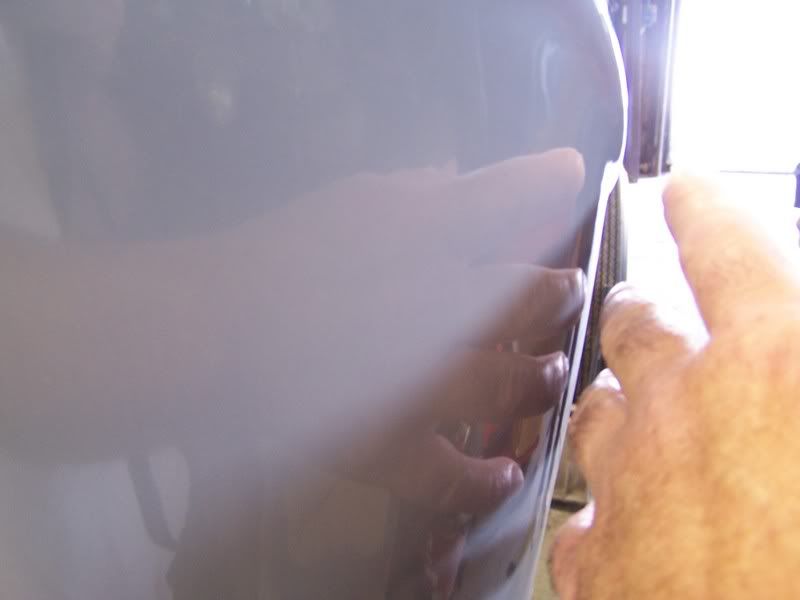

    the whole idea behind the roller is that you get about 98% of the paint you buy on the car... a spray gun maybe 50%...
    I apply surfacer with a roller sometimes, depending on what I have in the shop/ time/ etc... you dont have to mask off everything-
    you would be suprised...
    I really used the roller and brush method when I was making prototypes in college- we didnt have access to a place to clean out the guns etc afterwords-
    Rollers RULE.

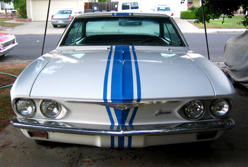

    The $50 paint thing is all over the net. I posted these comments on another board, too.
    My .02 is that if you can spray Rustoleum, you can spray base coat/clear coat. The paint is nicer and there are some inexpensive kits out there that do a decent job and have all the materials you need. Rustoleum has its place and I use it a lot, but this looks like the hard way to paint a car.
    I'm painting my roadster now in my own garage/driveway with a paint kit I bought on evil-bay. Typical cost for a cheap urethane bc/cc kit is about $200. Ok, it's not top of the line auto paint and you won't win any Ridler's, but the result is not bad, there are more colors available, and unlike Rustoleum, you can get a variety of metallics.
    And you could actually get a car completely painted in one day, not six or seven. 2k primer is ready to wet sand pretty darn fast. Base coat flashes in 15-20 minutes, so you can lay down several coats in an hour. Speed clear is dry to the touch in half an hour and it'll be ready to buff in a few hours. I let it sit at least overnight before wet sanding, but you could go faster. Basically, it ends up being a weekend job, not an all week job. I'm going to finish painting the nose on my roadster this weekend. I figure it will take about two hours. If I were to do rustoleum, it would take several days.
    You'd don't need a fancy spray gun or a huge compressor. I've been using some pretty cheap HVLP spray guns and getting good results. Even solid colors seem to look a lot deeper with a BC/CC paint.
    It is not hard and even I look like a decent painter, even with my limited experience. I've sprayed stuff in the driveway and it looks good. Not a lot of blowing dust here, but I have to buff out a bug now and then. I wish I had a spray booth, but it's really looking pretty good. You DEFINITELY need a respirator to keep from inhaling fumes.
    You have to spend an awful lot of time sanding and buffing Rustoleum. I think base/clear coat is actually less work in the end. The bottom line is, no matter what paint you use, it will only look as good as the prep work beneath it. If you are going to do good prep, why not spend an extra few bucks for real paint?
    Now, for those of you without a compressor, this Rustoleum thing is a pretty workable technique, it seems, but it sure looks time consuming.

    This is a nice concept...... but with paint that thin it will show even the slightest of flaws that most paint would cover....... so lots of body work and primer/blocking then painting it with 10 coats then buffing is the real key to success here......... lots of elbow grease

    i had a 68 camaro done with rust paint, trimclad, which i think is the canadian version, it was sprayed on and you couldn't tell it from any other solid color non metalic paint job, i just sprayed the metal doors on my house last week and they turned out just fine for doors, i`m no painter but i think if you did a good job on the body work almost any paint is going to look good. my paint gun was an hvlp that came in a set of 2 large guns and a small one for $75.

    I did the easiest thing I could find... a patio table. It worked fine. Took a bunch of coats. Sanded out real nice and buffed to a decent sheen. If I took my time with it, there might not have been any scratches in it.
    Its been out on the deck since last spring and it is still glossy as ever when wiped down. Its definitly tough as nail.

    I agree, if you're gonna roll all that piant on your car and spend three days sanding out the bumps might as well just spray the car and spend that time sanding out the drips. You'll be happier you did.
