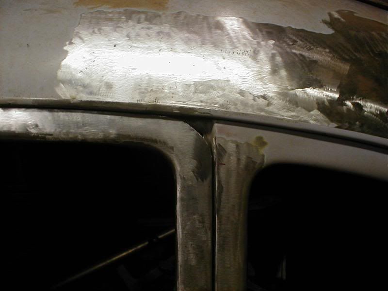

    heres another update
    b pillar is done and window top is on finally looks like something now
    i didnt like the way the pillar went into the roof so i cut another relief cut. plus the reason there are 2 cuts on the pillars is because i was gonna hard top this car but changed my mind at the last minute
    the other side
    the way the pillar runs to the roof now.. much better then before in my opinion
    b pillar done

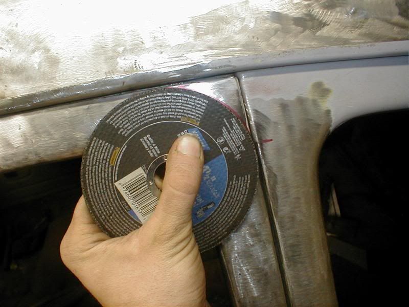

    then i made some more work where did the corner go !!??
    heres how i got the nice radius
    4 and a half inch cut off wheel
    heres how i made the piece for the corner
    tack welded a piece of sheet metal over the edge and drew the curve from the back!

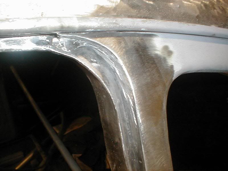

    heres the corner after i put the piece inside to block it off so it looks factory. there was to much lead to weld the top up most likly gonna seam seal then but some plastic over it
    for the most part it is done still gotta weld the door corner up
    just one of those little things that adds alot to a car but is not noticable.

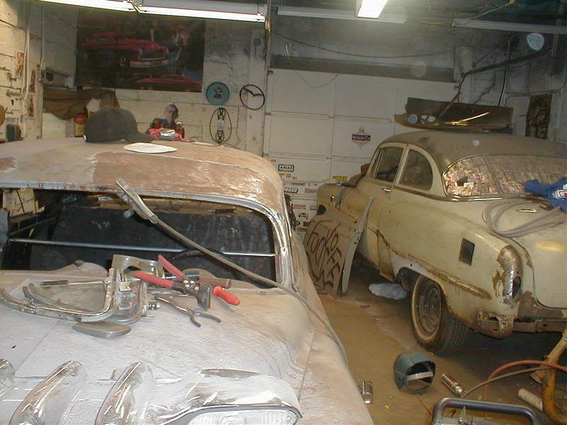

    thanks a lot guys more progress today gonna finish the front pillar i hope.
    ace, i dont know where we are goin yet. commercial property is so expensive. we got that little garage which is a big 4 bay and a 3000 square foot lot for 400 a month .
