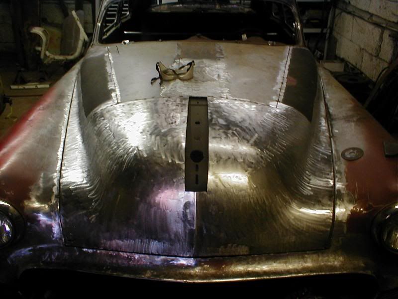

    well i forgot all about the corners and wanted to get the outer "frame" done. well that also turned into another project of me not liking the body line going down the center of the hood. what else is new.so to the 53 parts caddillac i went .... the 49 was to lets say broad i wanted a more crisp and subtle line so i went with the body line off the side of the fender
    plus the orig. body line in the 49 was as crooked as a dogs leg.
    finished welding it up
    probably way to particular about stupid body lines but what are ya gonna do

    Nice work! round those corners! heres a quick photoshop

    thanks for the photo shop they are def gonna get rounded.
    and for the buick i think its in the hood which makes em look the same . haha and i cant complain about the pontiac being compared to it !!!!
    next decision run the body line down the whole hood .. end it somewhere in the front ..or run it into a piece of stainess trim off the 53 caddy... decisions decisions haha!

    I didn't wanna chime in seeing as this is the first time I've gone through this post, but I have to. I say def continue it into the upper lip. Not only does it compliment the peak on each side, but it keeps you from abruptly dropping out a line. Something that I try never to do.
    Overall though, this thing is killer. Lots and lots of work for subtle changes that aid the flow. This car is going to look dynamite and no one will know why.

    the body line runnin down the hood is gonna go into the front lip ever so slightly .
    rounded corners lines were maade with a roll of 3m body tape this time .
