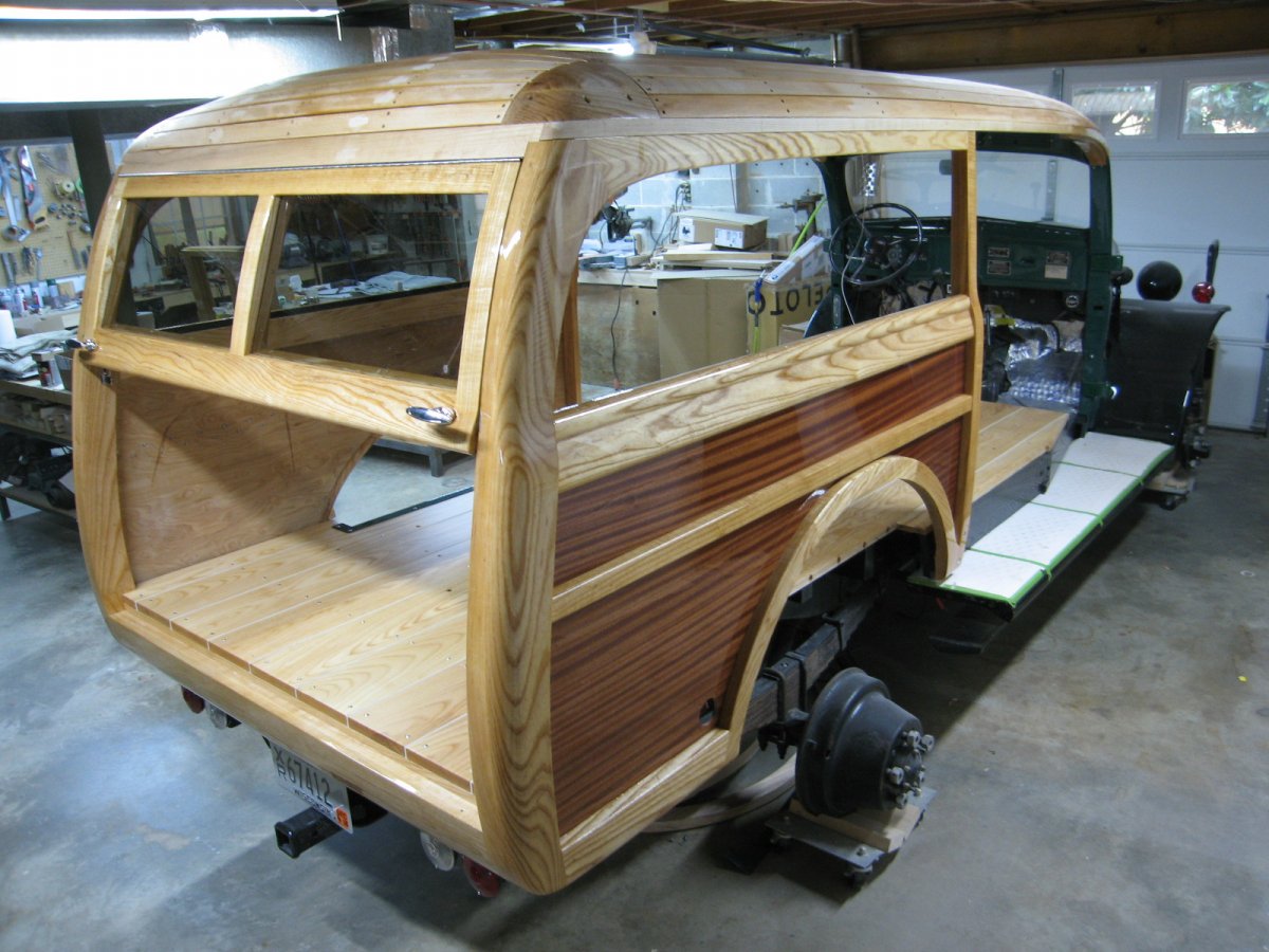

    Tailgate wood work is about done, still have some hardware to sort out. Finishing up some of the interior trim and panels. Getting down to the small stuff. IMG_4447.JPG IMG_4462.JPG IMG_4466.JPG IMG_4460.JPG IMG_4461.JPG

    Awesome craftsmanship. Do you make a template for each piece? I’m interested in the process you’re using for design,layout,tooling and final ***embly.
    You sir have a gift IMO. Thank you for posting this project..

    Thanks. I do make a lot of patterns, but not for every piece. Some pieces are simple enough to make just using measurements, a two dimentional pattern works most of the time, and in extreme cases (like the roof front corners) I make a three dimentional pattern. The design goal for this truck is for it to be recognizable as a Campbell body, even though quite a few changes have been made. It got there in steps, starting with building an exact copy of an original and ending up more like a full custom. I've worked from renderings in the past, but this one is more of a design it on the fly kind of project. Tooling is as simple as I can keep it, no point in building elaborate tooling for one off parts. The ***embly process is dictated by the body, and every one is a little different. In this case, the floor will go on first, followed by the quarters as they hold the roof up, then the roof. After that the doors can go on in any order. Smaller parts are installed as they need to be or whenever convenient. Thanks for watching!

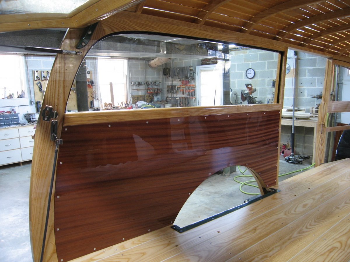

    I still have a couple panels to veneer and some final fitting before it comes apart for finish sanding and varnish. Gonna get cluttered around here. IMG_4508.JPG IMG_4509.JPG IMG_4510.JPG IMG_4511.JPG

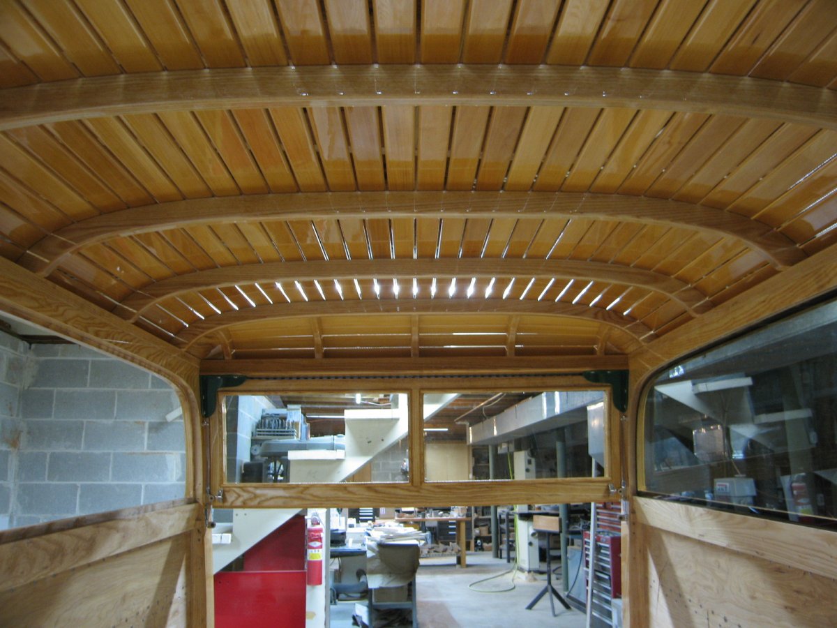

    Sanding, and lots of it.....Worked a few other details in for an occasional break. Installed electric wiper motors, reworked the trans tunnel, installed a new windshield, etc.. But mostly sanding. Not done yet but the end is in sight. Hope to get the floor boards back from the spray booth tomorrow and can finally get to re***embling this thing. Getting the first look at what the colors will be, don't know what the computer will do to them but in person I think they look good. The fabric in the last one is the leather that the seats were done in. IMG_4602.JPG IMG_4603.JPG IMG_4604.JPG IMG_4605.JPG IMG_4609.JPG

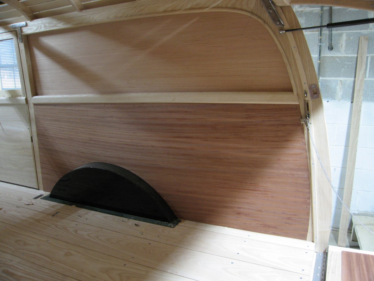

    The heavy sanding is finally done, the last batch of parts might even be out of the spray booth by now. Got a start on the ***embly, pretty good ways to go yet though. IMG_4632.JPG IMG_4633.JPG IMG_4634.JPG IMG_4641.JPG IMG_4643.JPG IMG_4644.JPG IMG_4646.JPG IMG_4661.JPG
