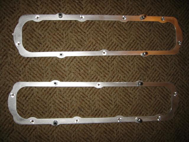

    Anyone have any contact if for Schrader's Speed & Style? I may shoot Don Dillard a PM asking about those adapters for putting the 331 valve covers on the 500. That just looks bad ass.

    Please excuse my lack of knowledge but are the covers you are talking about on the mill above Indashop?
  15. InDaShop
    Joined: Aug 15, 2004
    Posts: 2,796
    InDaShop
    from Houston
    Yeah that drool worthy mill above is Don Dillards for his 57 caddy project. its running 331 valvecovers. 500 Valve covers are ugly and that the huge hotrod problem they look like a polyester suit at a blacktie affair.
    Apparently Schrader's makes an adapter according to Don's buildup, but their website link isn't working, and I don't know anything about them or how to contact them. Google yielded zero.

    The number I have for Mike at Schraders is 1800 660 9607,don't know if it's still good,
    The address I have is:
    1101 West Foothill Blvd #5
    Azusa
    CA 91702
    If you can't get ahold of Mike,Mooneyes lists the adapters aswell.If you get them from mooneyes order them now so you get them before april next year:rolleyes:
