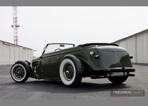

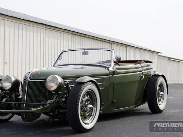

    I used a '68 472 in this, .080 over, Sig Erson cam, polished exhaust runners, stock intake (to fit under the hood). It was a brute. Didn't need to rev over 4500, it was scary fast. Whoever said "...they're not hot rod material..." is wrong. I don't have any photos of the engine, but you can find them on "Hot Rod" magazines website yet from the feature. 7273FF3D-DCCC-4B46-BF3B-72C3BDBCB135_4_5005_c.jpeg F6111CB0-95B1-4AB6-AAB1-62F93EA4FE86_1_105_c.jpeg 05BEC628-9495-4976-BD5F-3567CCA85055_1_105_c.jpeg 71202C66-5FE4-4804-A3AE-D4DF35109F70.jpeg

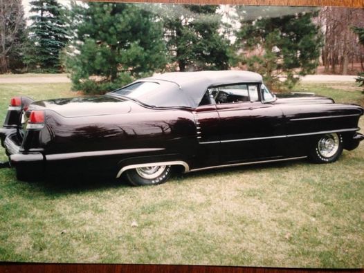

    Got one in my '55 Caddy...a 1970 500", it will run all day long at 85-90 mph on a hot summer (Midwest) day and stay cool, will climb mountains effortlessly and get to 120mph or so in a just few seconds. I've driven the car all over the U.S. for the last 14 years and to Canada twice from Denver,,ColoRODo. The engine is basically stock internally, the only thing it has is headers and a 750 cfm Edelbrock...and the only thing it won't do is p*** too many fuel stations.
    R-
    Photo shot in Moab, Utah...my brother's 54 Cad ahead of mine.
    "Kiki" in a photo shoot for a magazine. Photo by Johnny Covey.
