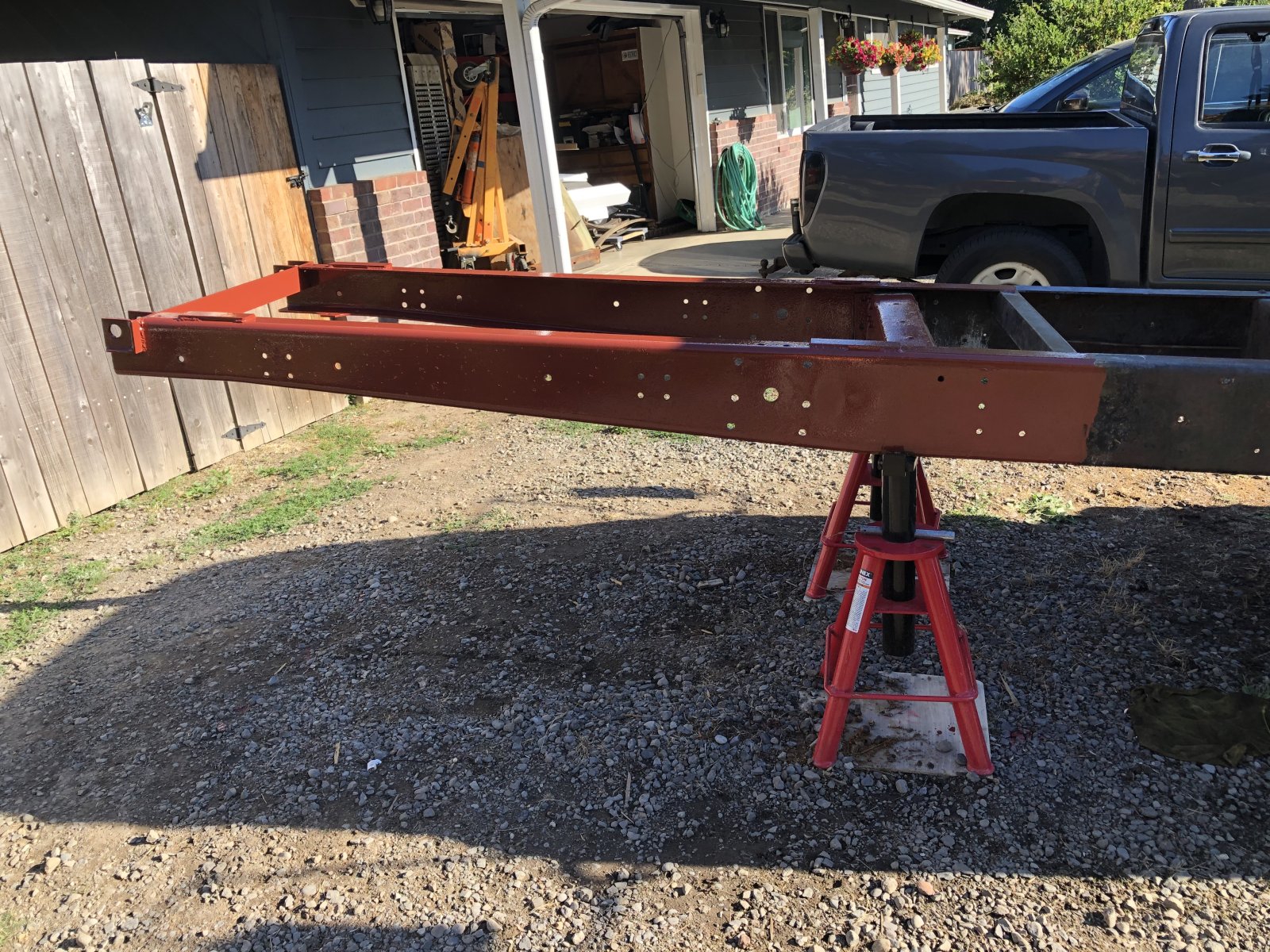

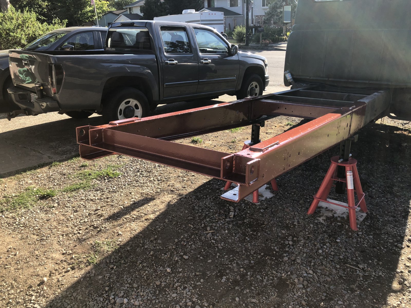

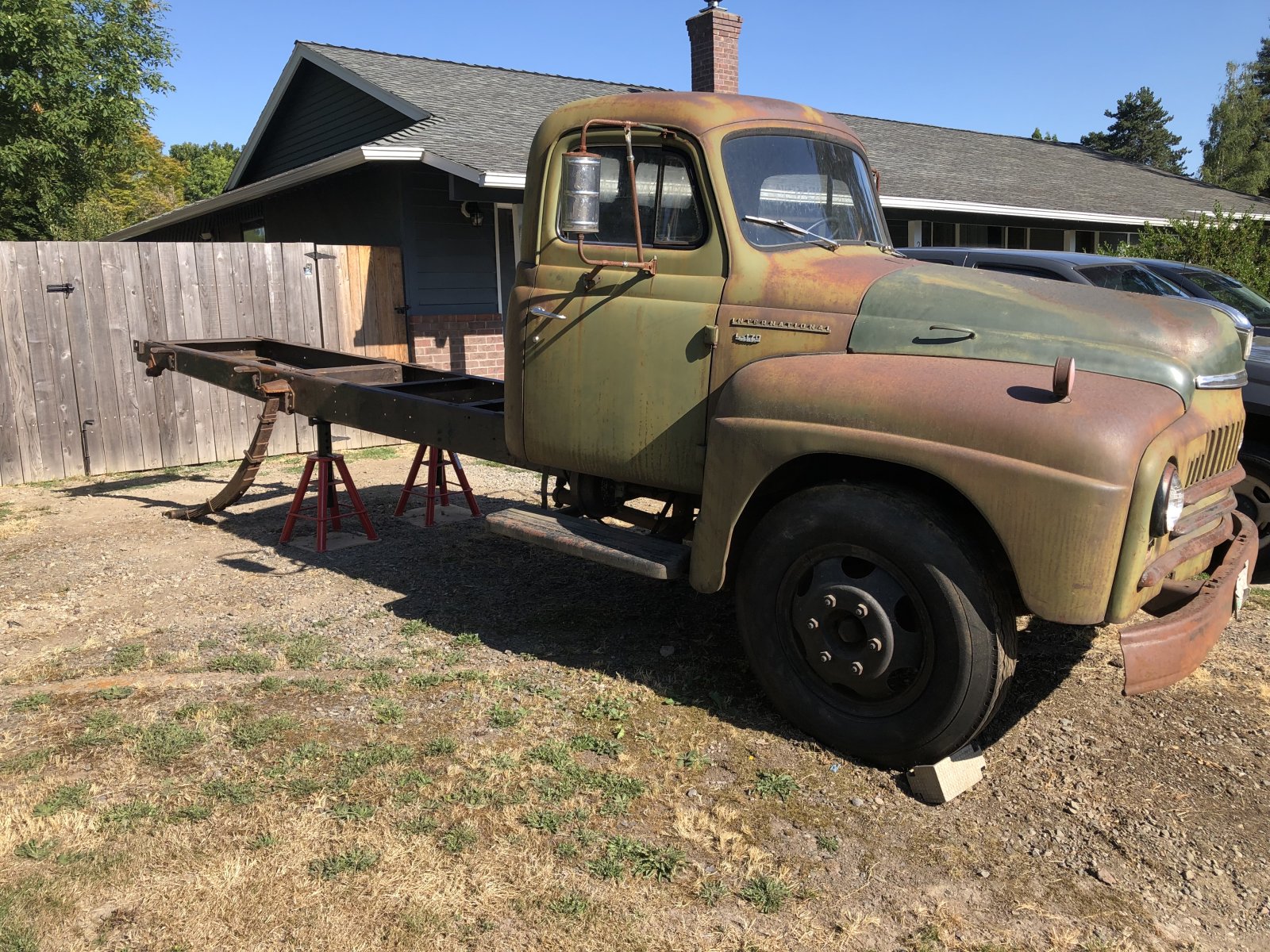

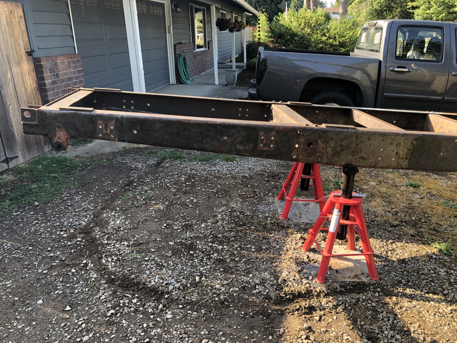

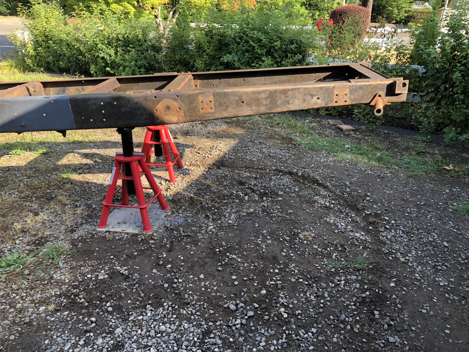

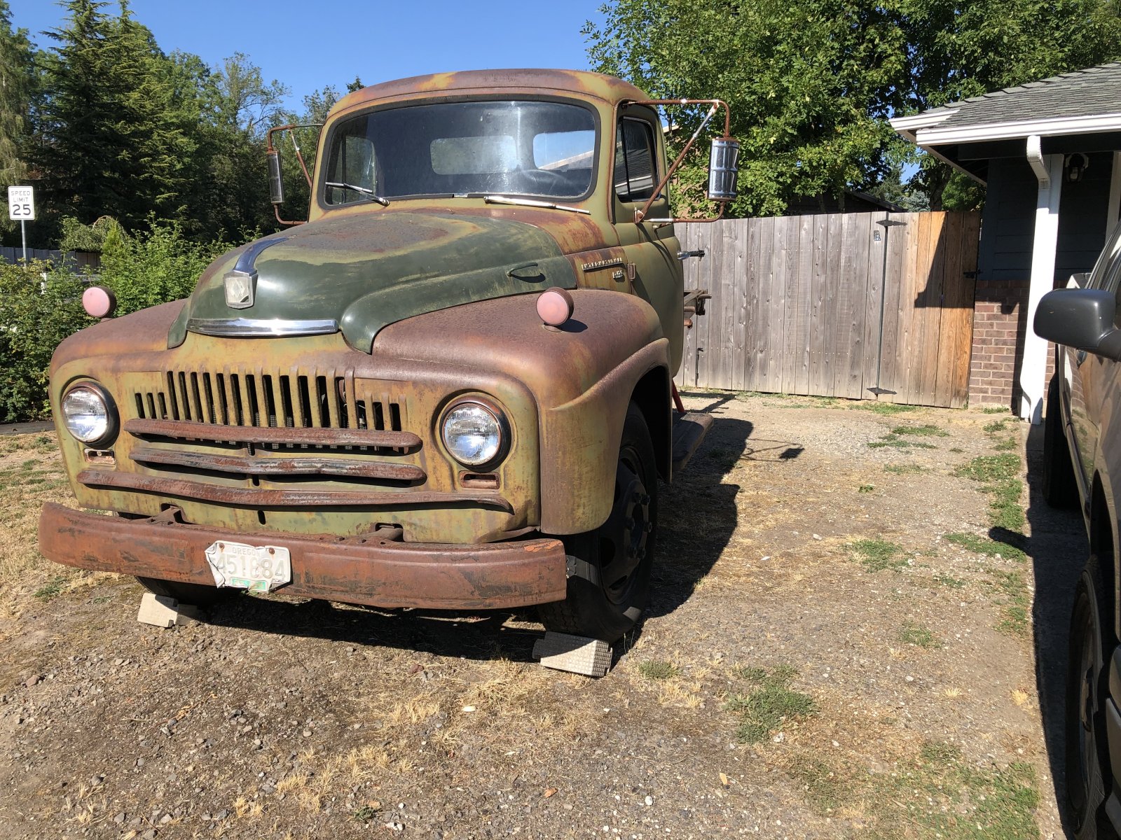

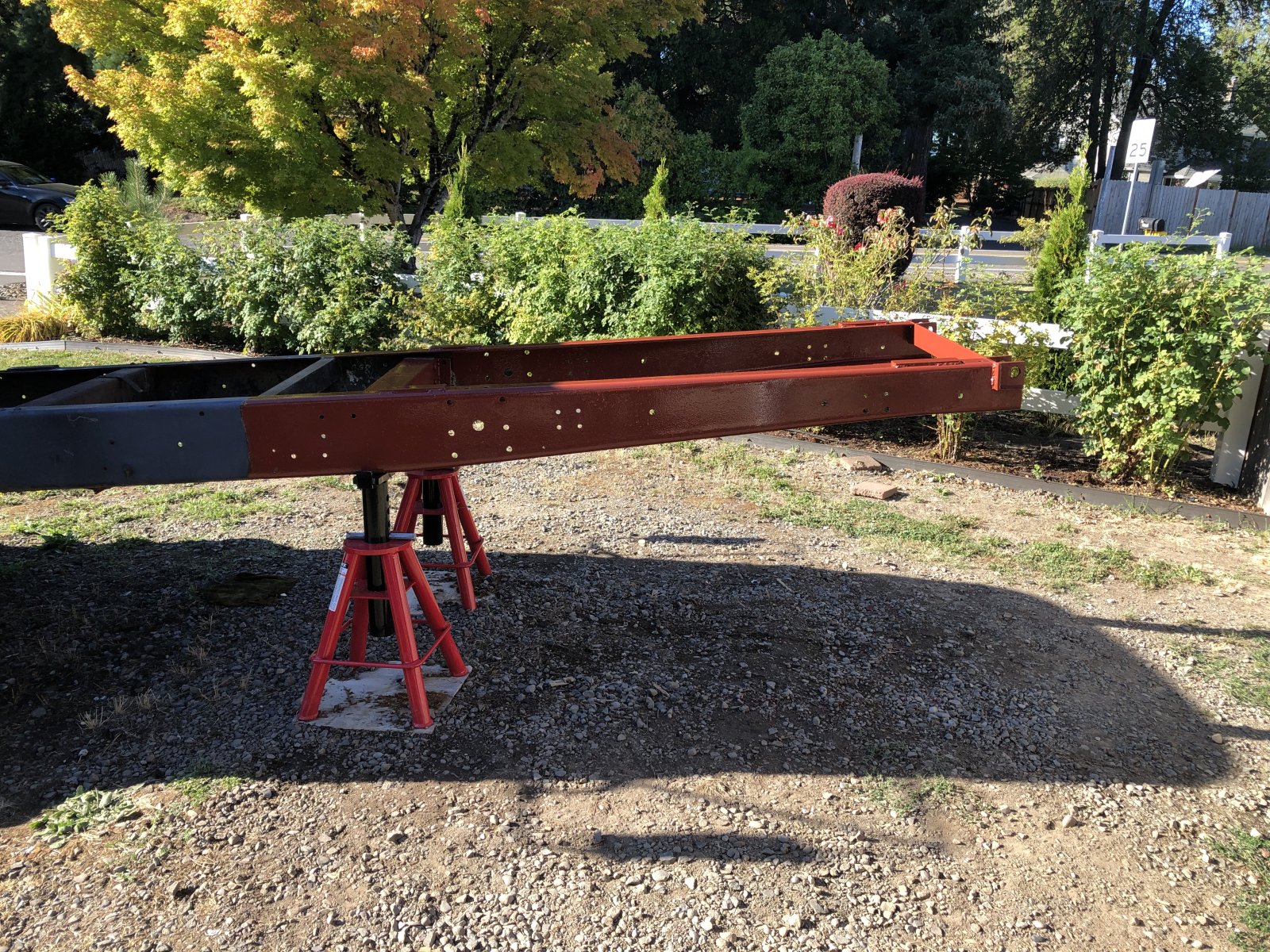

    I realize that I am late to the party on this but yes. Here are some shots of my 1953 L-170 that I am working on. Currently wire brushing 71-72 years of rust off of the ch***is, swapping the old rusted out electric two speed rear and drum brake front axles for newer stuff with big 6 lug disc brakes and better gear, doing a Hydromax brake system on it, going to run 8R-19.5 motorhome Budd Wheels on it, RR the engine (seized) and 5 speed direct trans with a 1995 Ford 4.9 EFI with a Zf5-42 main trans and a Watson M46 auxiliary transmission.
