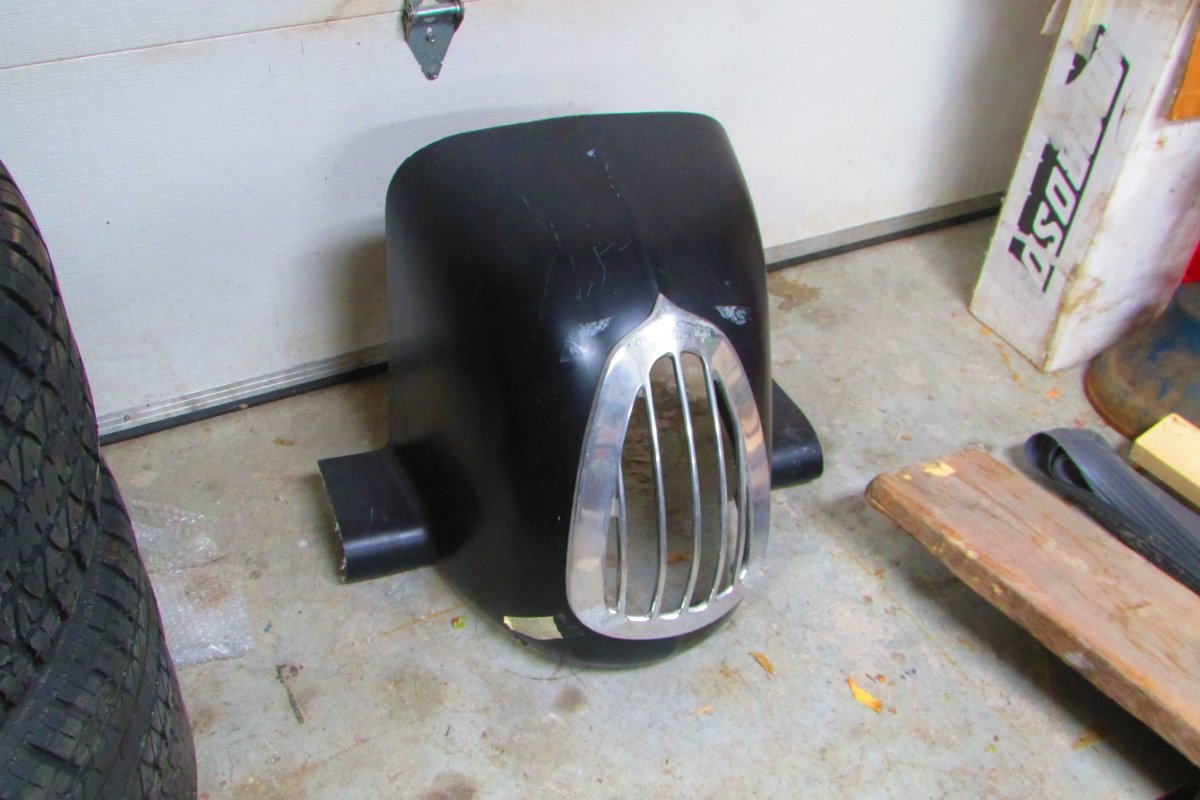

    Hmm got knocked off net just as I tried to reply. Give me dimensions at frame rails. Have a fiberglass nose I wanted to run on a track roadster but was too narrow perhaps I can help

  11. or you could use this
