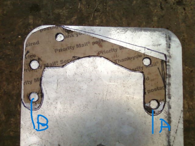

    Scarbird skips 49 through 56 Plymouth all together. I don't know of any pfd for the caliper brackets for that era of Plymouth and remember the thread was dead for 12 years before today. Screenshot (282).png

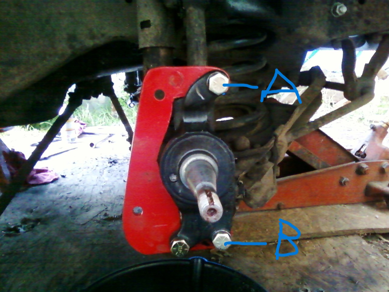

    If I wanted to make a full scale version of the bracket pattern picture in post #4in of the link posted by derbydad276 to suit my car this is how I would go about it. First take a measurement from the centre of bolt A to the centre of bolt B as per Caliper Bracket 9. Now download a picture of the bracket pattern in post #4 in the link posted by derbydad276 click on the picture and take a measurement from the centre of bolt hole A and bolt hole B in picture you downloaded. Now calculate the percentage difference between the two. Now click on the 3 ... on the top, Click on resize image, click on Percentages and put the the percentage you have calculated and save. Click the picture where it is saved and print it off from there. The measurement should be about the same as the first measurement you took, if it is not quite correct you will do the same again just tweaking the percentage a bit. If do decide to do this please let me know how you get on. Caliper Bracket 9.jpg
