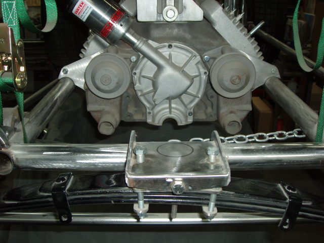

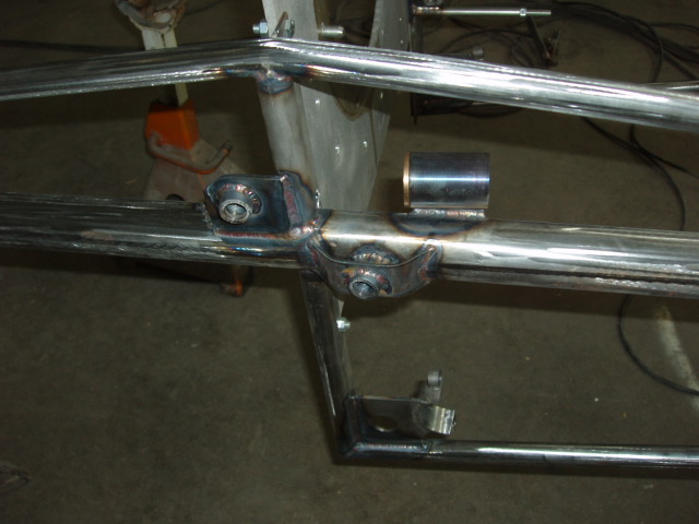

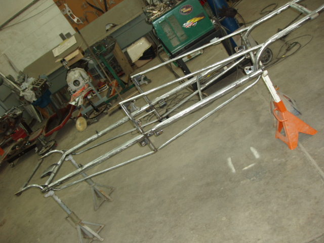

    Ch***is is ready for final welding. 1 3/4" X .120" frame rails. Will get a 7/8" lower truss. 38 Ford tube axle. 201 N O S Halibrand 2" open tube axle. Parallel rear torsion bar suspension. I like to keep things simple. IE; LF. 5/8" radius rod bolt turned down to mount the 3'8" shock absorber link. RR; 5/8" spherical bearing and 3/8" rod end for torsion bar arm link. Rear shock links, drill one hole. Steering box clamp lower bolt [ threaded rod ] to mount master cylinder. Gusset for lower bolt. A good place for brake pedal pivot. K I S 2023-08-05 18.01.31-8.jpg 2023-10-04 20.17.45-1.jpg 2023-10-04 20.17.45-2.jpg 2023-10-04 20.17.45-3.jpg 2023-10-04 20.17.45-4.jpg 2023-10-06 20.43.40-1.jpg 2023-10-06 20.43.40-2.jpg 2023-10-06 20.43.40-3.jpg 2023-10-06 20.43.40-4.jpg

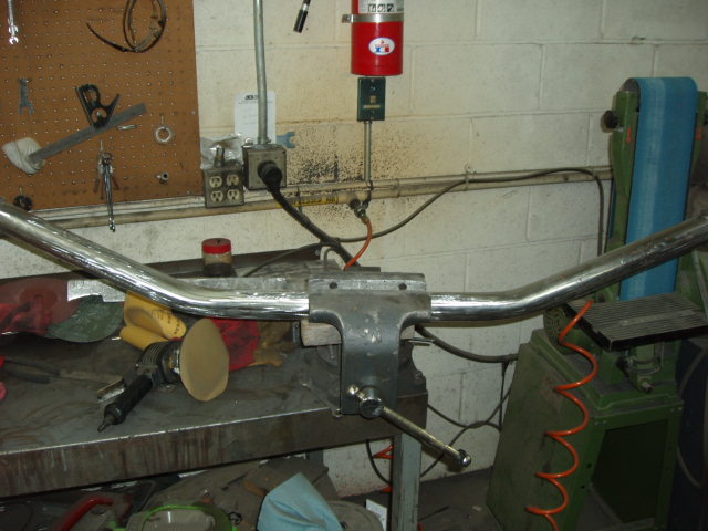

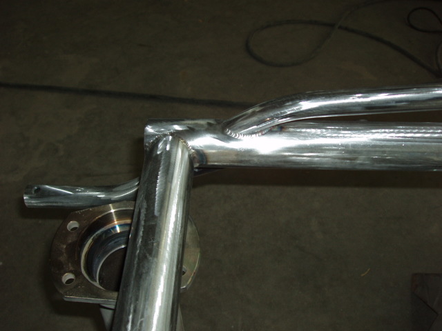

    Posts: 3,858

    Joined: May 28, 2007

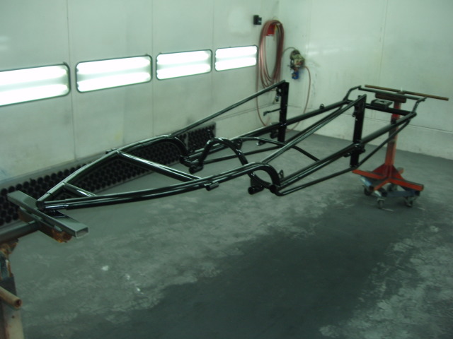

    Nice job! looking forward to seeing it progress!

    Posts: 18,765

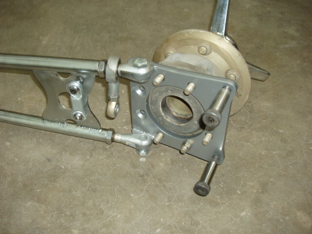

    Frames

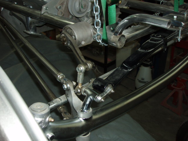

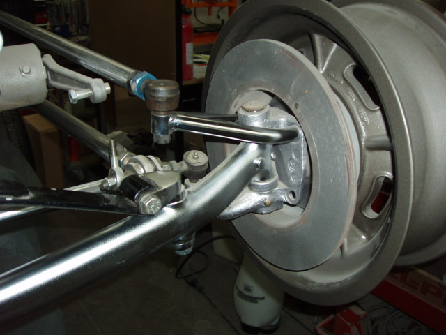

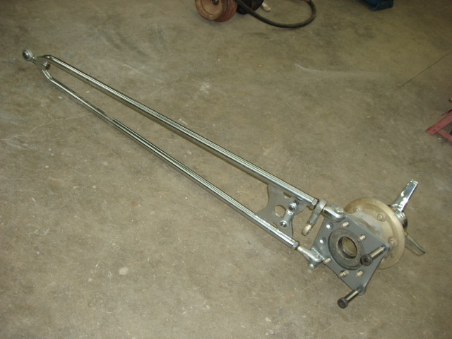

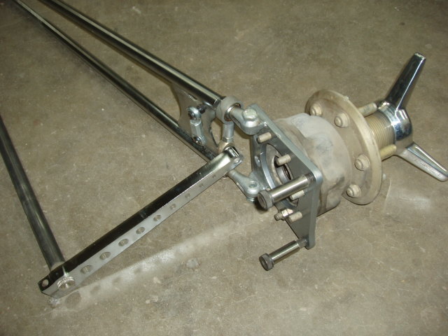

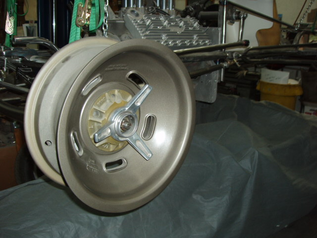

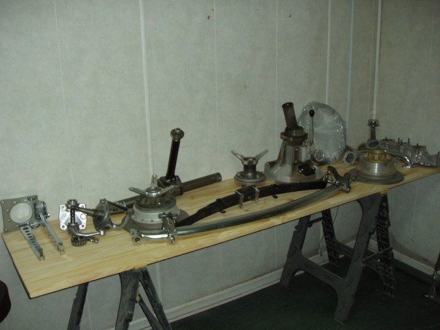

    Spindles are 42-48 Ford car. Sprint car hubs were made for F150 P U spindles. I made a sleeve for the inner bearing. I found a seal that fits the hub and fits the spindle. Axle hanging. That's the reason for crazy shackle angle. I did not like the angle of the front hairpin. I like the looks of the 2 piece R F radius rod. Ross steering. 4 perfect Halibrand kidney bean wheels. 8 " retreads in back. Ribs in front. STRECHED MIDGET 007 - Copy.JPG STRECHED MIDGET 009 - Copy.JPG STRECHED MIDGET 010.JPG STRECHED MIDGET 013.JPG STRECHED MIDGET 015.JPG

    1/4 " magnesium front engine mounts. Will powder coat for protection. Add a 1/4" spacer to the crankshaft. STRECHED MIDGET 008.JPG

    That's so nice... that RF radius rod looks good, probably easier to make as well. Since you mentioned KISS, I took a second look at the suspension. Dead perch, no track rod needed! But I wonder, will the LR torsion bar arm attach without the shackle arrangement like the RR attaches to the birdcage plate with?

    This may be a clueless question, however I'm curious about something. You are using a Ford v8-60 tube axle with a hairpin on one side and a single bar on the other, similar to what I have on the Whatever project. By the way really nice looking batwings. The hairpin is hooked up using clevises, which seem to me cause some binding. Do you consider that a problem, or does the batwing have some movement on the spring perch bolt? I might be overthinking this, and I replaced the clevises with rod ends. What's your considerable experience opinion on this?

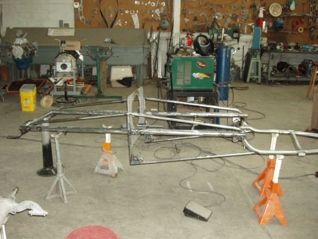

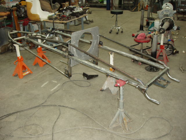

    Finishing the welding. Installing the lower frame truss. 7/8" OD x .095" 4130. Kept the 1/4" thick magnesium torque plate in place to prevent disstortion from welding. Frame would be flimsey without the torque plates front and rear. The engine block is a structual member. Off to the powder coaters real soon. 2023-11-11 09.10.02-3.jpg

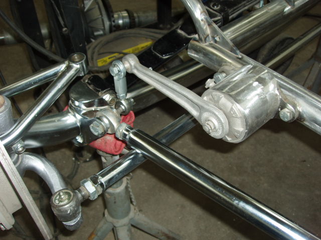

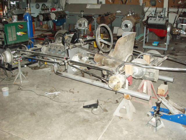

    Ya Dave that was standard practis on circle track cars with parrallel torsion. The circle track car I built in 1964. Parallel torsion. Panhard bar in front because 10" arms. 14" arms in the rear but I used a Watts link on the rear of the 3/4 ton Ford rear end. No Q C's allowed. 6.66-1 R & P. I used a Panhard ba img052 - Copy (2).jpg r on my recreation #97.

    Hey guys. Help me out. Tell Dave what you think about Dave's question about bind when using clevises on the R F radius rod.

    I sanded all the tubing before installing so I won' t have to sand blast the frame prior to powder coating. I hope. 88 years old with a tremer it's hard to lay welding beads like I used to. The torsion mounting tubes stayed in perfect alignment. That's important. Dave. I consider myself an engineer. Self taught. 2023-11-14 09.14.33-1.jpg 2023-11-14 09.14.33-2.jpg 2023-11-14 09.14.33-3.jpg 2023-11-06 08.00.57-1.jpg 2023-11-06 08.00.57-2.jpg

    Welding is done. Re-sanded where ever possible. Wire wheeled also. 2023-11-19 19.39.58-1.jpg 2023-11-19 19.39.58-2.jpg 2023-11-19 19.39.58-3.jpg Local powder coater moved. Won't be set up until March so I guess I will have my friend paint it. Made some quicky attachments front and rear for my friends Whilly-Jig. [ engine stands.] Will have to make one cut to remove the rear one.

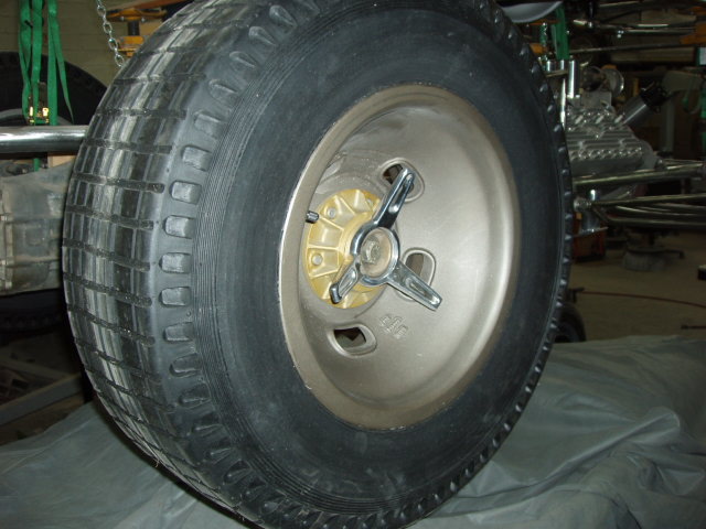

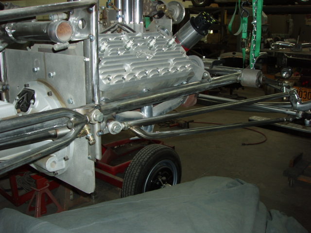

    ***embling a dummy engine. Wieand intake. Straight linkage on the left. Arms facing down to clear Aeroquip coolant line. Evans marine he 2023-12-14 22.35.46-4.jpg 2023-12-08 09.34.21-4.jpg 2023-12-08 09.34.21-5.jpg ads. I believe the outlet at the rear will improve cooling.

    Frames

    So how big is the Maxi Taxi? Sounds like a fun diversion for you. And please post a picture or twenty of it along the way.
    Speaking of pictures, could you post a picture or two of the front suspension components before you re***emble it? As they say imitation is the greatest form of flattery. And I'm known as the great plaigerizer. I'll let you connect the dots....
