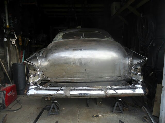

    Ive been focused on describing the chop.
    Trying to stay on point
    All the while the big picture is on my mind , and how everything is going to work together. A lot of unseen things were done such as extra body mounts,reinforcing the b piller, extending the roof rail structure back to the wheel house, extra bracing in the trunk, changing window mechanisms and mounts . And of cource pushing and pulling so every thing lines up opens and closes.
    I don't want to bore anyone with this stuff, but if anyone takes on a project like this it needs to be done!
    consider a lot of time and re engineering.
    Read as "structural integrity"
    Ill post pics only if anyone is interested

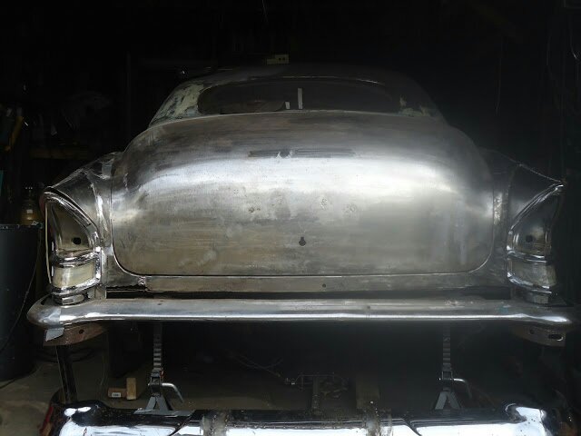

    Its "only metal" someone once said.
    Doing things over to get it right seems to be my mantra.
    Here after changing out the catwalk got rid of the hump and refined the beltline
    Then fabing housings for the packard lights witch get cut off and redone since the didnt follow the reveal on the quarter
    And were 1 inch to high

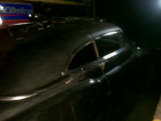

    Moved on to the side gl***.
    Had to graft in the inner olds hdtp quarters to mount the rear
    Window mechanism. Chopping
    The pot metal frames was an epic fail . Let alone being pitted and rusted. Live and learn
    So I fabbed a lower channel, mounted that to the stock pivot,
    Then chopped a 58 ford quarter frame made of stainless.
    I had to re arch the top to match the radius in the roof rail. With a buick upper run channel
    Same with the vent window .
    Grafted the mount. then chopped the olds vent.
    Welding the top with mapp and alluma rod from HF.after removing the chrome plating. that was the whole problem on the qrtrs. I guess the chrome creates hot spots and everything melts out .
    Then used the flippers and stainless frame from the ford
    it actually all worked out well

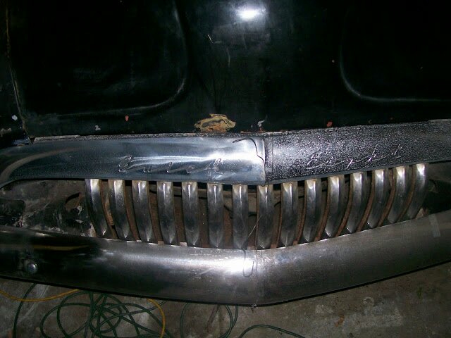

    A long time ago a friend put a buick grill in his 55 plymouth
    I was lucky to grab his old one.
    Thanks moose
    I think it looks pissah with the 53 roadmaster grill and stock mustache.
    I guess This is 2010

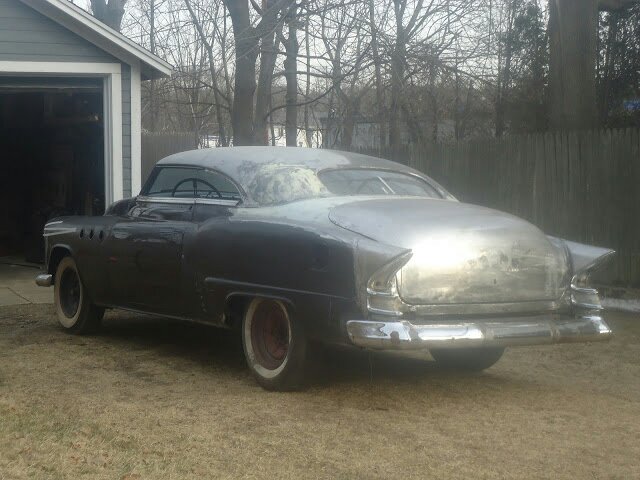

    This weeks latest.
    Playing with springs.
    I will not to bag it.
    Im trying hard for true traditional , late 50s .
