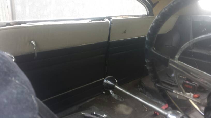

    Enjoying the weather.
    Got about 5 hrs In on the door panels.
    Put some sound deadening and insulation on the inner roof
    And floors

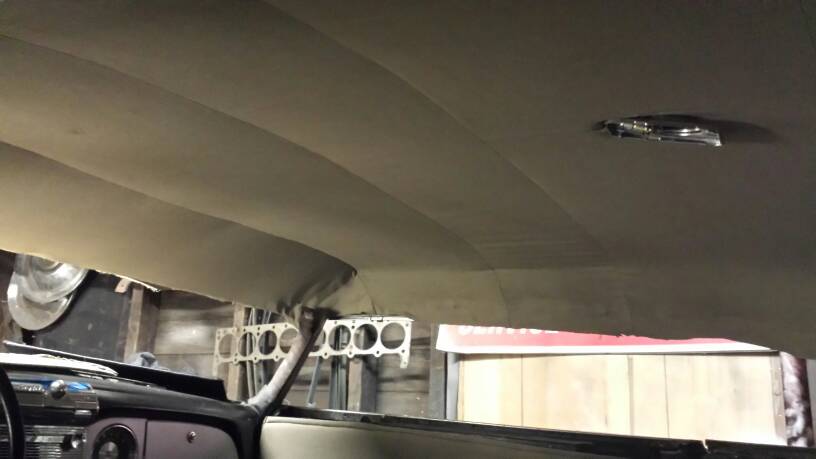

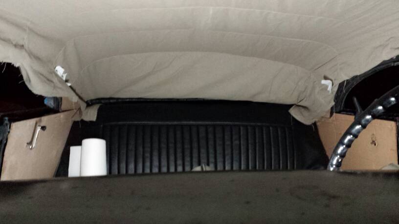

    Over the weekend. I banged out a headliner. Mocked it in.
    It fits perfect but I decided to insulate first I also need some closed cell foam and K-grip for the inner rear around the backlight.
    When I hit the upholstery jobber
    Im thinking I may pick up a few yards of black stayfast or sunbrella.
    Fo Carson top anyone?
    Input needed.
    Black on black cloth?
    Or metalic leaf green/teal pearl
    With black cloth

    Home store insulation
    Lightweight and cheep.
    Under that is roofing paper.
    Made a huge difference in dampening . Before I did this if you just tapped on the roof it sounded like a huge kettle drum
    I guess it was a minor setback from hours with a planishing hammer.

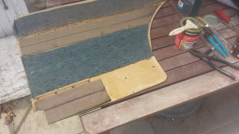

    Got the door panels done this week

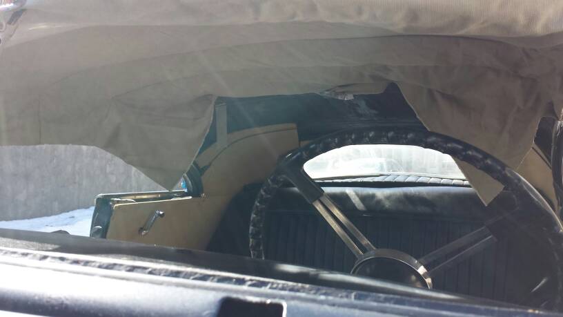

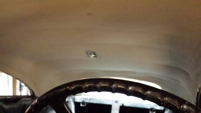

    Pulled the trigger on the headliner Today.
    Some time with the steamer next.to work out the pesky wrinkles.
    Working with cloth for the first time. A little trickier than vinyl.
    But gives that vin
  17. hacknwhack
    Joined: Jan 25, 2006
    Posts: 481
    hacknwhack
    from mass
    Gives it that Vintage feel.
    What do you guys think
    Im still grinning from all that glue.:confused:

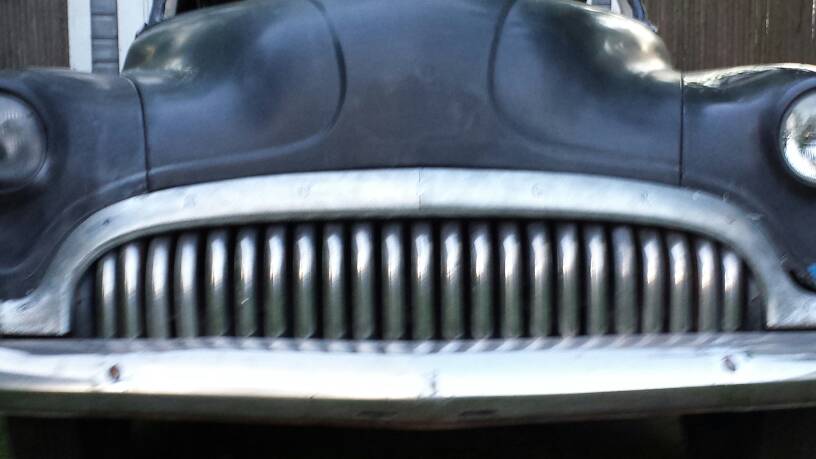

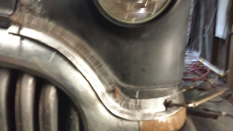

    Grill was driving me crazy
  20. hacknwhack
    Posts: 481
    hacknwhack
    from mass
    Picked up a 53 special upper grill last night.spent half the day refining the fit. More work to do. But this is what im sticking with.

    Looks good Shane . That is the front bumper off of . I apologize if you already mentioned what it was earlier . Andy..
  22. hacknwhack
    Posts: 481
    hacknwhack
    from mass

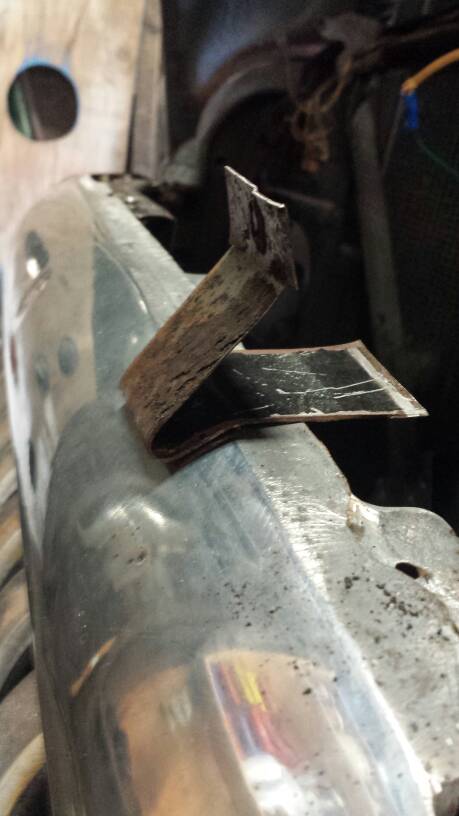

    That is a 55 plymouth bumper shortened at the wheel house.
    A 53 special upper grill bar minor trims to fit. Still Need to modify sheet metal
    Its bent on the p*** side.
    A little heat should fix that
    And a 53 special grill.the grill I made custom brackets and swapped out teeth 2,3,4 and 22,23,24. For full length bars where the signal housings were.

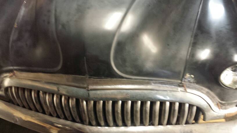

  24. hacknwhack
    Posts: 481
    hacknwhack
    from mass

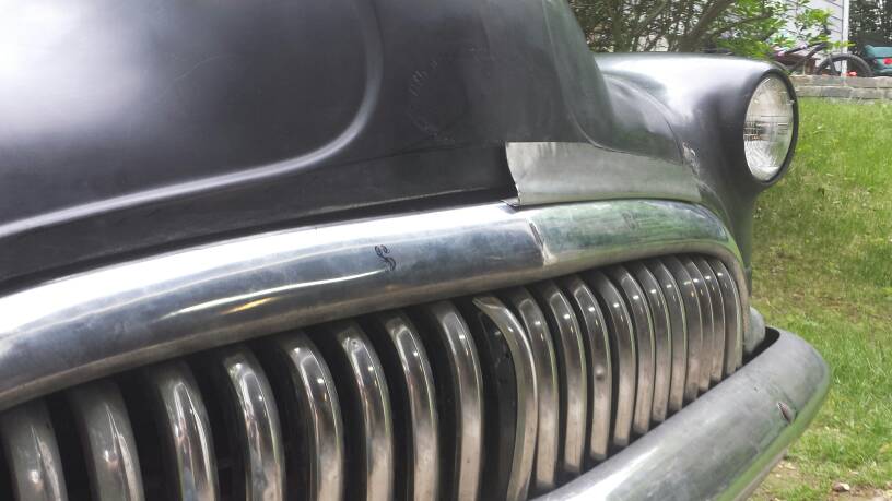

    Decided to french grill in.
  25. hacknwhack
    Posts: 481
    hacknwhack
    from mass
    More hand work
  26. hacknwhack
    Posts: 481
    hacknwhack
    from mass
    Some more detail work and I'll weld it in
