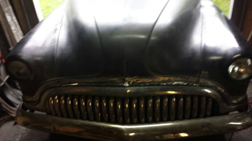

    2 more days of fitting,refining,welding, and grinding.
    Some hammer and dolly work next.

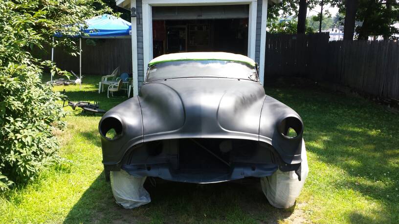

    Content with the paint on the. roof and a deadline for september, im going to skip adding scoops in the hood and full cruiser skirts. Maybe next year.
    Moving forward with black paint on the rest of the body. I was considering a two tone scheme with a teal green metallic or a semi gloss black. Just because im afraid of waves in the side panels.
    And some lazyness.
    Spent a lot of time studying the body I think its close enough. Wetting it with wax and grease remover. Getting a temporary shine and looking from all angles ill find some dings and minor lows but not much more.
    full gloss black it will be.
    So I taped of the roof. Sanded the epoxy primer with 180. Reapplied a solid seal coat of jp 377 epoxy.
    Waited an hour the came back with 3 coats of jp202. quick blocked with 220 then two more coats. I ll let it shrink for 3 or 4 days the block with 400 . Seal again then black.

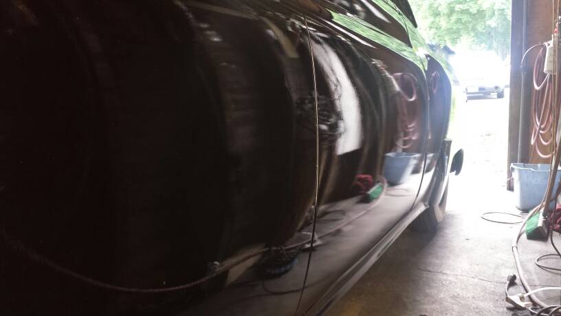

    Popped the hood off
    Layed down two coats
    Body work is perfect
    But still getting dust.
    Made the mistake of wiping it with a paper towel
    After tack rag... dumazz
    Blame if on a the lager
    I'll sand it down And do it again.
