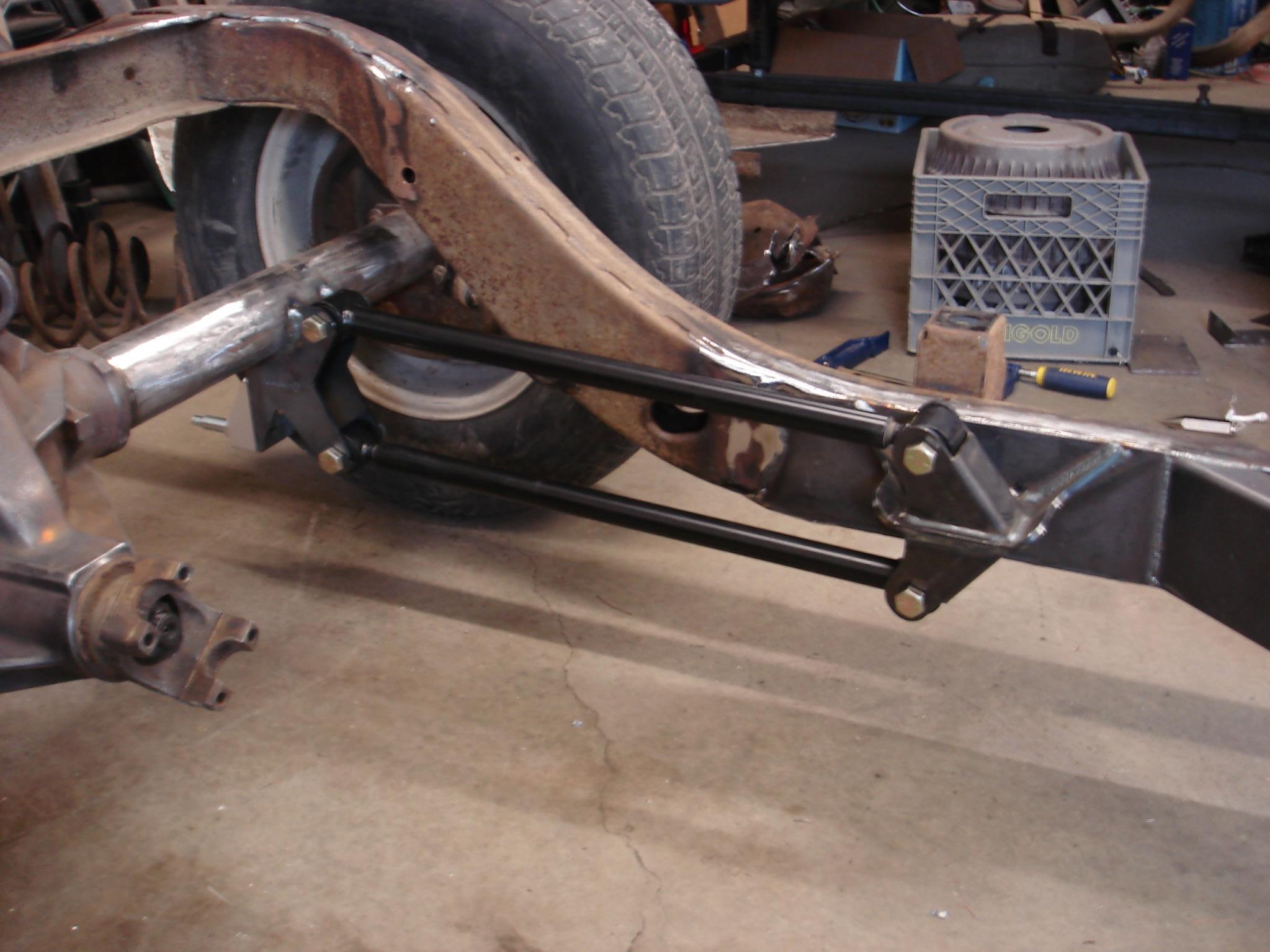

Here are some photos of truck arm installs and one for a 4 bar setup. In most cases, you could use the original Buick springs, frame pockets and Panhard bar by using some of the brackets currently on the Buick axle housing. One caution....resist the temptation to use the original Buick diagonal braces. They are far too weak to use as torque arms as they do not carry those loads in the stock design, the torque tube does solely. The diagonals only serve to keep the rear axle housing 'square' with the torque tube.
