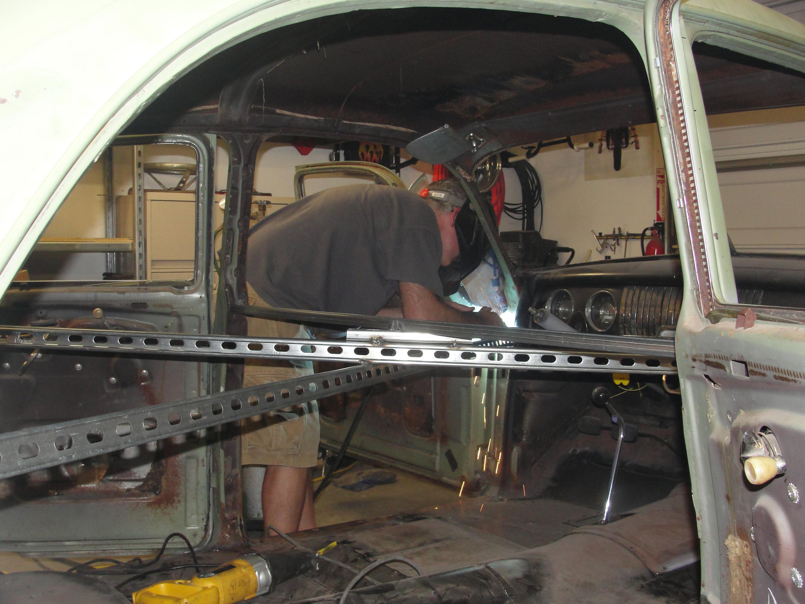

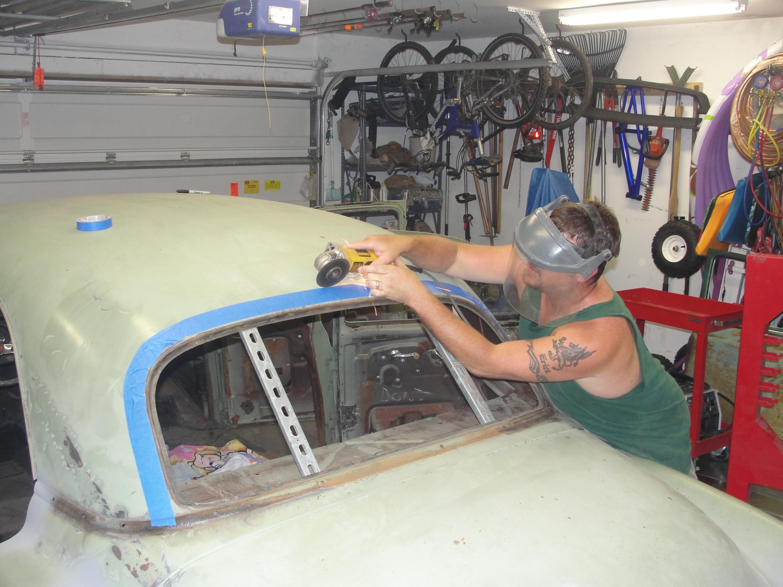

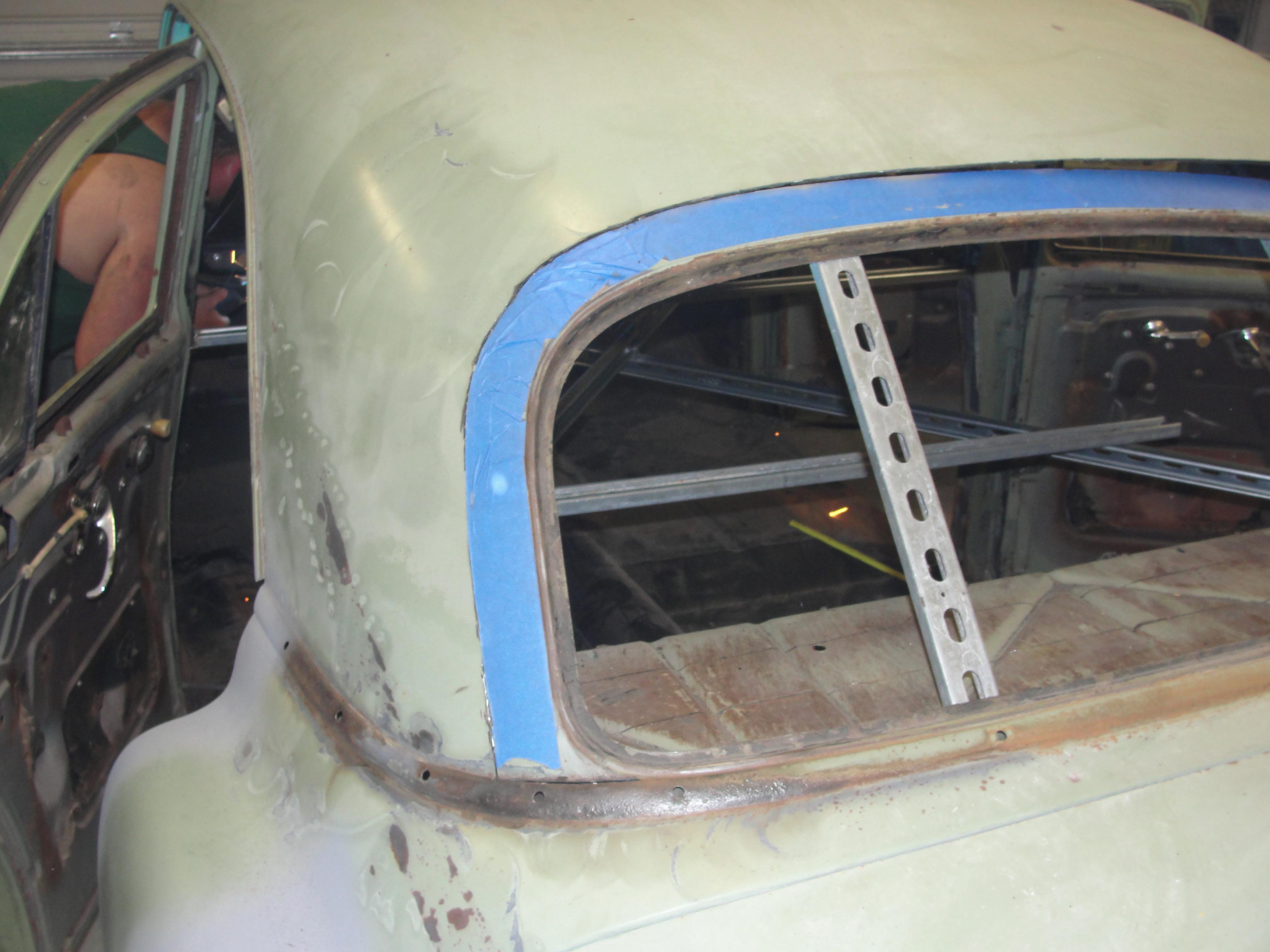

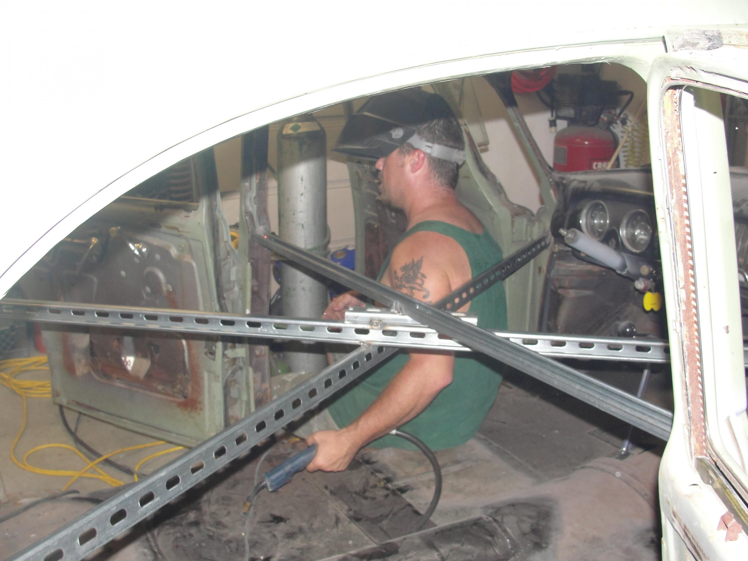

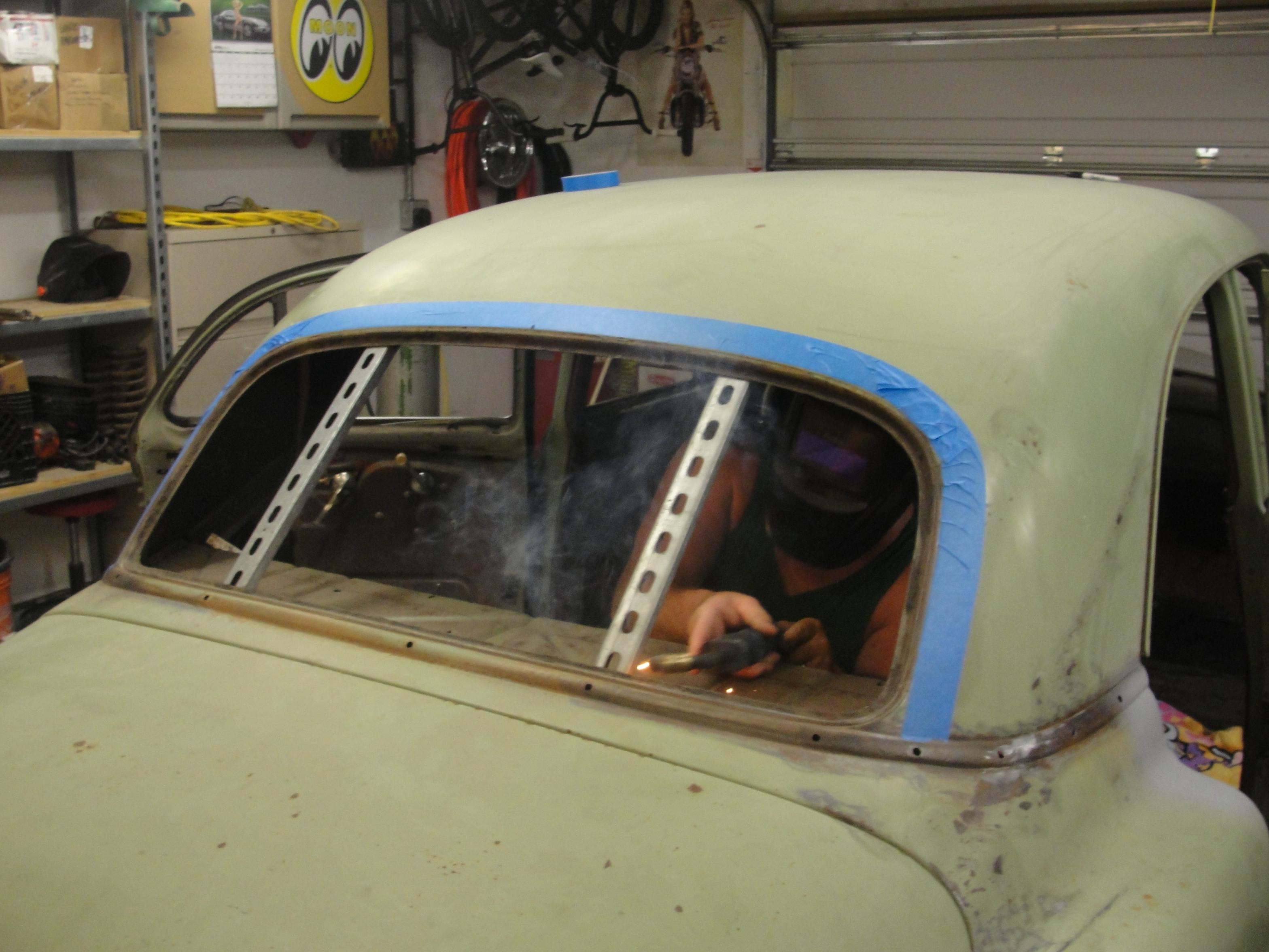

    Then the body needed to be braced. We used 7/8" unistrut to first bace the opening for the back window. Then we made a "X" in the car from front to back and three going side to side, one in front of the car, one in the middle at the B pillar and one at the back of the car at the C pillar. All about middle way up inside the car. They were welded in place and welded to each other, it was solid.

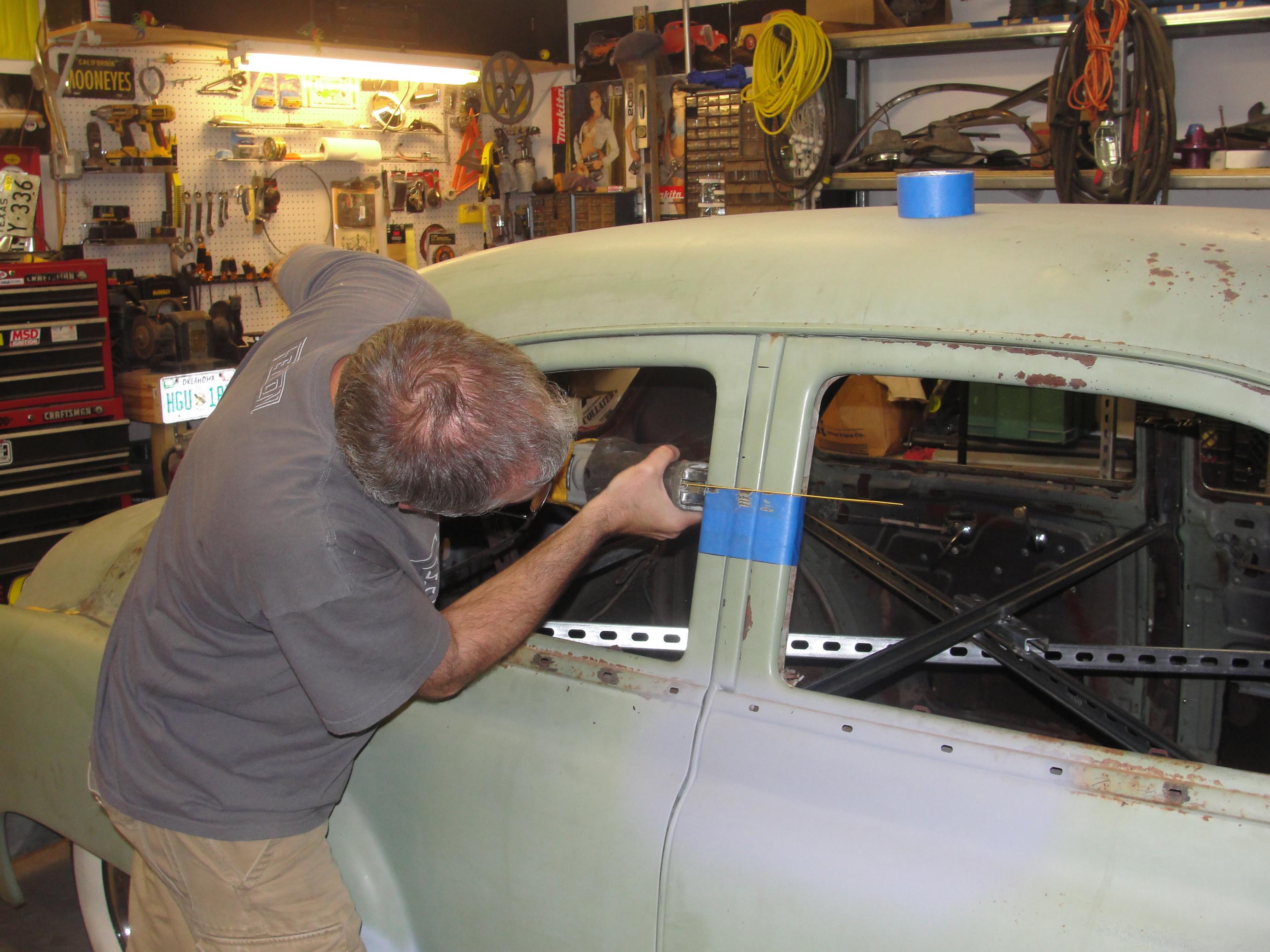

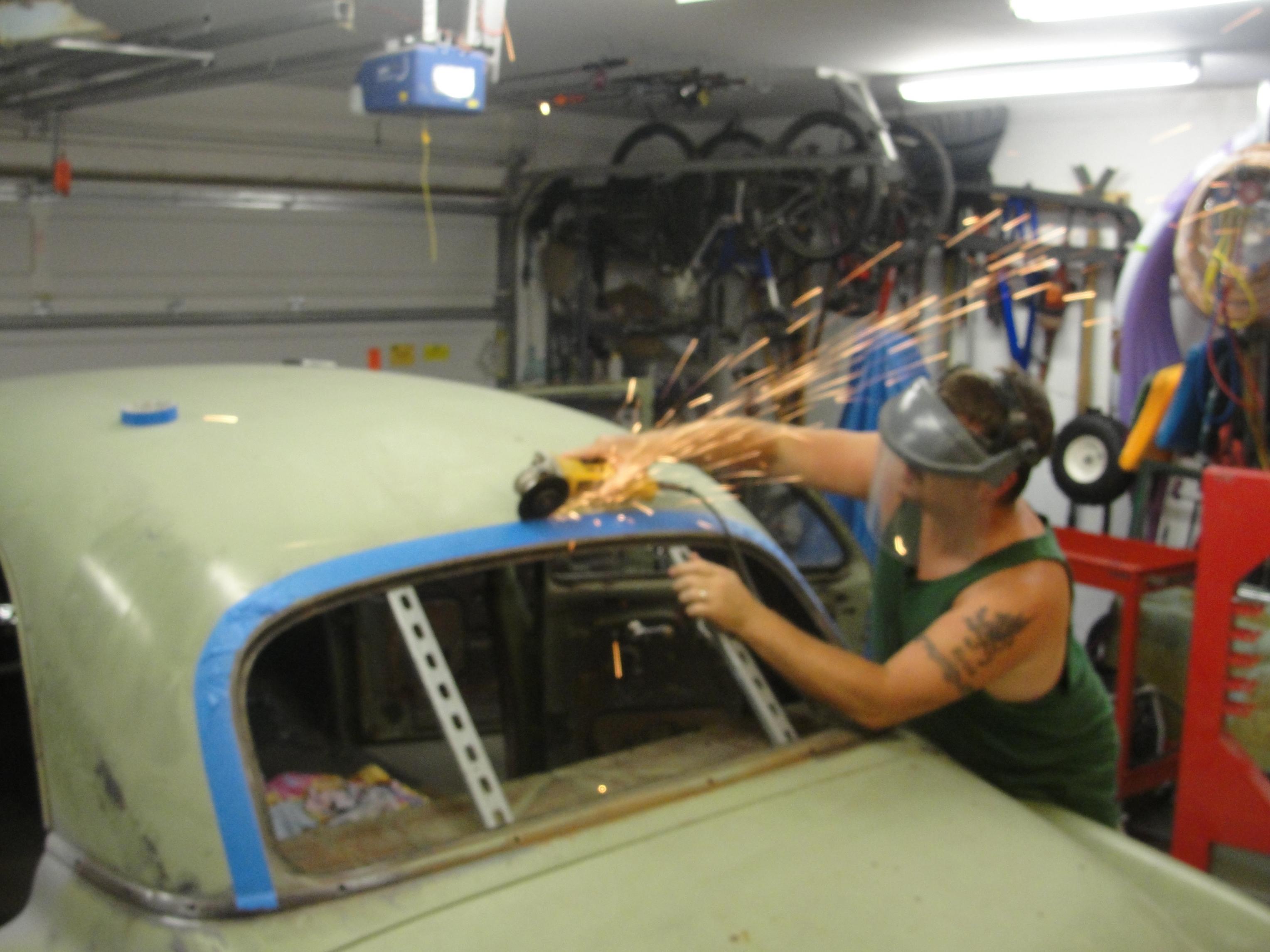

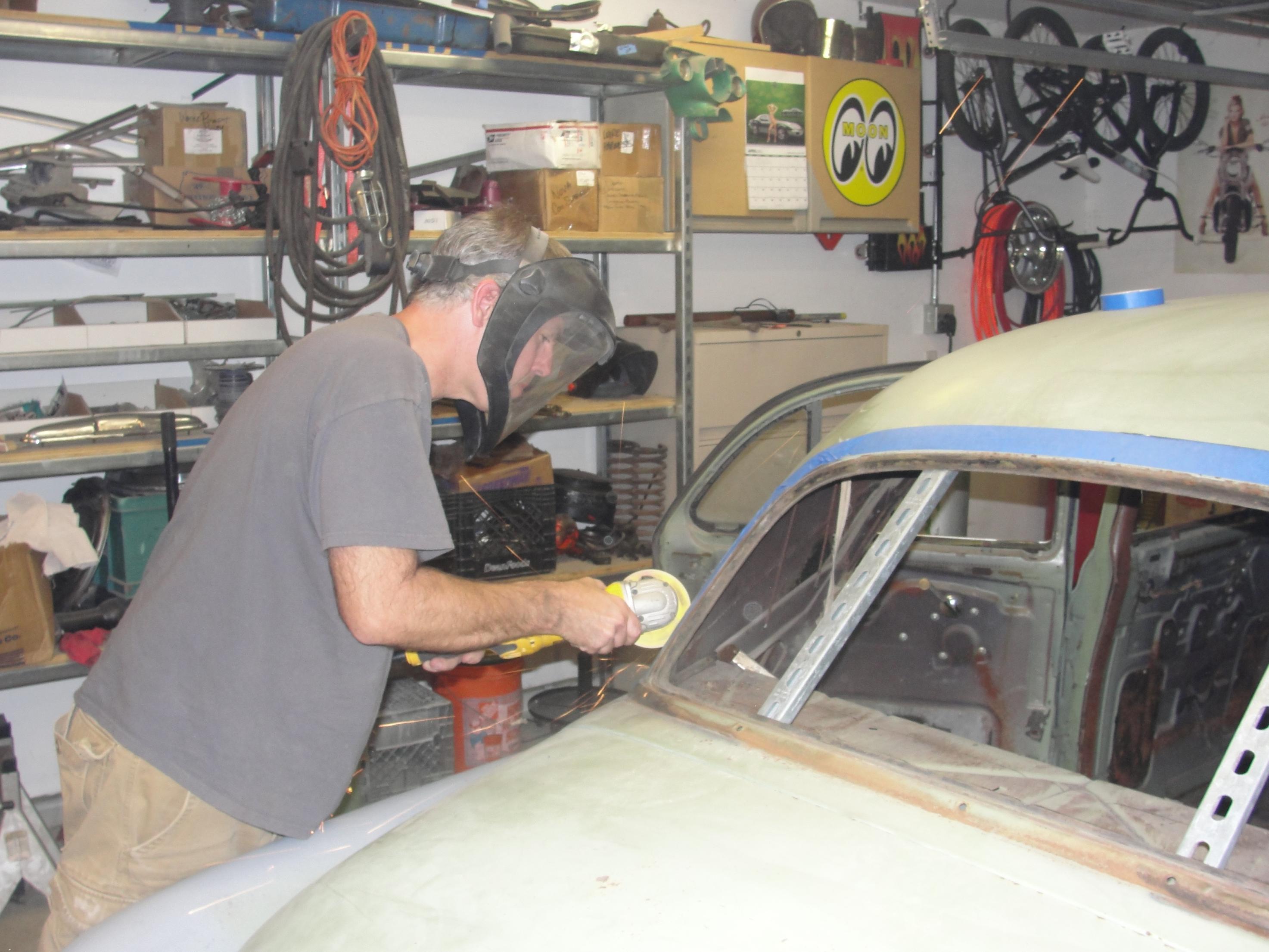

    Time to start cutting!!!!! We started by cutting about 2" around the back window leaving it attached to the car at the belt line.

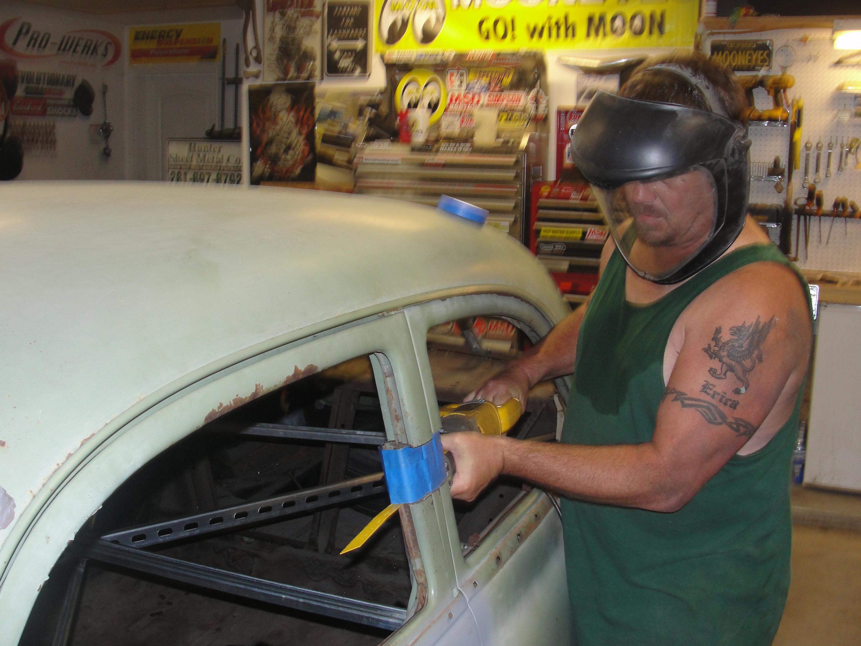

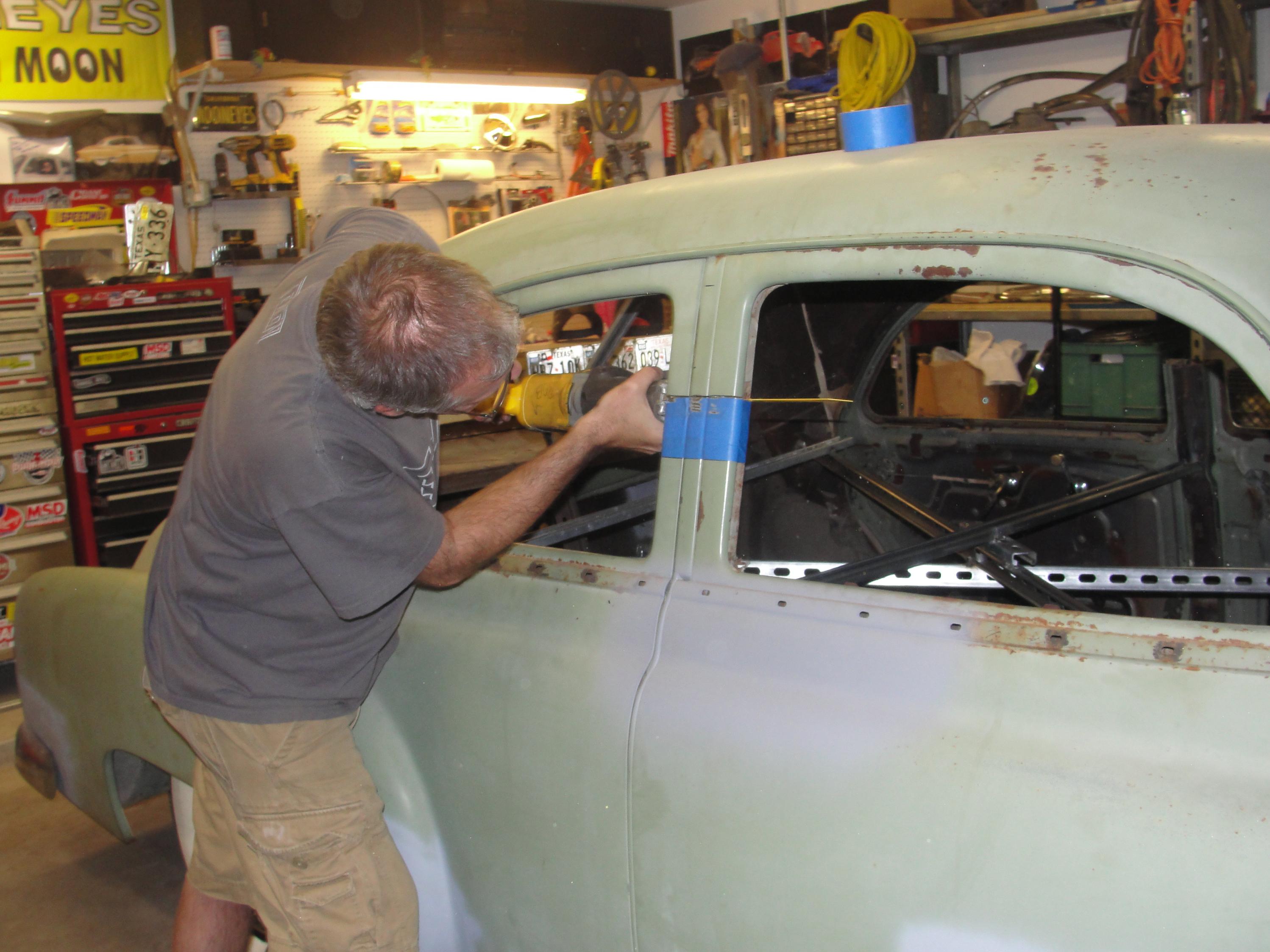

    We then moved forward to the B pillar and wacked 3" out of it.

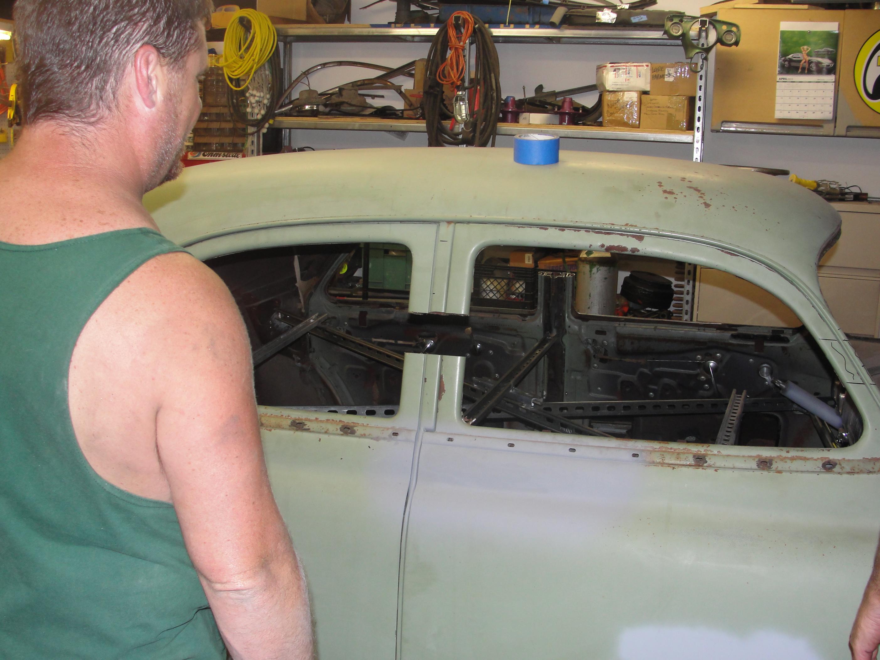

    We supported the roof with some more strut temporarily while we moved to the back to cut the C pillar. We cut it right above the belt line around to the window and slid the roof forward to the A pillars.

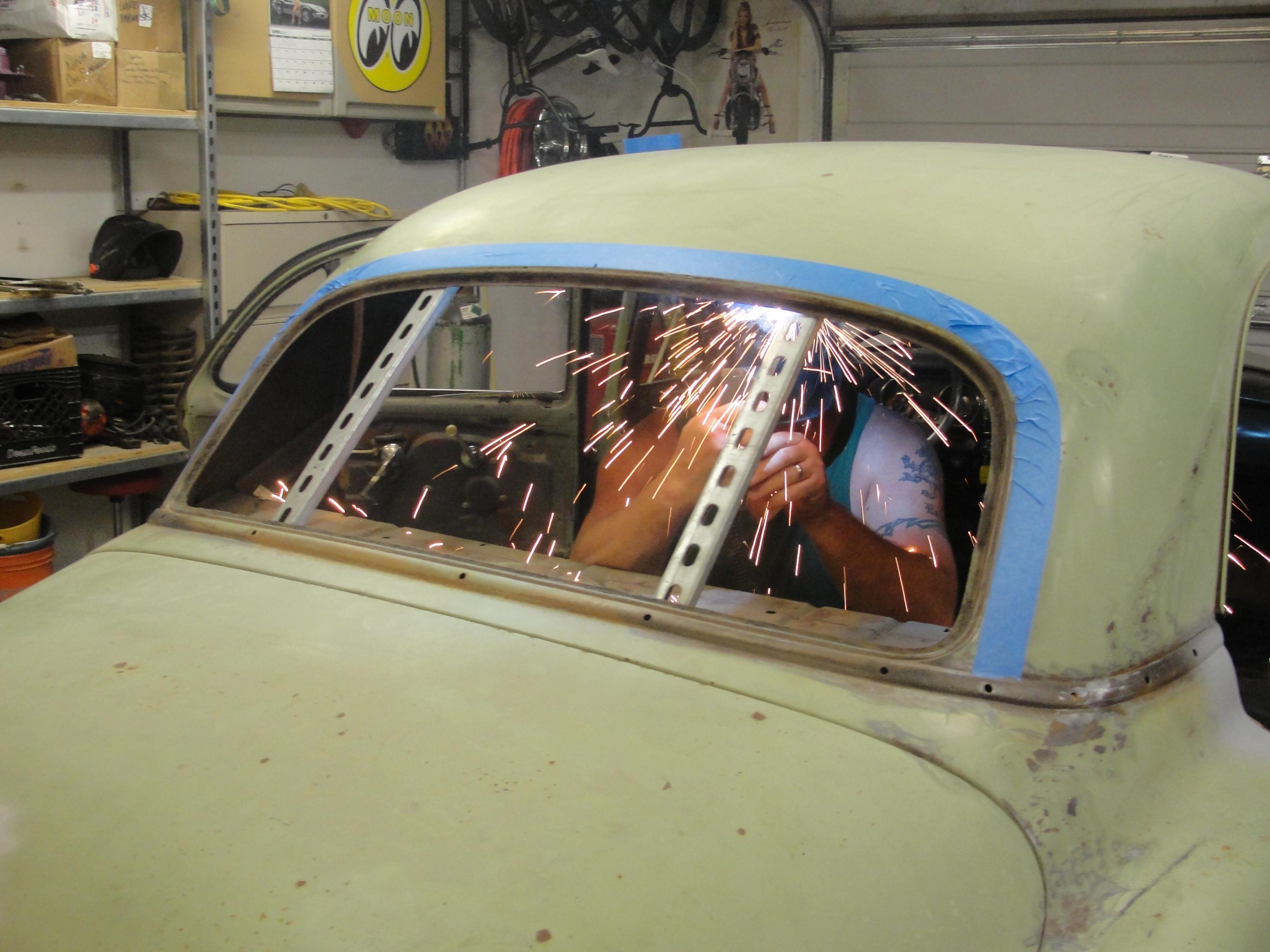

    With all that tacked into place we laid the back window down and it just didnt flow with the curve of the back doors so we cut it out along with the belt line (that I am trying to keep) and slid it forward until it looked good. We moved it twice before we decided it was perfect, somewhere around 2 1/2" if I remember correctly. Then we cut reliefs in the catwalk before extending it to make it lay down the same angle as the trunk. Then we added the strip of metal to meet up with the bottom of the beltline. The rise in the trunk determined the bottom height of the window.
