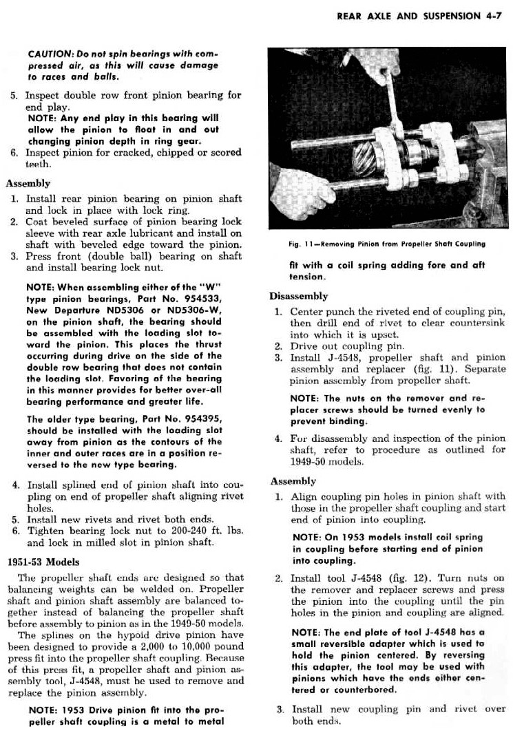

    today my friend called and said he re-read the shop manual he has, it says in there its pressed on with 2-10,000 pounds of force!!!!! i guess we better make a better tool for removal, but then how the heck to put it back on? anyone got a 7' press? lol!! darn chevys, ford sleeves tap off with a brass hammer

    thanks for that, it must be in the manual my friend has, though i had not seen it until you posted. looks like a stronger tool than i made
