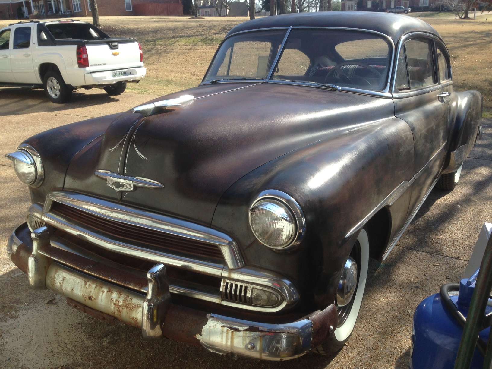

    Thanks for the advice on the master cylinders, guys. Things have been going really smooth for me on this build so something had to hang me up.. this MC is it.
    I finally got the large front plug off of the front after using the candle wax method and an air impact. I rebuilt the whole MC but now after putting in all that work I don't think I'll use it.. the inner cylinder walls are just a bit too pitted for my peace of mind. So a reproduction has been ordered. I have a genuine 1951 Delco paperweight now!
    Before
    After.. and unusable :(
    I got new stainless front brake lines installed and will finish the rear very soon. When I get my new MC I should find myself boogie'n down a road or two. :cool:

    So here we are as of today, I made some good forward progress and feel good about it.
    First things first, I think I got ripped off on my new MC. Buyer beware of Partsgeek.com.. TOTAL RIPOFF. They claimed that my order shipped and gave me a tracking number, but UPS said they know nothing of it. The company provides no contact phone number and does not reply to any of my emails. There are numerous complaints on the web about this vendor but unfortunately I did not think to check before ordering from them.
    Since I got screwed over on my new MC I figured I would give one last shot at saving the original. I went to Autozone and bought a brake cylinder hone and gently honed it out to get the walls nice and smooth. After honing it and putting it all back together it performed really well on the bench. So I have decided to use it now.
    And after many bloody knuckles I finally got her back in the car.
