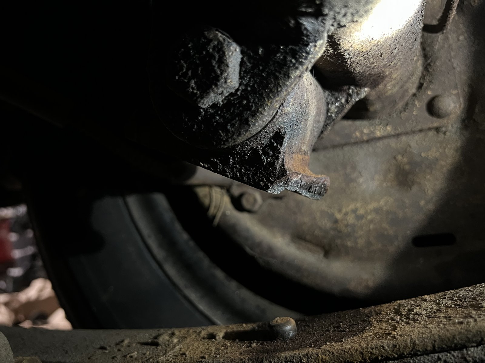

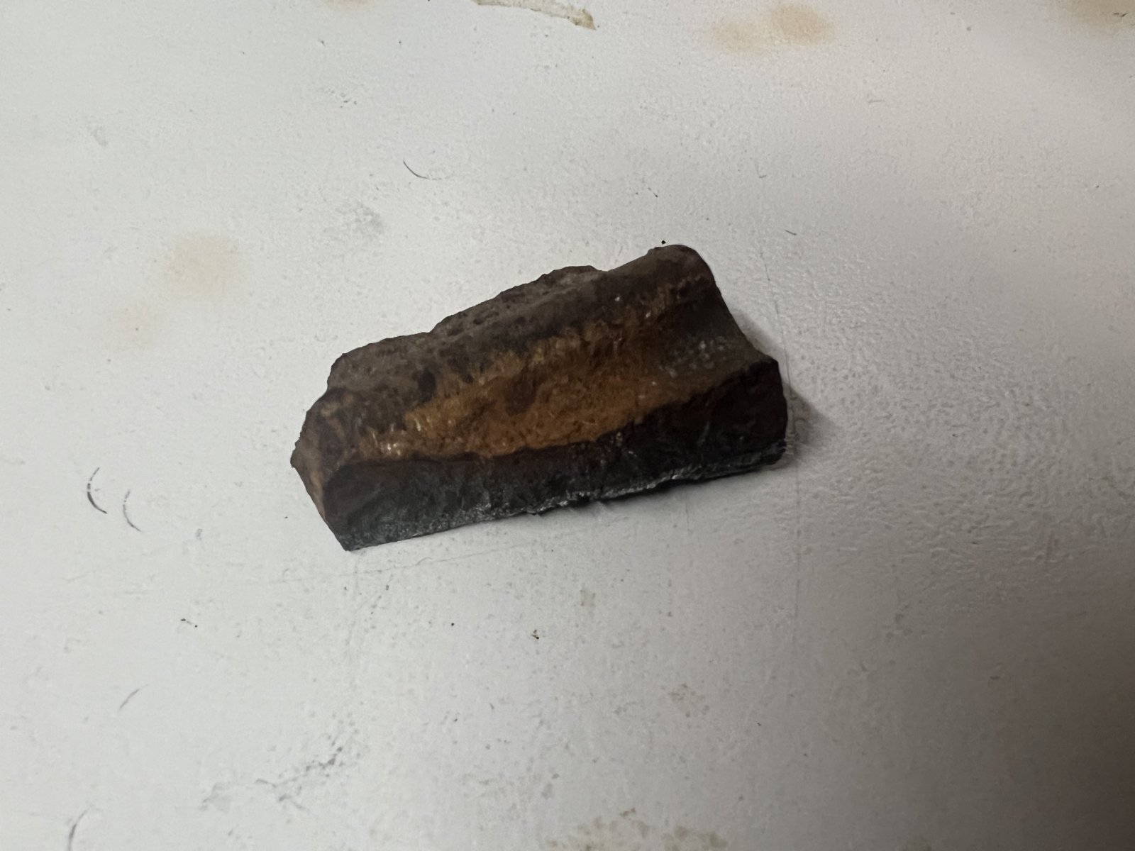

    6520EAC0-4F5D-43CD-986D-2E29DC221809.jpeg F068537F-E17C-4A47-AB1A-64F81E23ED2B.jpeg Hey everyone. I loosened the U bolts on the rear axle to install some lowering blocks and the axle perch broke. I’ve tried searching online for replacements but am coming up blank. Does anyone know if these are sold anywhere? Or if this is something I can weld? I’ve attached a couple pictures. I appreciate the help as I am feeling really stupid right now.
  2. If its steel weld it on. If its iron you can try Ni rod,and pre heating,but iron is hard to fix.
  3. I'd just hunt another perch on marketplace or something. Most guys doing open drive shaft conversions practically give them away. I I mean....I left my stock rear end in the yard where I lived when I did the swap when I moved lol

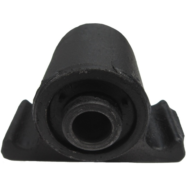

    Place a wanted add for one of these. rear spring seat. 4f63ac8c80a311fd76cf27543373.jpg
