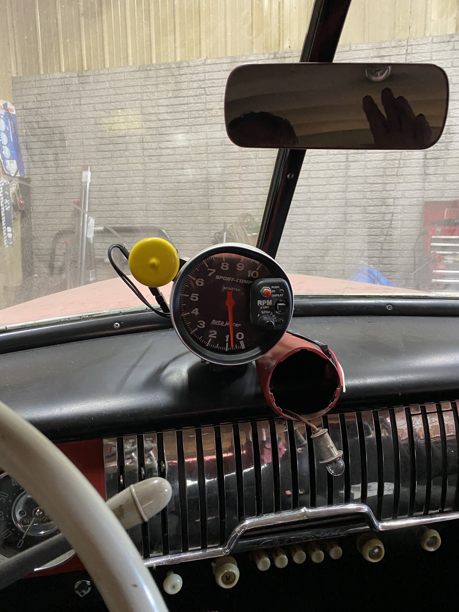

    As I work on the 51, I mocked up the interior to make sure everything fits. The factory column is for an automatic and is in decent shape. But with the shift tube on top it messes with my tach mount and will not be used. I do not see an easy way to modify the original column. Do I go with some form of idiotic tilt column or a tilt column at all. Or should I just look for an old school vintage type column and if so out of what. The wheel works for me where it is and will work even better when I put the smaller 3 spoke wheel on it. The key will stay on the dash and the shifter will move to the floor. The picture shows the seat all the way forward. When it is back almost to the stop my arms and legs fit the car perfectly ( at least perfectly comfortable to me).

  19. snoc653
    Joined: Dec 25, 2023
    Posts: 982
    snoc653
    from Iowa
    I like the skinny tube as well. I will disassemble the current column and see how that works. The head rests might come off the seats to give a more nostalgic appearance but the back and lumbar support of the modern seats make driving so much more bearable for a guy with disability due to a back injury. There aren’t a lot of pre 65 options out there that can compare. I have early Ford buckets in my OT classic Bronco and they do nothing for support. And Jim is correct the car will go down the track. The tach is on the floor in the picture. I thought about getting another clock pod and putting electric fuel pressure and boost in the pods and the tach between them. Going down the track I doubt I will be reading the tach. Mostly I’ll just be looking for the shift light. I skipped over the front suspension question as I am revisiting that question. I have a full OT power steering kit for it and I have a guy from the local corvette club that is researching some questions about the original suspension system for me. In my opinion it will have to have power steering and disc brakes in the final version. It will also need to sit a little lower than stock without cutting coils. The front end needs to be able to absorb the front settling after launching. And most importantly the engine needs to clear it and all modifications to do so have to pass tech.

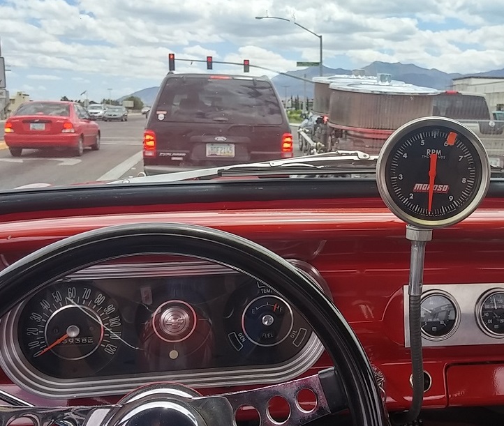

  25. Is that tach on a selfie stick?
  26. squirrel
    Joined: Sep 23, 2004
    Posts: 59,180
    squirrel
    no, it's mounted to a bracket that is attached to the dash with a few self tapping screws. The old Jones-Motrola tachs are interesting...
  27. snoc653
    Posts: 982
    snoc653
    from Iowa
    I think I will have to move the steering box to clear the engine and exhaust. If so I will need something with joints and possibly a rag joint. Speedway has a 2 inch column with just tilt and turn for a reasonable price. Then any co-driver would be somewhat able to be comfortable also.
    I put it on the dash to see how it looks. Definitely won’t see the carbs with the monster tach. So I would have to bring the gauges inside for boost and fuel pressure. If I put a second pod just to the left of the tach it will still look balanced. Or maybe just boost inside as I’d rather have a mechanical fuel pressure gauge. 8500 is the most I plan to spin it so this should be close to the orientation.
