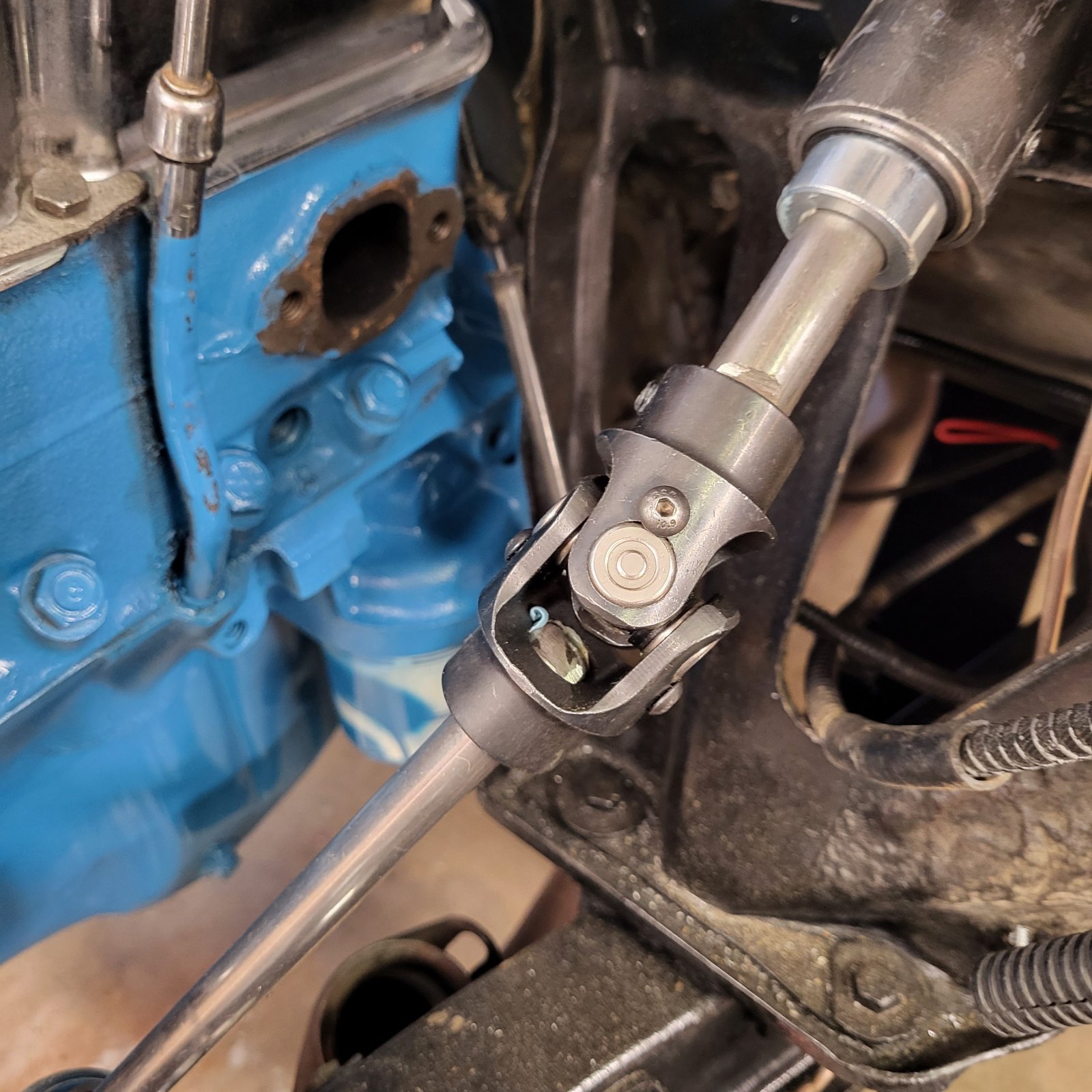

    CEF91294-3DE6-468F-A471-F33993D1D4D2.jpeg Hey guys.
    Some of you know that Im doing a v8 swap in my 51 styleline. Everything has been easy so far, but now i have come up to a bit of an issue.
    I knew of the manifold issues. Its a tight fit but now i have a issue with the gear shifter(automatic, colum shift)
    When in drive and reverse, theres no chance in hell any manifold will fit. Way to tight.
    So Im thinkin the only way is to move up the gear bracket on the steering colum tube, and shorten the gear rod.
    Anybody had this problem?

    The pic over is when its in drive. You see its tight. Theres no chance without moving the gear longer up towards the firewall. That should be easy enough.

    Looks like your shifter is closer to the firewall also. Mine is further down on the steering tube.

    I think i can move mine up, and shorten the rod. The shifter is just bolted to the steering tube. So that must work.
