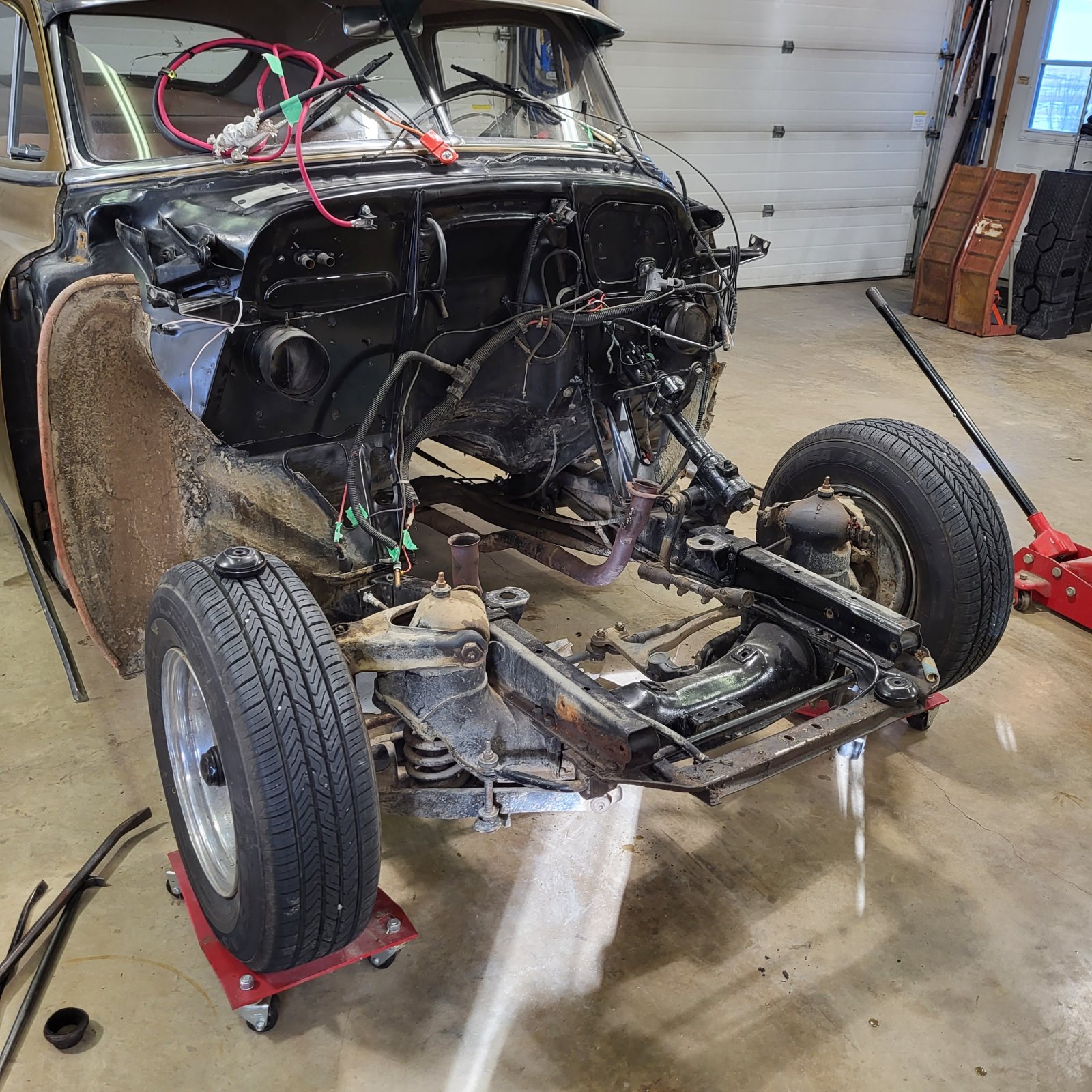

    so your car has a rack and pinion steering and an aftermarket column? are you sure that you are comparing apples to apples here?

    I have been running with that manifold since the early 90’s with no problems. These pictures might help you visualize how the exhaust needs a little jog built into it to provide drag link clearance at full lock. 3936F6D6-6BAB-40B2-BB7F-37056658911C.jpeg 3DC2B389-FEBF-4C0B-8703-963BF5AA08E3.jpeg

  3. 51pontiac
    Joined: Jun 12, 2009
    Posts: 518
    51pontiac
    from Alberta
    It was completely stock front end, steering and brakes with that manifold until this year. It is actually the factory column cut down to work with the off topic stuff.

  4. LarsL
    Joined: Sep 28, 2012
    Posts: 352
    LarsL
    from Norway
    This is much help. Everything else fits good. Just the gear shifter that needs moved up the colum tube.
    Im shure most people think that this manifold will sound bad and such but more important to make everything fit than move over the engine and such.

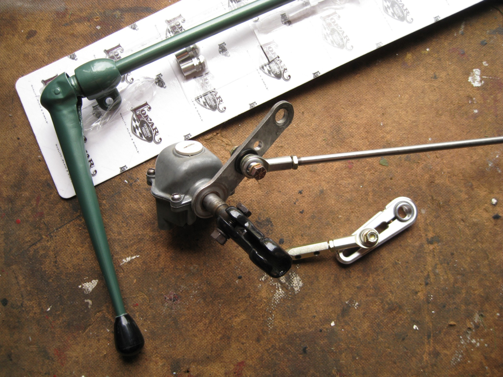

  7. Acres
    Joined: Dec 19, 2021
    Posts: 1,569
    Acres
    from Sweden
    I modified the shifter box like some previous, locked it inside so it only one arm works, removed the other, on the photo i havent cut the arm yet but before I mouned it i cut it, otherwise it bumped against the head.
    Bought a adjustable shifter linkage from lokar, easy fix and works like a charm

  8. Budget36
    Joined: Nov 29, 2014
    Posts: 15,447
    Budget36
    May not be the look you want, but how about a floor shift selector with a cable?
  9. LarsL

    I like to keep the colum shift handle.

  17. samurai mike
    Joined: Feb 24, 2009
    Posts: 560
    samurai mike
    I did it a little different, I IMG_0331 (1).JPG IMG_0326 (1).JPG cut off the stock arm and made a new one on the drivers side of the column. i used a ford windstar shift cable and made custom brackets to hold it top and bottom. i also used an old header flange to space the manifold out to clear the dipstick.
