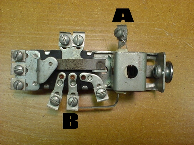

  4. I'm glad I asked because there is not tag on the backside of the gauge. I attached a picture of the switch and wiring diagram. That switch is of another one I found online, but the only difference with mine is that mine only has one connection at the back of it.

    Headlight switch-not sure why you would have 2 dimmer powers, I would think you would have a headlight power, taillight power and dimmer power. That older switch should only have one power feed, newer switches separate the headlight feed (non fused)from everything else (fused). Your head light power wire should go to the original power terminal (Bat) on the switch, tail and park to tail and park. The high and low beam wires should go to dimmer switch, I assume one of the dimmer power will go to the dimmer also (usually the center terminal). Ignore the stop and dome terminals on switch, that's where the power came from originally for those, should be fed from the rebel harness now. You should have a wire in the harness to feed the instrument lights somewhere (sometimes gray?).

    Sorry I know this thread is old but I'm facing a similer problem bit with the EZ WIRING harness. Most of it makes sence but at what terminal on the stock Chevy switch do you actually hook up the actual headlights?

    You must remember that the DIMMER switch is what actually feeds either the LOW or HIGH beam filaments of the headlights. NOTE the terminal on the HEADLIGHT switch (marked: DIMMER SWITCH) that feeds power to the DIMMER switch. DD

    Ah I see Thanks for clearing that up, do the other second wire marked "dimmer" goes to the floor mounts high beam/low beam switch
