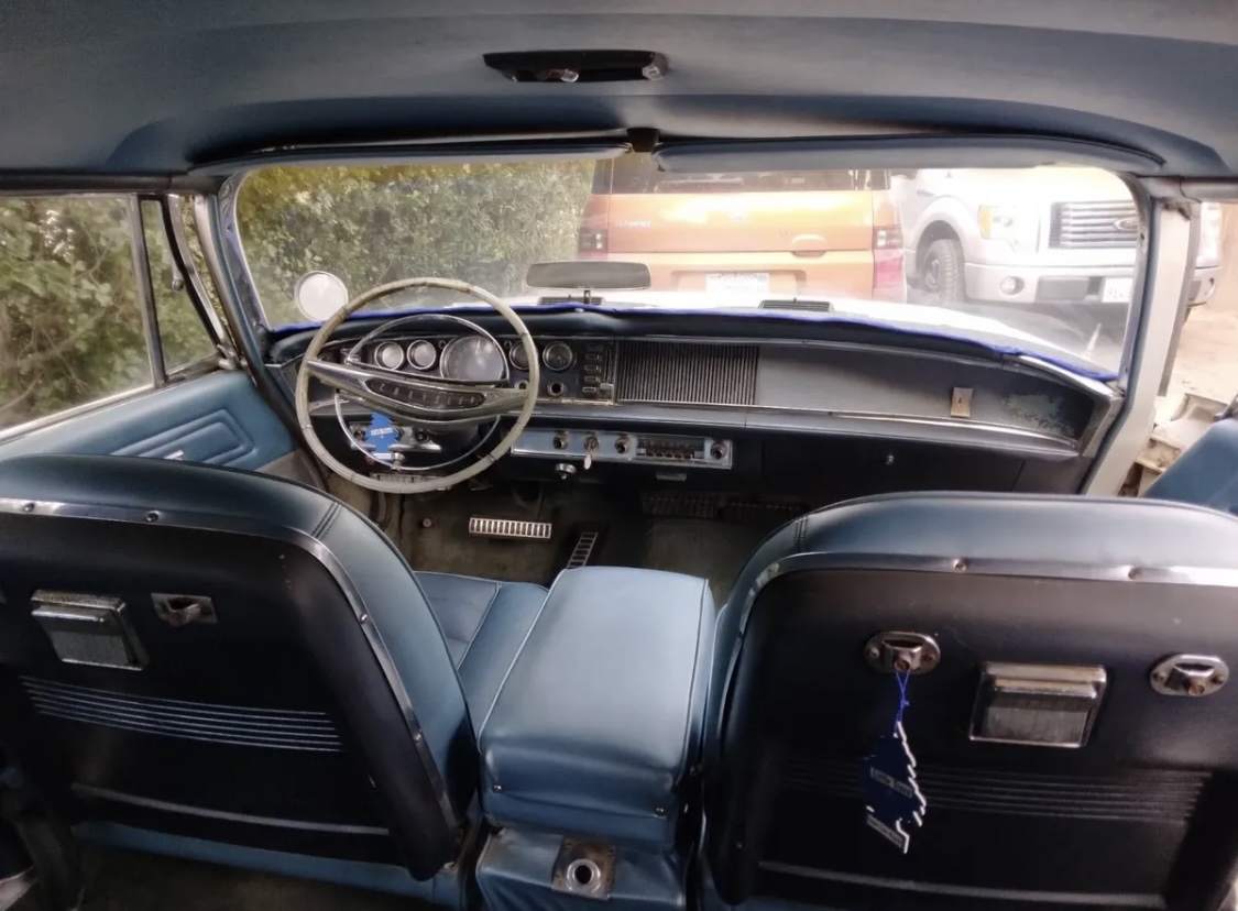

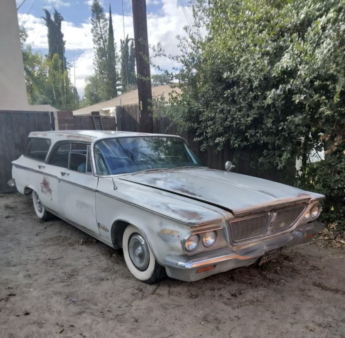

    driprail

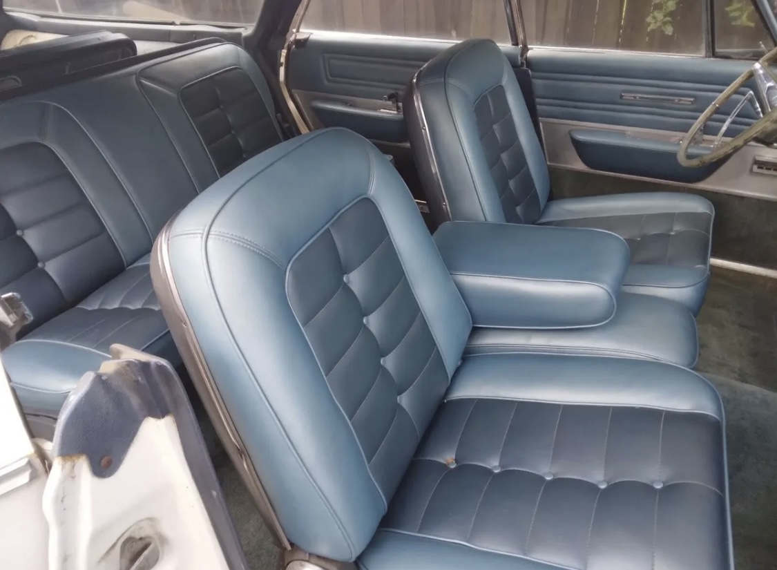

    ‘64 New Yorker
    Stogy and chryslerfan55 like this.
  4. 57 Fargo
    Joined: Jan 22, 2012
    Posts: 6,456
    57 Fargo
    Nice! I would love one to go with my ‘64 ragtop

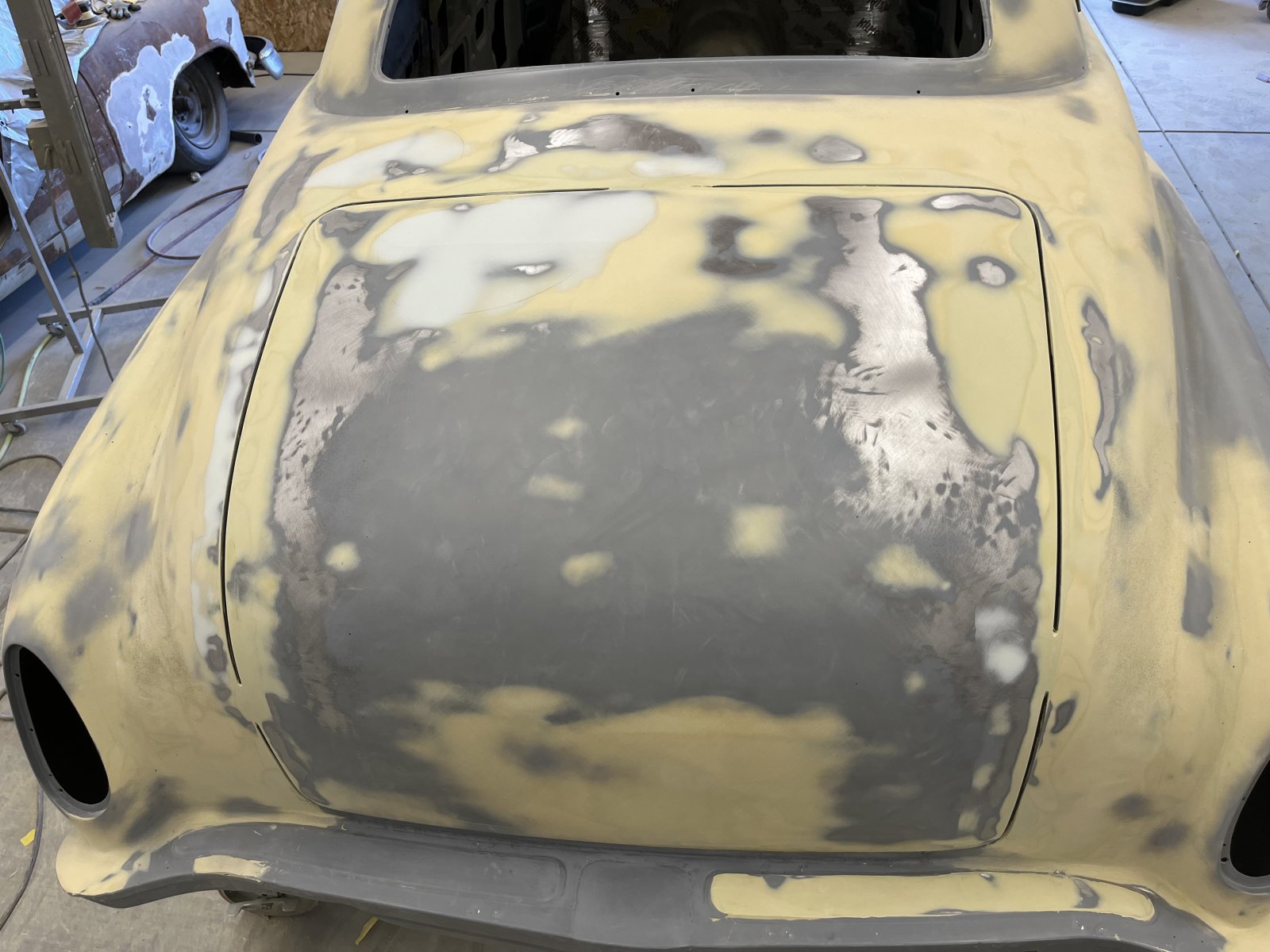

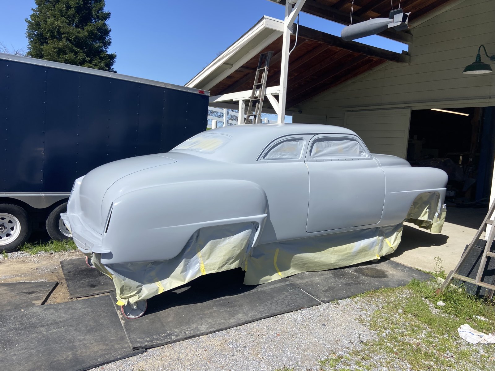

    Didn’t think I’d see any color on the car for another few months but now I know what it’d look like if I painted it pale yellow!
    Finishing a few large areas then time to do the jambs. After that I’ll hang the doors, trunk, and hood and address any panel to panel corrections. In for a penny, in for a pound at this point.

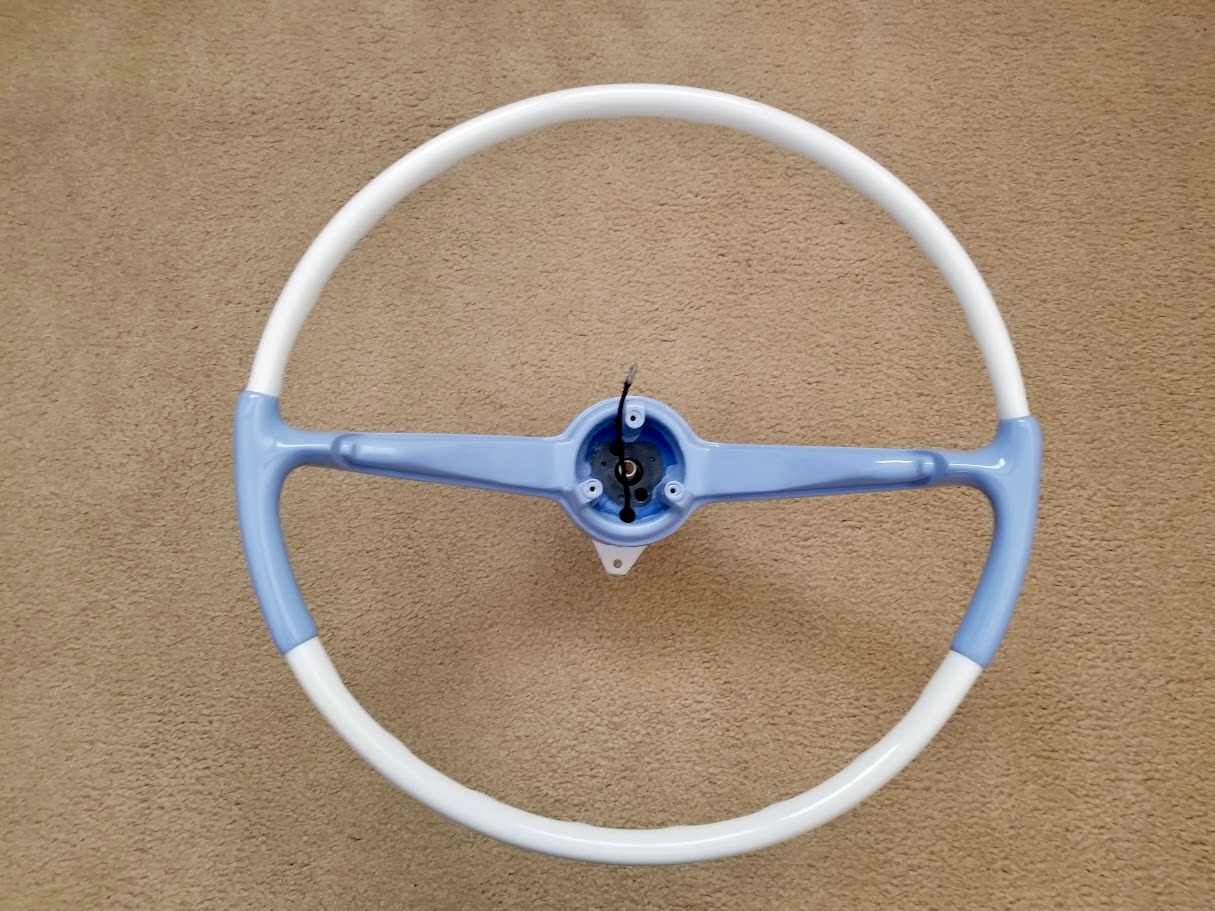

  12. driprail
    Joined: Oct 25, 2018
    Posts: 166
    driprail

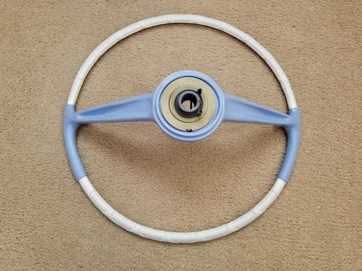

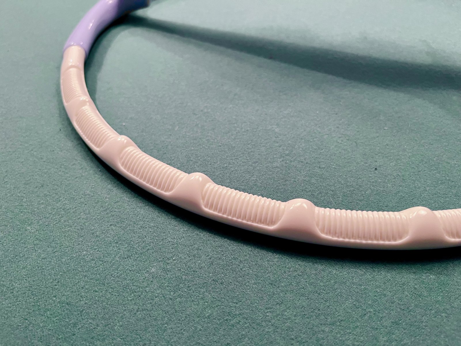

    Had some issues with the wheel I got from Kochs. They refunded me with no question which was nice. Ended up sending it out to Dennis at Quality Restorations and blown away at the quality.

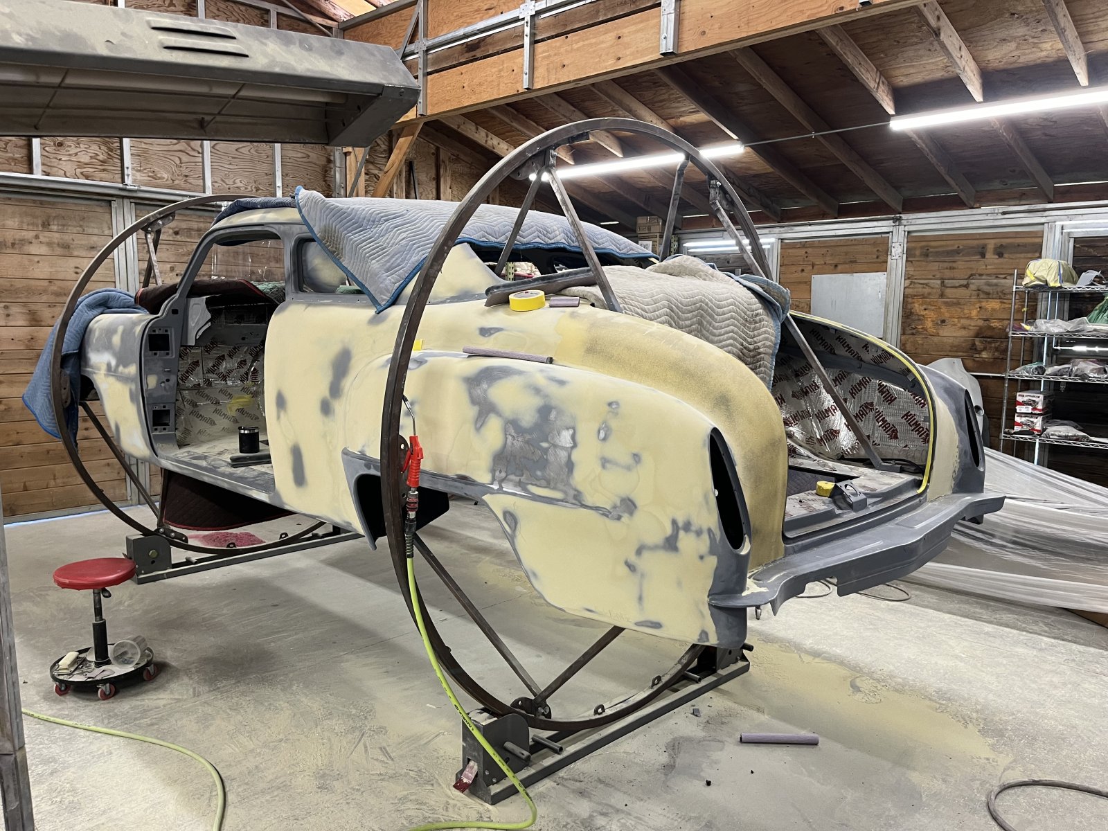

    Officially off the rotisserie. It’s been over 40 years since my dad has taken a car through complete body and paint. I’ve never done it. Been awesome working side by side over the last 3 months and learning the ropes. Still a ways to go but a big milestone.

    Posts: 19,042
    Squablow
    I agree, that is spectacular detail/workmanship on that steering wheel! I don't even want to know what that cost, but the finished product is beautiful.

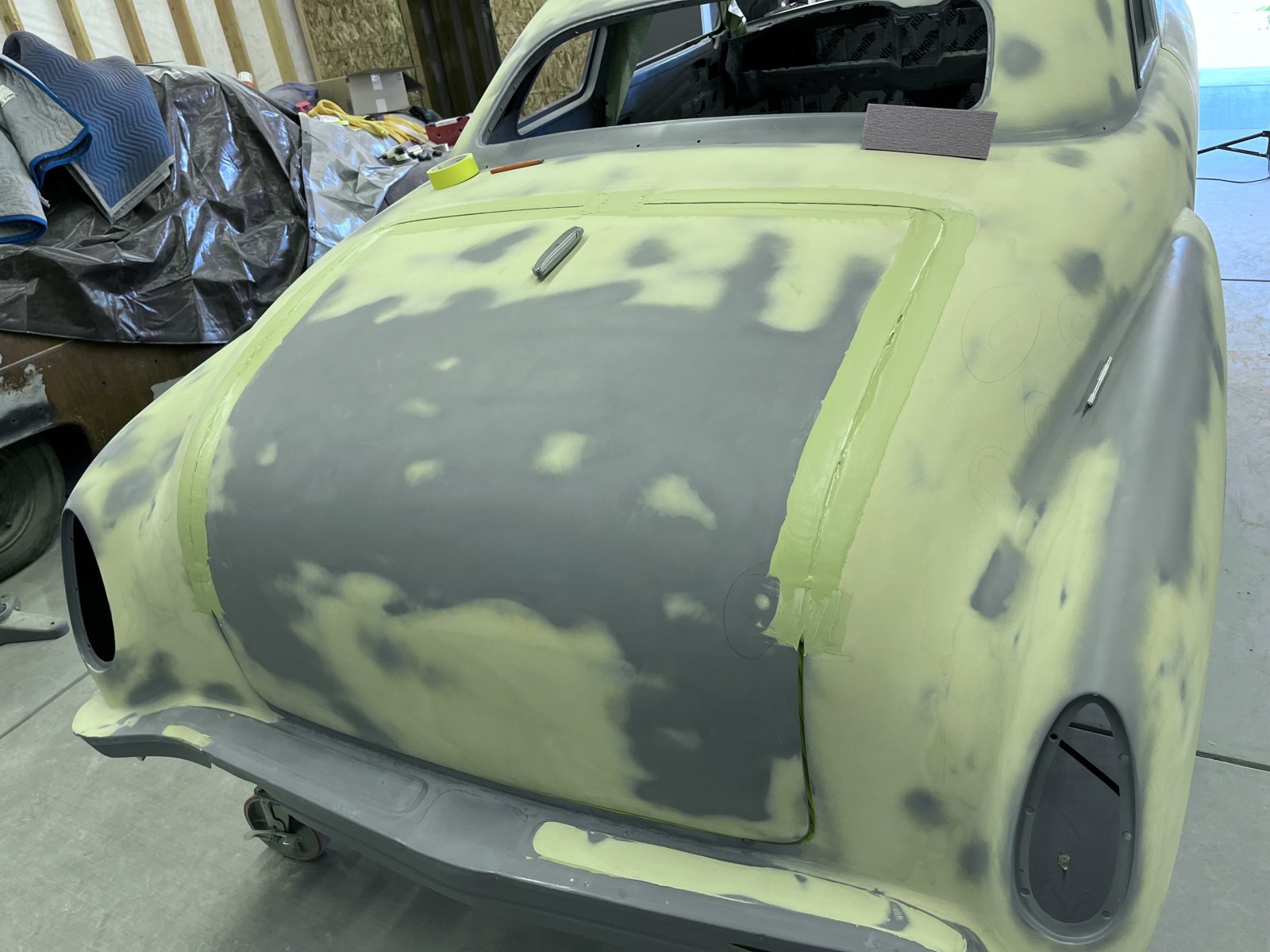

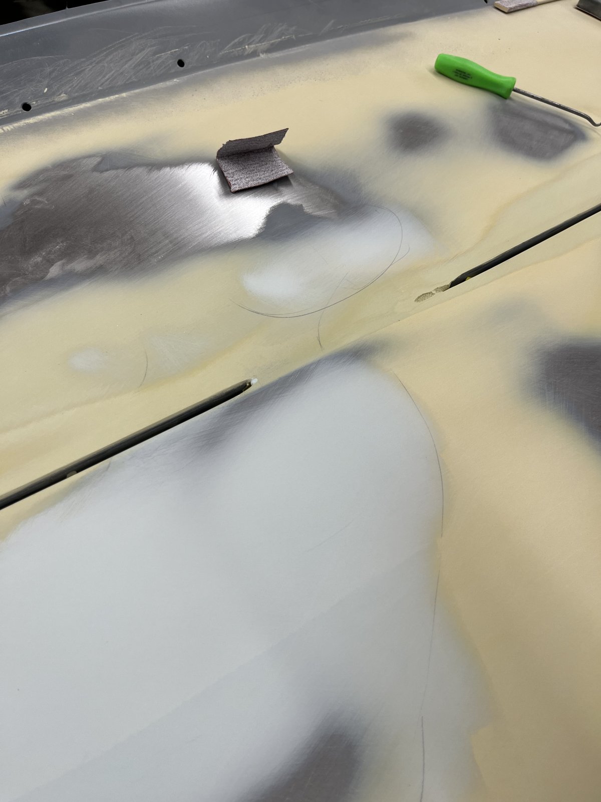

  22. driprail
    Posts: 166
    driprail

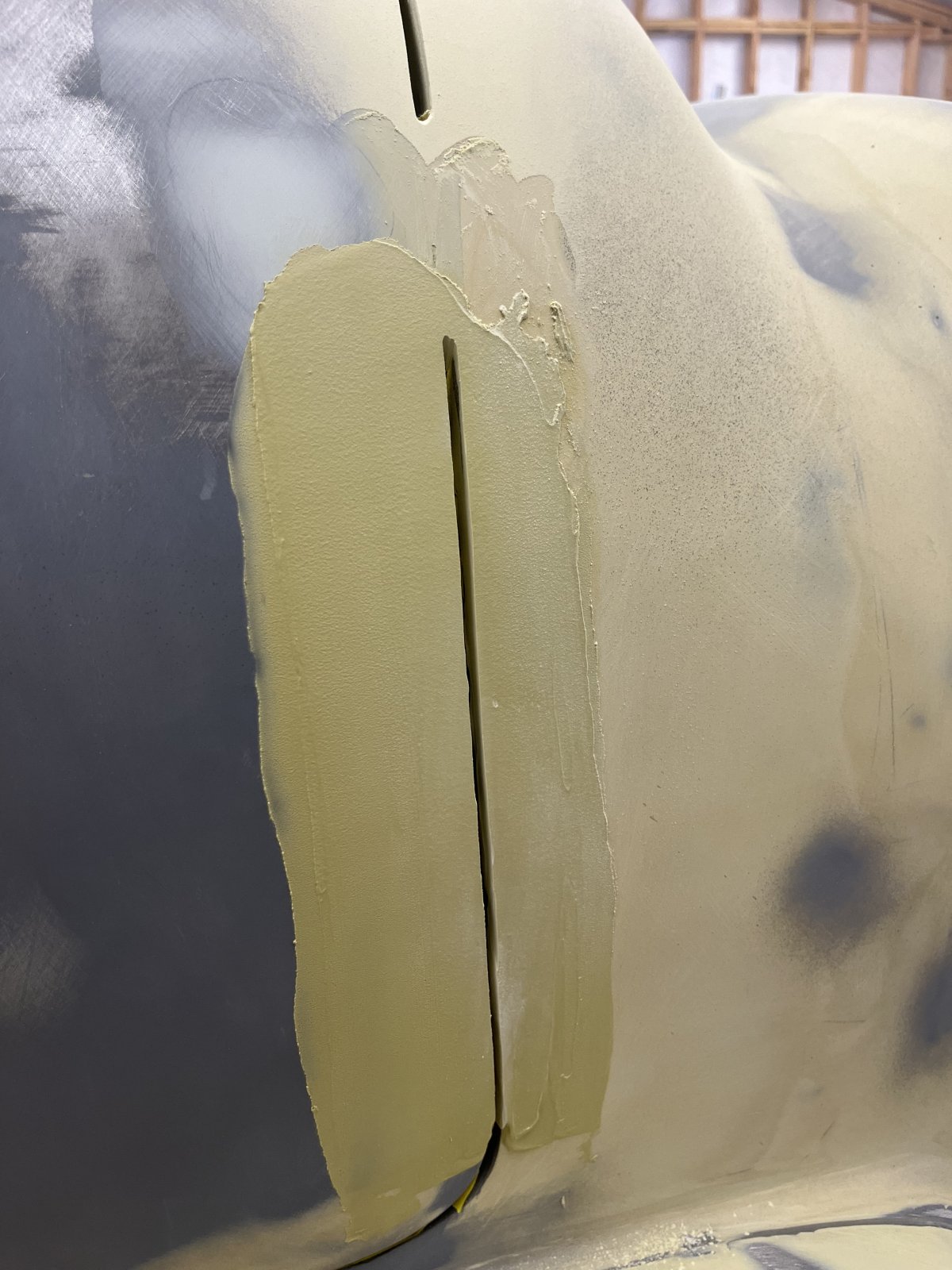

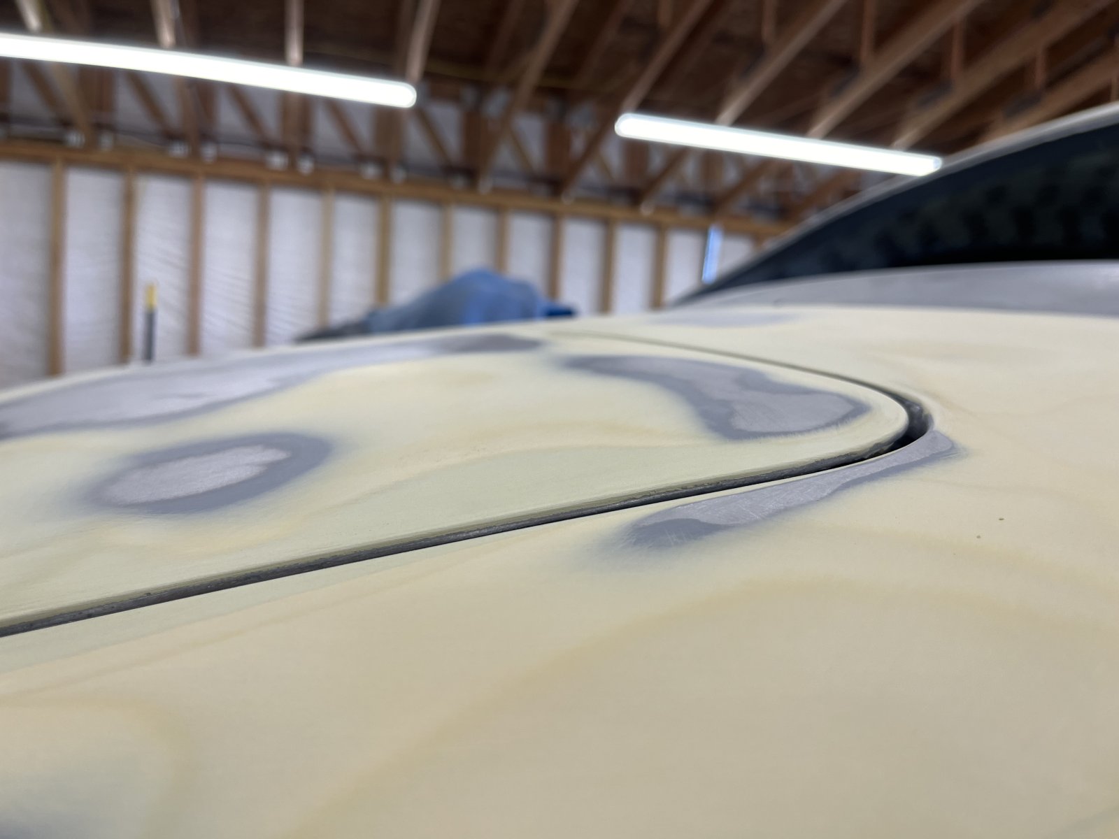

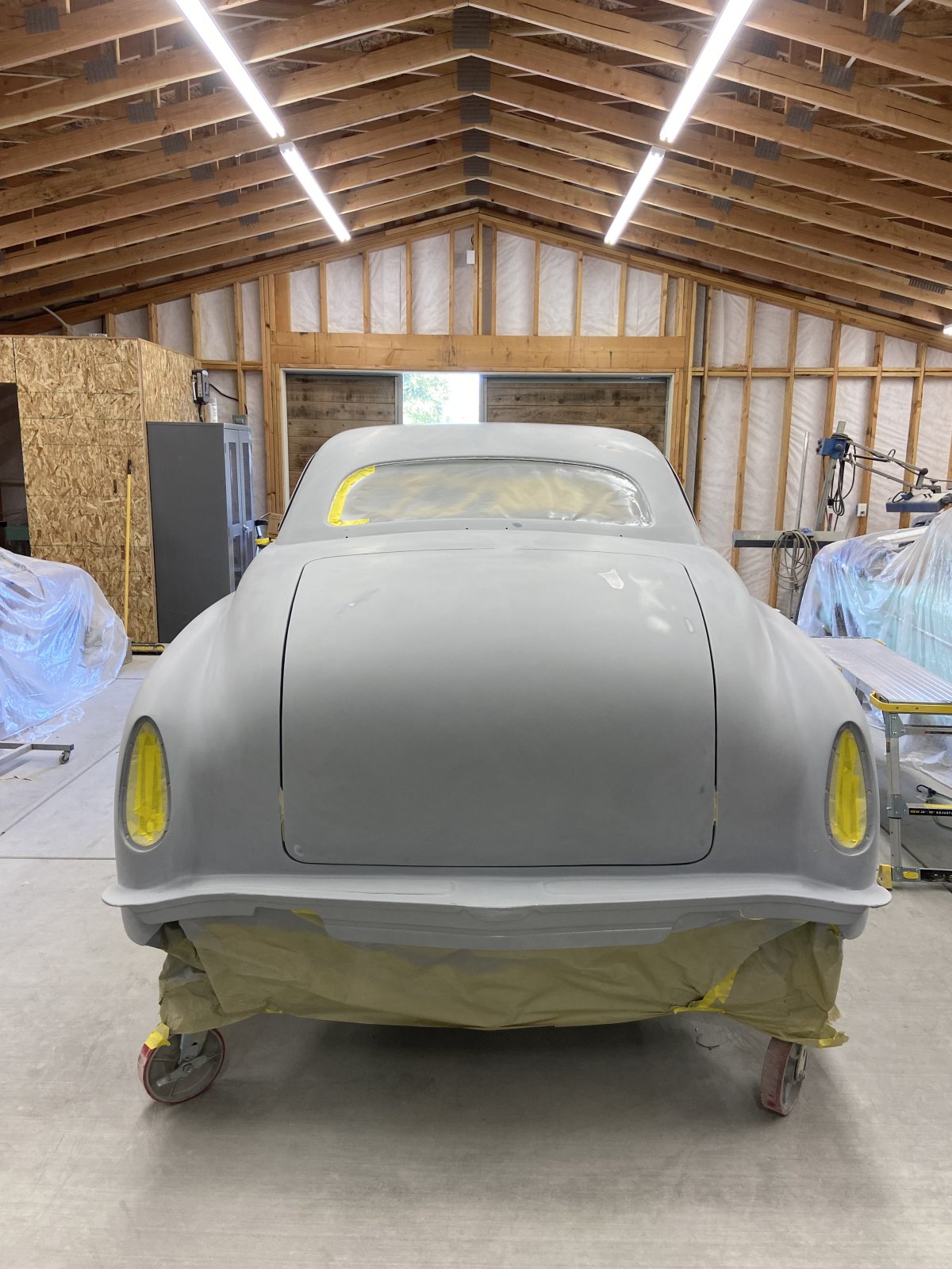

    Spent the weekend dialing in the transition from the trunk to the body so it’s flat panel to panel. Added some weather strip and adjusted the latch to get it where it sat right.
    Tried a trick I saw online. Mask off the trunk gutter. Squeeze some filler between the body and trunk on each side. This will hold it rigid when blocking across panels.
    After it’s dry, smear across the transition. Wait until it dries and cut out the filler in the gap with a small grinder. A lot of filler gets wasted squeezed into the gaps unfortunately but oh well. Use a long block across the panels to get it even and if I did it right it should transition nice.

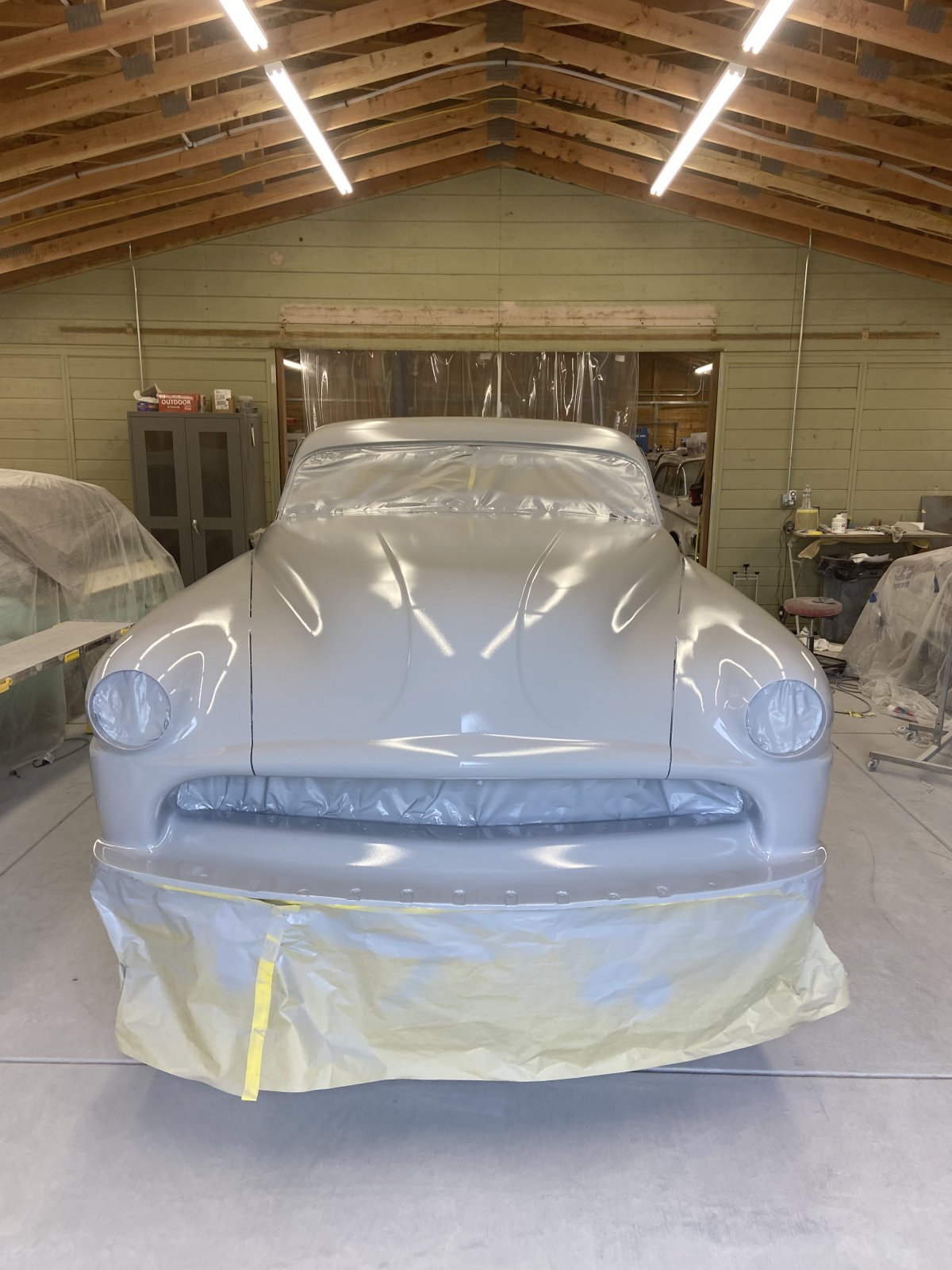

  23. driprail
    Posts: 166
    driprail

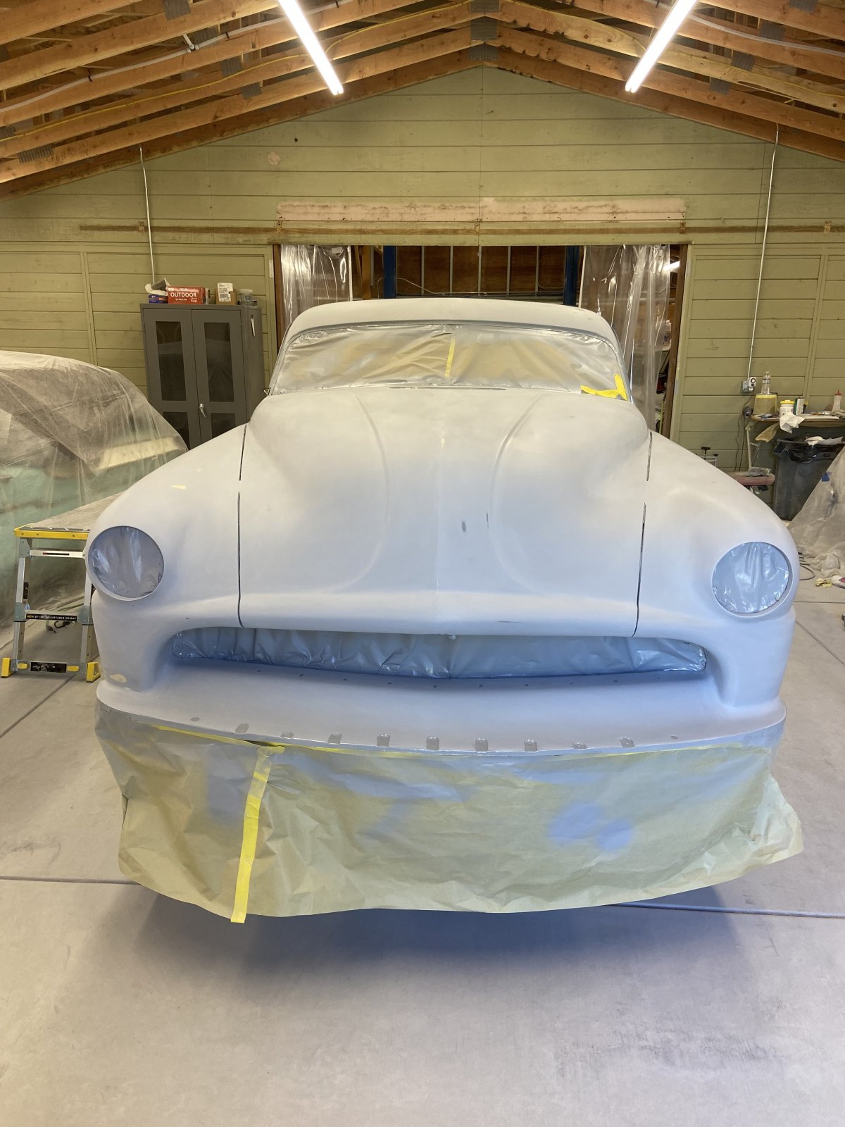

    Officially in high build epoxy.

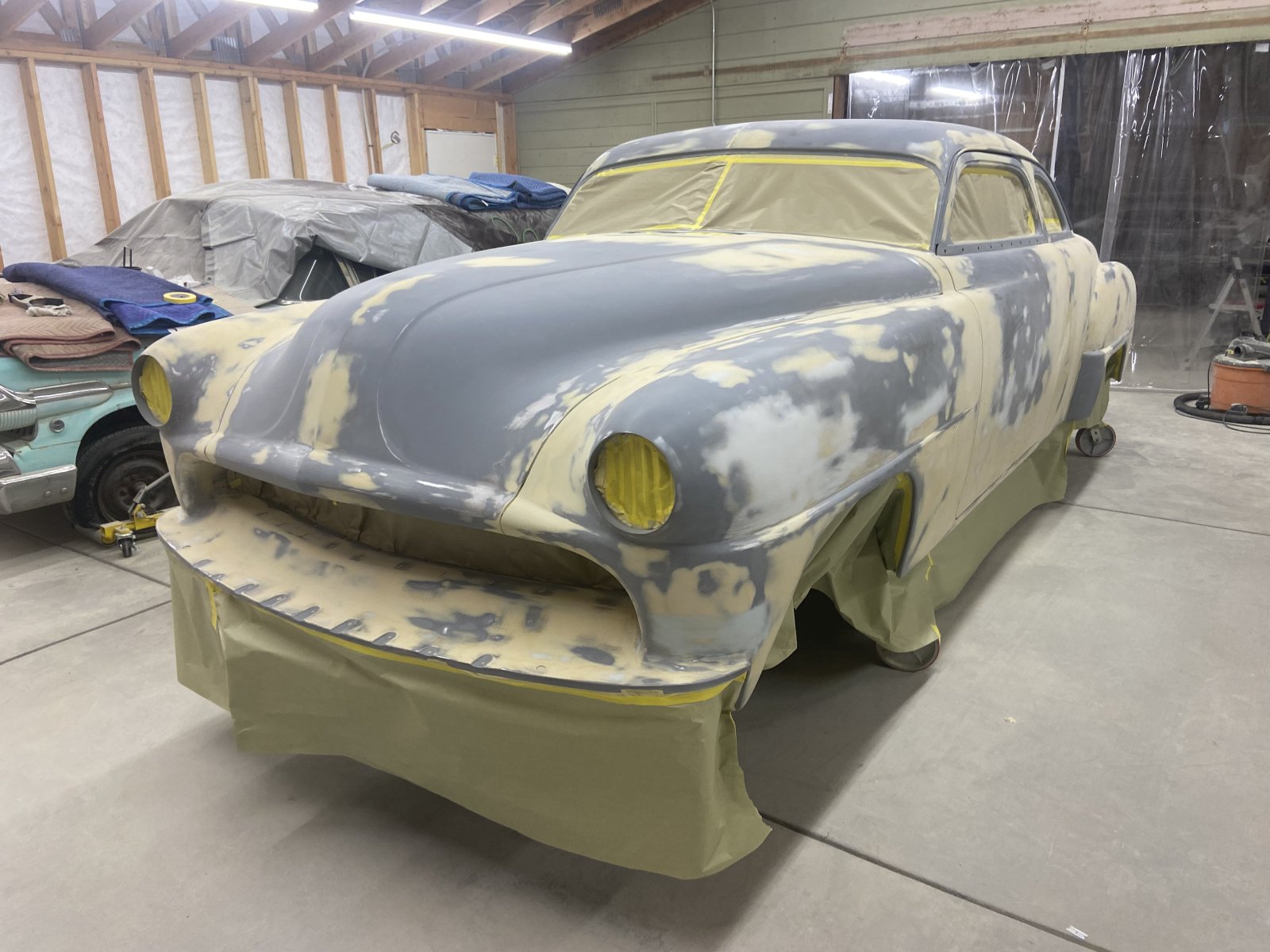

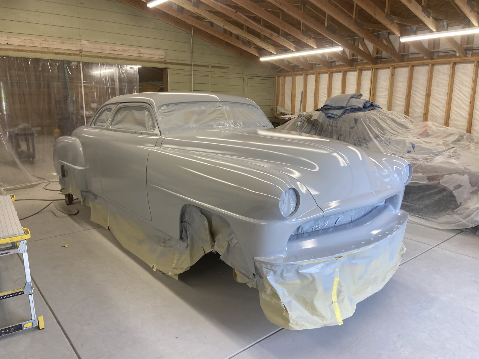

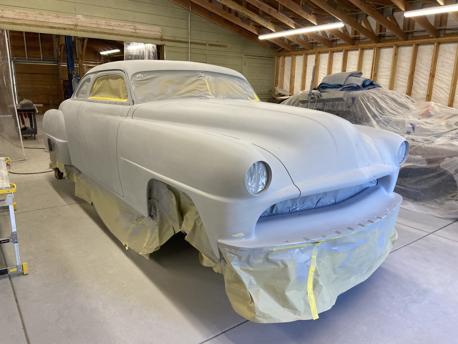

  25. driprail
    Posts: 166
    driprail

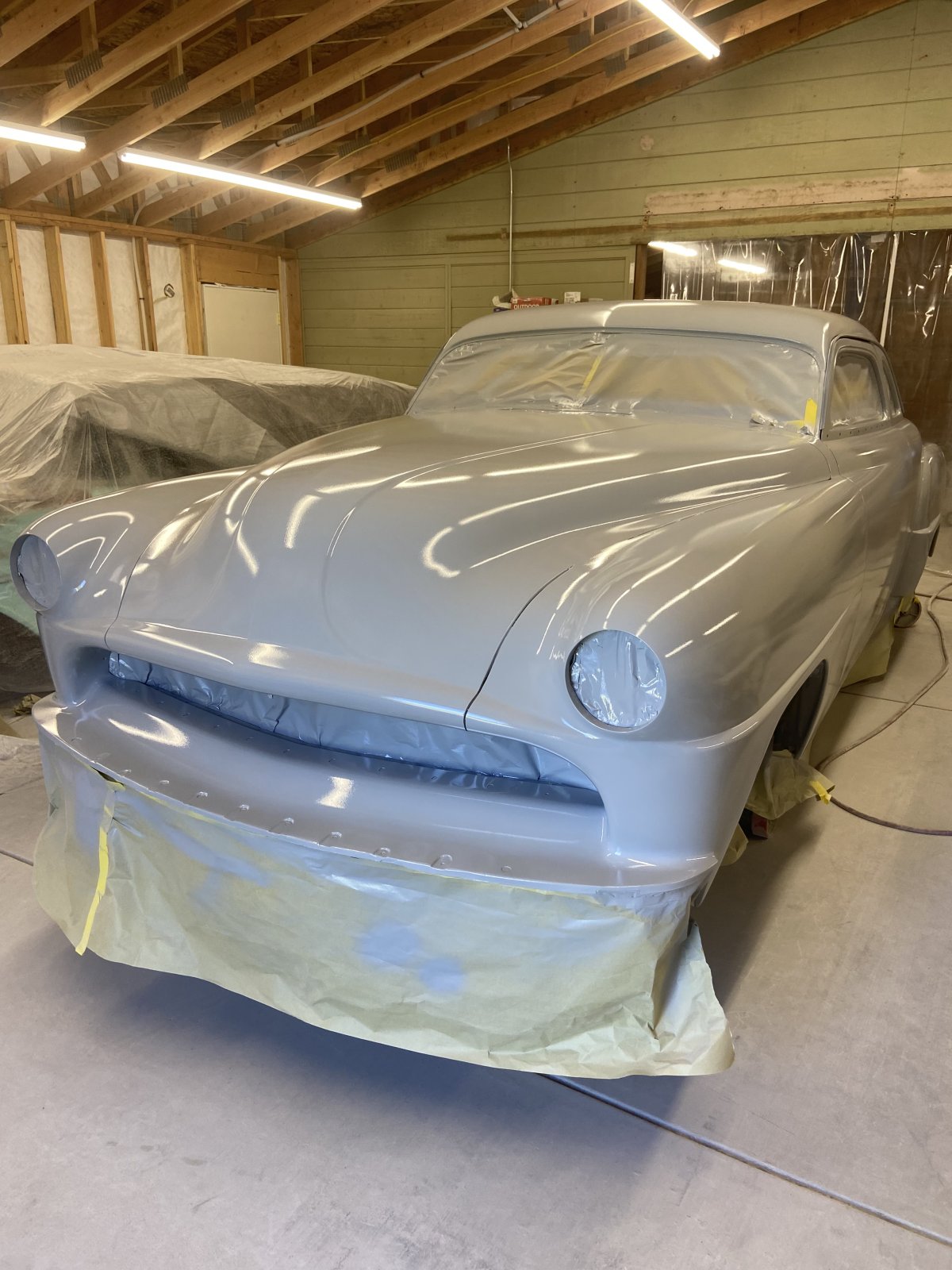

    Blocked to 220. Sealed. Time for 400 dry then wet sand to 600.
    IMG_0367.jpeg IMG_0366.jpeg IMG_0365.jpeg IMG_0370.jpeg IMG_0369.jpeg IMG_0368.jpeg
