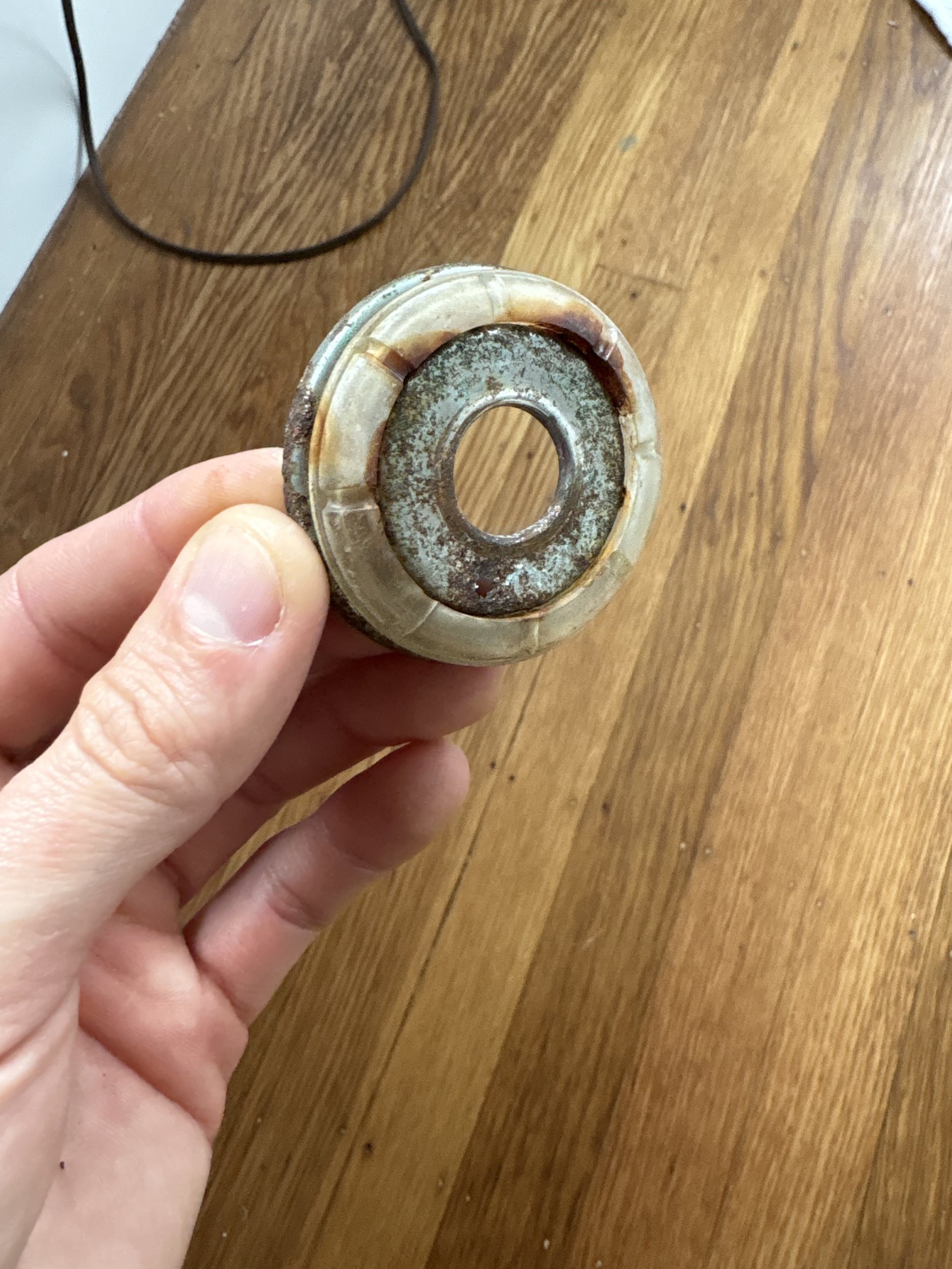

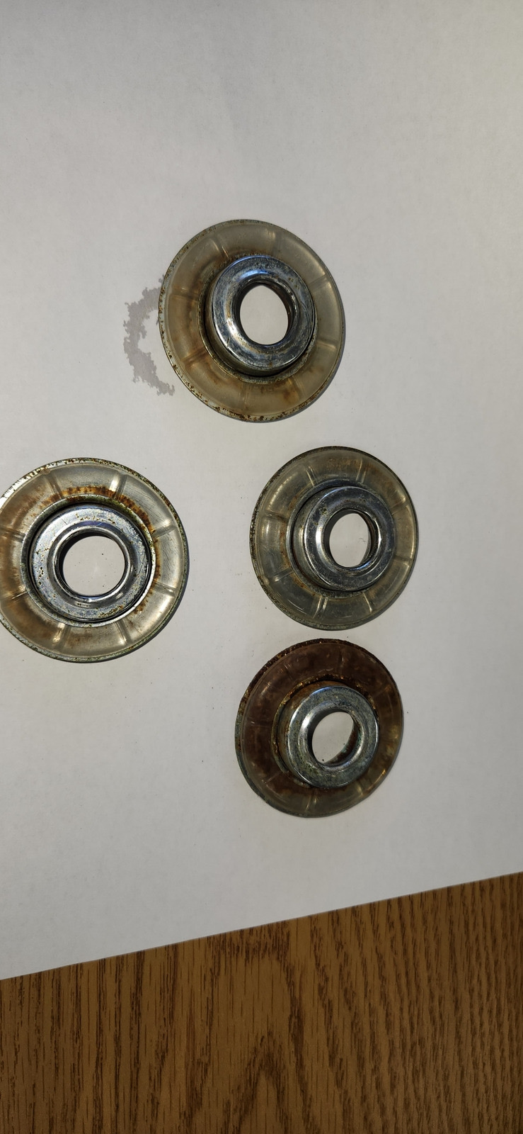

    Any neat ideas on what to replace these old Bakelite trim pieces with on the estechueons? I’m going to chrome the bases but wonder if there’s something off the shelf that could look cool o_O

    mother of pearl discs cut out w/ 2 hole saws!

    Thanks for the tips, but I bought some of these repop ones a while back and they only work around the window cranks. Desoto used 2 different kinds. The ones with the spikes that stick in the trim panel for the window cranks and the ones around the door handle were spring loaded and press in to a hole in the molding.

    awesome idea, never would have thought of that!

    use a piece of wood for a backer-cut small hole first then larger saw and the pilot bit will go right back in the right place in the backer to cut the 'doughnut'

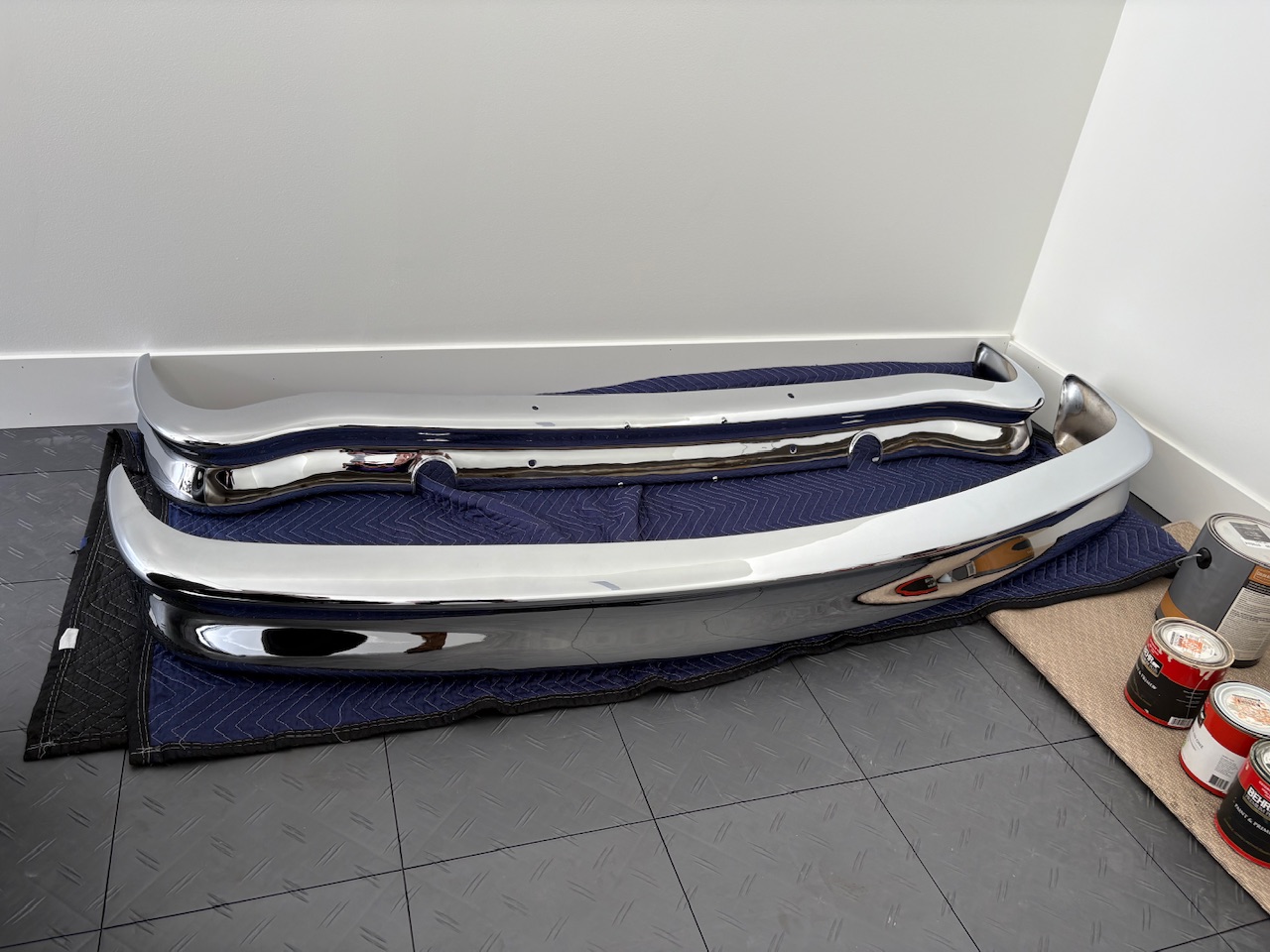

    Checking in with the upholstery shop in a few weeks. Got some big shiny bits back in the meantime

    Luxurious lookin' chrome! That rear bumper is a work of art!!

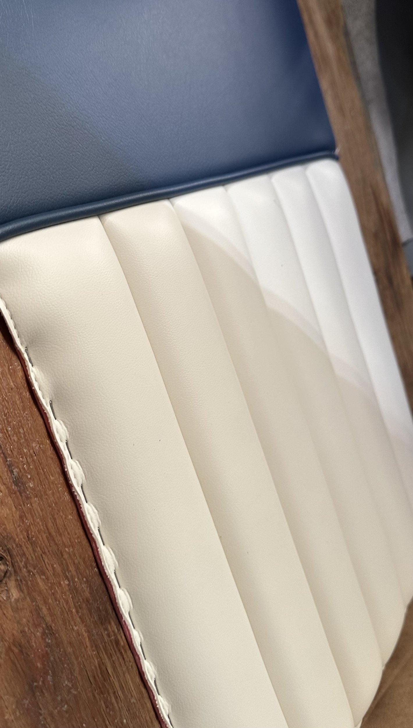

    Upholstery shop making good progress. They did a couple test pleats so we could find a good size. I want them to be rounder and taller than some of the flatter modern pleats I’ve seen. Like stuff you would have seen on cars back in the 50s.
