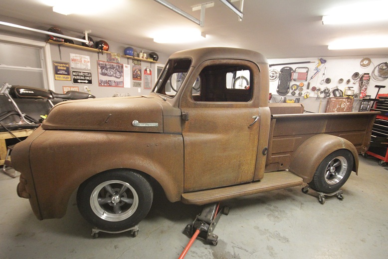

Customs 51' Fargo Dodge on Dakota frame(boxing crossmember frame help)

    Looks like a fun build! Welcome from the other end of the province!

    Very nice build you have going! You stole that Dakota for $750. Great basis.

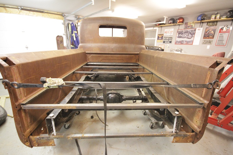

    Can the cross member above the rear axle be turned upside down & moved inside the frame for more bed clearance? From pic 1 on post 23 it seems possible but not certain.

    Yah I looked at that... if i wanted the floor as low as possible i could space the ribs so the crossmember was between them. should clear fine. Haven t decided if I'm going on that body line for simplicity or gaining another 3 inches and notching around the wheel wells and box stamping.

    If it was me I'd move all bracing to inside or under the frame and rest the wood on the frame, or close. If its to be used as a truck I'd want to maximize the bed space.
    Actually if it was mine I might try to get the kick-up out of the frame, and run tall skinny truck tires, but I have weird taste that way. I like the stock ride height.

    yes i know what you mean... I'm really struggling with that desicion right now.. a cleaner bed floor mounted higher or a more usable bed. I'm trying to figure out how to make it look clean or done well to my abililty

    You can trim the hump off the frame, modify the crossmembers, and move the angles lower on the box sides, to get the floor lower. Whatever you do, you want some floor support if you plan on hauling anything, and if you mount the floor directly on the frame, after a very short time, the squawks and other funky noises from the metal rubbing against itself will decrease the driving fun. When these things are rolling down the road, lots of stuff moves around. Build accordingly or the unpleasant noises will come, or at least they do in my world. Gene

    If you can somehow shave about 2-1/2" or so off the frame hump, then box that portion and also reinforce it with a crossmember or two near that point, that might do the trick. You'd still have frame strength without the risk of bending in that area.

    Well I decided to plant the bed floor where I originally planned. there was a major deflection in the bed sides at the top of the fender. putting the floor frame lower would not take it out. Atleast blocking it there wouldn't.
    I'm not going to use it as a truck very much and I'm ok with the space I have.

    Just curious, how much would you have to raise the body to get a stock ride height & stock bed height? Looks like about 5-6 inches?

    In order to maximize space at this point, I think I'd plan a false floor towards the front of the bed, maybe with a door built into the floor to access it, and mount a tool box in there. Also, to combat the visual weirdness when you open the tailgate, you could build a drawer into that space. Maybe mount a spare up under the bed ahead of it, and keep a jack and lug wrench in the drawer? As a carpenter, I am sure you could make all that look nice, and it would save a good deal of useable bed space too.

    Yah, about that.. it would look sillyi think. the frame under the cab would be below the running boards. Good for some 35 in tires or something. haha

    Funny.. a friend of mine mentioned the same thing... I think its a great idea. Great to hide away tools, a cooler, or whatever.
