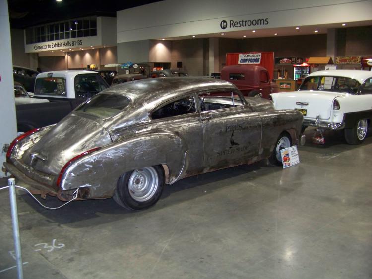

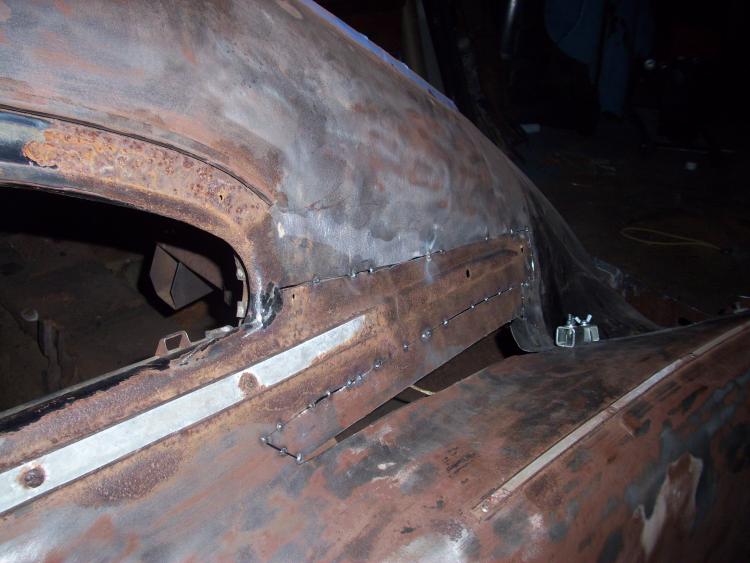

  7. godspeedbear
    Joined: Sep 21, 2009
    Posts: 261
    godspeedbear
    from golden
    HOw many pics do you need?

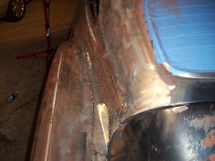

  11. godspeedbear
    Posts: 261
    godspeedbear
    from golden
    Relief cuts w/ no package tray

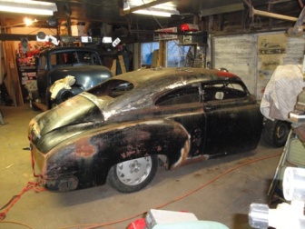

  12. Hdonlybob
    Joined: Feb 1, 2005
    Posts: 4,148
    Hdonlybob
    Here is a '49 I had a few years back. The chop (with '40 Ford rear window was done when I bought it). I did the doors/trunk etc....
    Body work was not compete yet, but this shows the roof lines....

  14. godspeedbear
    Posts: 261
    godspeedbear
    from golden
    Yea, I've seen them done that way...
    I clam shelled the deck lid and think that the lines come out better.
    Both ways work, just alot less metal work cuttin through the trunk.

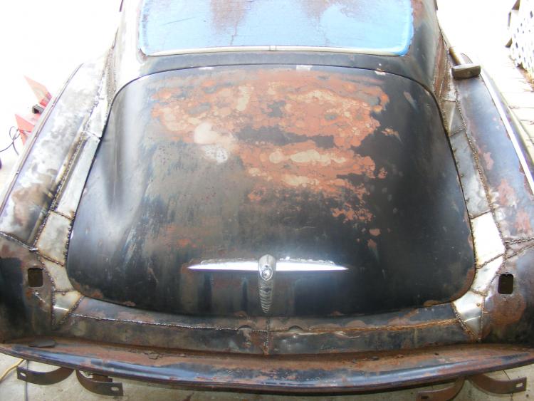

  15. 90ssp
    Joined: Jan 3, 2009
    Posts: 398
    90ssp
    from dallas, ga

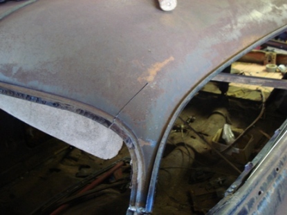

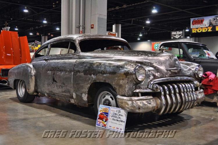

    The way I chopped mine I was able to do it without cutting the trunk and rear window. I did it this way because I wanted to keep the stock roof line. It's lowered 3.5 inches in the front and about 5 inches in the rear.
  16. 90ssp
    Joined: Jan 3, 2009
    Posts: 398
    90ssp
    from dallas, ga
    i made a template out of cardboard that was 3.5 inches. I used it to draw my lines on the b-post and a-post. you actually take less out of the a-post. Then I followed the thread that stickylifter did for the rear. I spot welded the trunk closed and i made the cuts to the c-post and cut one inch around the trunk. I was then able to lower the entire roof and trunk at the same time. You have to cut the braces loose inside also.

  18. godspeedbear
    Posts: 261
    godspeedbear
    from golden
    OkI see what your sayin. I retain the stock glass in mine too, just laid it flatter. I made fewer cuts through the body and if I meesed up the deck lid I could get another.
    Did you have to add metal back in on the upper quaters? How did you handle the transition from just under the quater window to the tail pan?
    That would be a great bit of info to post..

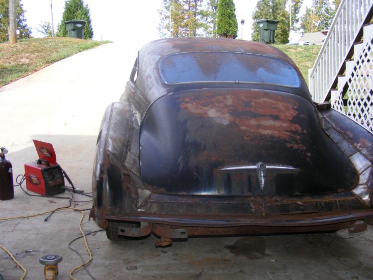

  19. 90ssp
    Joined: Jan 3, 2009
    Posts: 398
    90ssp
    from dallas, ga

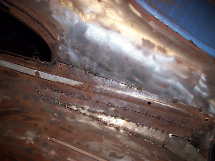

    Yup. I had to add more metal in. I wanted to keep the trim so I also had to cut around the trim mounting area and mold it back in. I bent the upper quarters to make them flow down to where the trunk now sets. The main issue was getting both sides to match
  20. 90ssp
    Joined: Jan 3, 2009
    Posts: 398
    90ssp
    from dallas, ga
    here are a few more. Its been fully welded and smoothed over now. Just need so minor hammer and dolly work to finish it off
