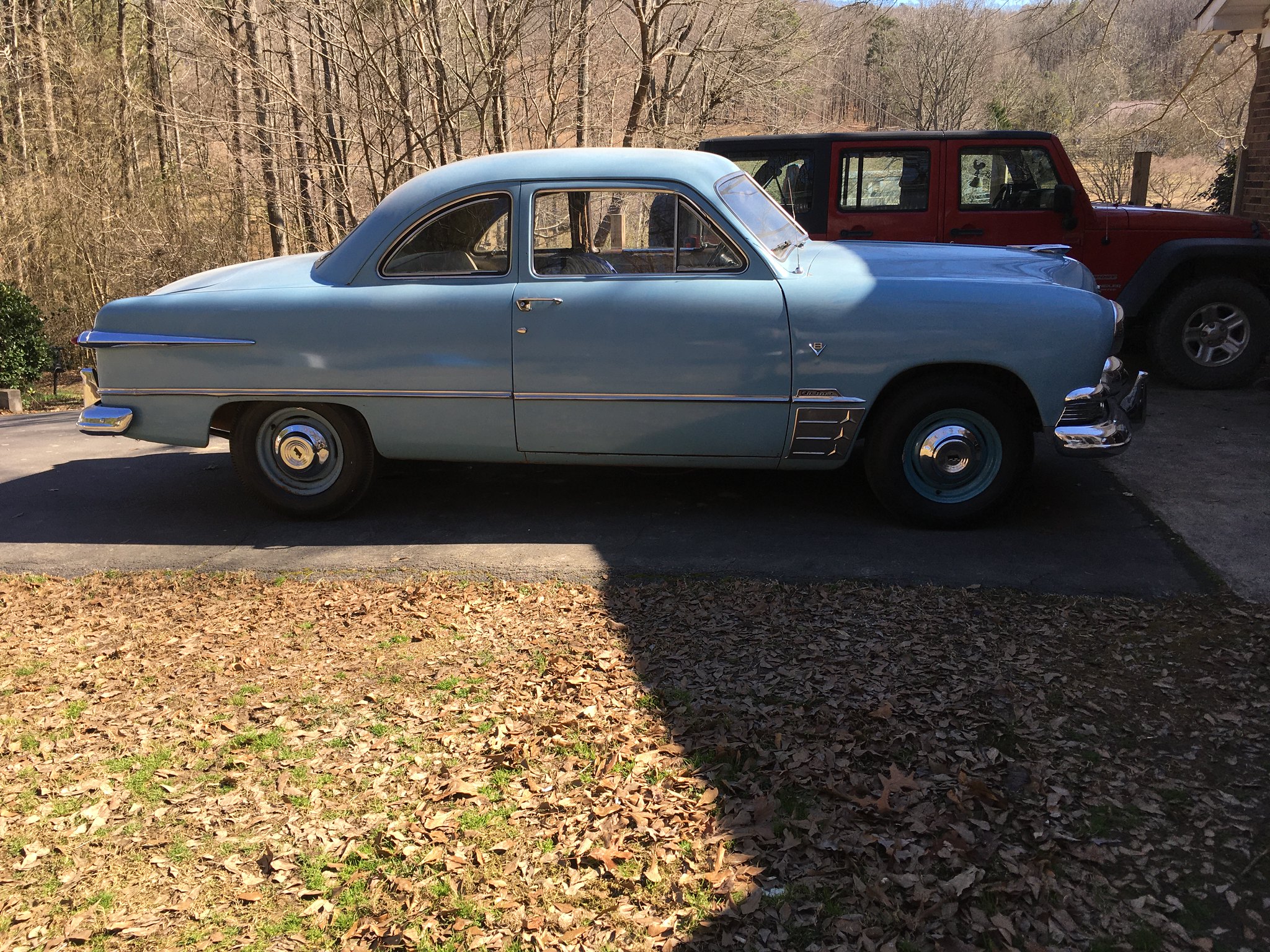

    Right now I'm painting with iodine and marking it duty. There's a lot of issues I'm going through one by one. I'm just about finished with the brakes. I have to do the final adjustments.
    The next big thing is the wiring harness.
    Then the rear axle.
    Then the front end.
    Eventually I want to start on souping it up some. I'm going to go a different route. I'm keeping the Loadamatic.
    Stage One...Mercury 4 bolt intake with snorkel top Holley 885 4 bolt 2bbl...
    Stage Two... Shaved stock heads or Merc heads, and a 4bbl intake with a 1955 Thunderbird Holley 4000. AKA the Teapot or the Towering Inferno.

    I hope I'm wrong, but did you just take it from a '50s/'60s teenagers dream of a mild custom BACK to a Grandma's stocker?
    F-ONE likes this.

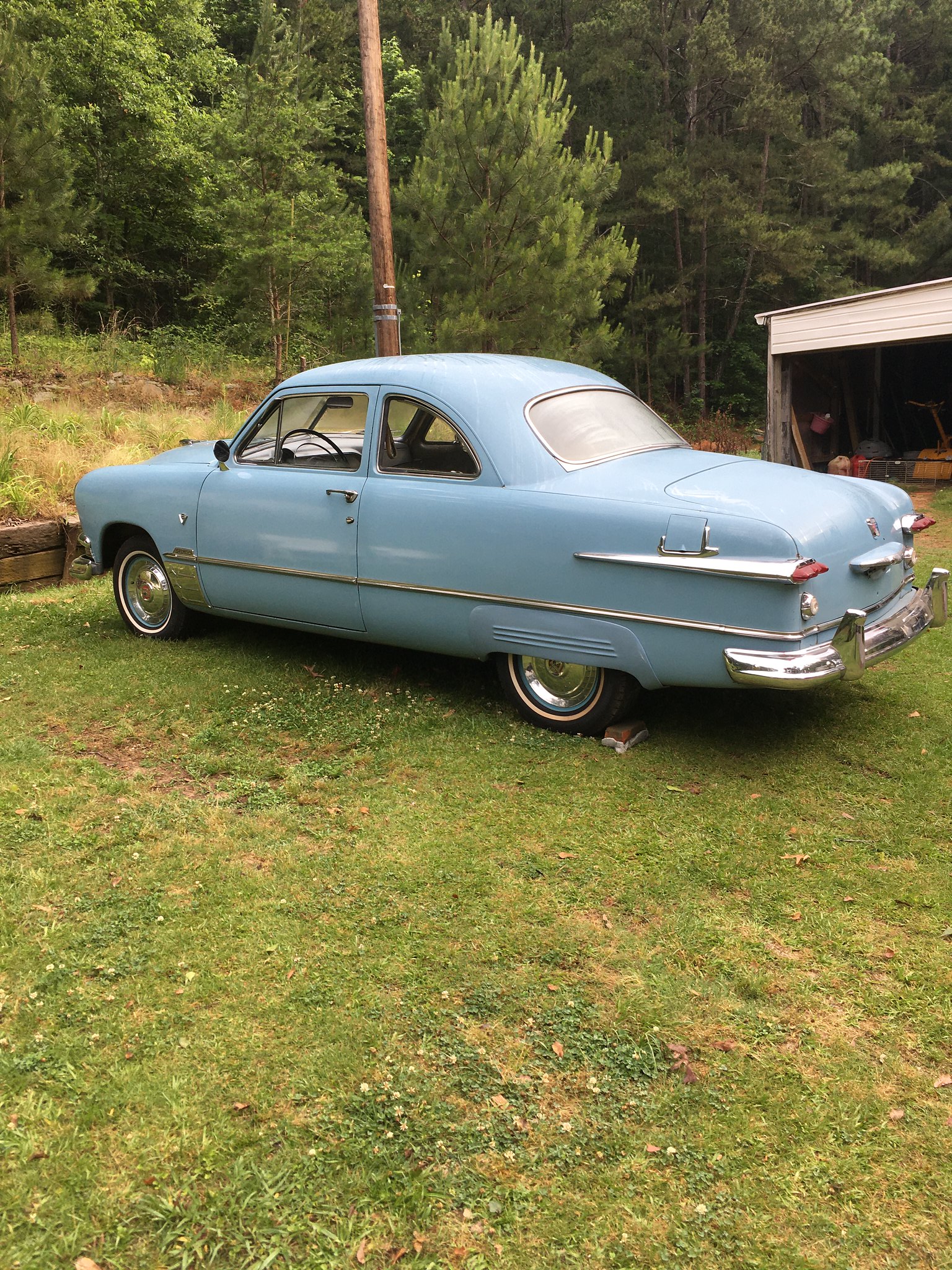

    That color is "Alpine Blue". My car has one "respray".
    [​IMG]Un***led by Travis Brown, on Flickr
    The respray on mine is a tad "Bluer" but then again the shade is very close and it's very possible that the remaining original painted faded to a slightly different shade. The oil change stickers on the door jamb is just something you can't buy. I guess you could put repros on there but it's not the same thing. The oldest writing I can read is 1962. Those stickers go plumb through to the 80s.
    The dash Harness is laying on the seat right now. I have not got around to installing it yet. I'm going to pull the seats and recover the seat bottoms. I don't know if I need to remove the dash. I've heard pros and cons either way. Right now I'm planning to lay in the floor and leave the dash in the car. How did you go about it?
    I'm keeping 6 volts so I decided to use an original type harness from Shoebox Central. It's a Bauer reproduction offered in pieces from different suppliers. It's the same price and is sometimes cheaper going through a supplier rather than ordering direct from Bauer. It depends on the supplier and the overstock. Since I'm keeping the 6 volt system and running the original gauges the replacement harness was a the best solution for me in my opinion. With signals, the '51 wiring is the most complex of the shoeboxes.....Man I love the sound of a Flathead starter on 6V!
    After the shakedown drive yesterday, the brakes are going to need more adjustment to bring the pedal up and it may need a few more bleeds. The E brake is working much much better and the back brakes are actually functioning now.
    The rear axle was practically dry and I filled it before the shakedown yesterday. I found out why. It leaks like a sieve out the pinion. There was a tiny amount of fluid slung on the rear tire but that may be brake fluid left on the rim from bleeding the brakes, we'll see.
    That real axle needs a pinion seal. Hopefully the axle seals are good. I do know worn bearings will cause the seals to fail. If it's bearings I may evaluate changing the rear axle.
    The front suspension seems fine. The car is very controllable at the speeds I've driven it so far, even with the new narrow Cokers. I would not say it's "tight" though. Setting the wheel bearings, I did notice some slight play in the king pins. I have to uncover all my Grease Zerks. I can't find them all. That front suspension is absolutely covered in a mix of grease and Tennessee Mountain Clay. There was so much old grease behind the front driver's axle that it looked like the axle joint ball on a Willys jeep. So...I've got a lot nasty work ahead just to remove the grease and find the zerks. Looks like it's going to be some hammer and chisel work. That's stuff it like set epoxy.
    Like rear axle. We'll see how the front shakes out.
    From the front seat forward it needs some floor work. The structure is very solid as is most of the sheet metal but it does have some soft spots. Here, do I patch or replace the front pans? I would prefer to patch.
    I have not even got to the performance stuff I would like to play with...
    I know this long but one last thought...
    I'm very fortunate to have a good solid car to bring back. The old car has always been kept up and one time it was a either Hot Rod or Whiskey Car. Even though it was not obvious, there has been a big OHV in the car. Likely a Lincoln or Ford Y block. Whatever it was there was clearance gained at the p***enger side fire wall....the location of Y block distributor. This may date back to the 6V days. So...1951-55. So have a really good base.
    My point is, it takes a lot of work, a heck of a lot work just to get a decent start road worthy. I see a lot of new guys who drag a really rough one home and they have lots of questions and plans. Most of it involves Bling and Strombergs.
    They have lot to do, maybe more than they can imagine. It's OK to plan and for the final result. With that said there's a lot of work to do before all the Ding Dongs and Hoo-Hahs...
    As you can see I have a pretty big punch list.

    A '51 was the most decorated of the Shoeboxes, lots of Chrome. This one has some more like the optional Stainless Triple Star Fender panel.
    Full wheel covers, skirts and whitewalls was just a little too gaudy for me.
    I like a very subdued Hot Rod. This was especially so on a Whiskey car, the less adverti*****t the better.
    A big inspiration starts for me at 1:55 in the video below. This, and the 3 Whiskey Cars (3-49-51 Fords) of Mr. Layfield, that my grandfather worked on in the 1950s
    You see this in later cars Like the 390 Interceptors, 406, 427 Galaxies, Super Stock Dodges and 409 Impalas. For the most part those cars were very subdued other than a fender badge or crossed flags.

    As the owner of a '51 club coupe, I have to say that I am really impressed with the condition yours seems to be in. If it was mine, I'd be very motivated to just leave it alone after you've taken care of the mechanical problems. On mine, I've limited the visible mods to a pair of Aerostar springs in the front and some "big 'n little" radials. The stock chrome on the '51 is typical fifties and should be kept in my opinion. The aftermarket stuff (the fender trim, gas filler guard, skirts, and non-stock wheel covers) should probably go. I use my car all the time in the summer, and with a little added power (a warmed over '51 Mercury), the car is perfectly practical. The only thing I am lacking is an overdrive, which is going in this spring.
