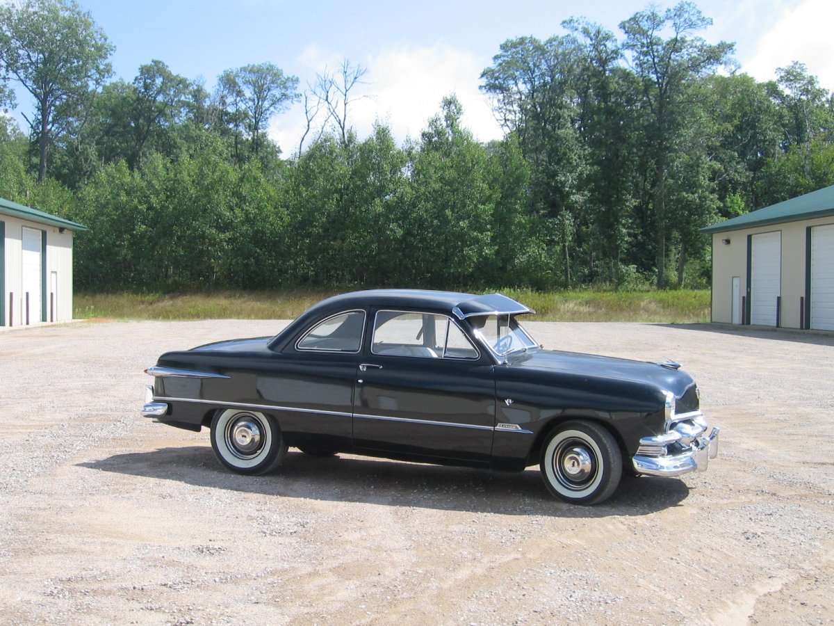

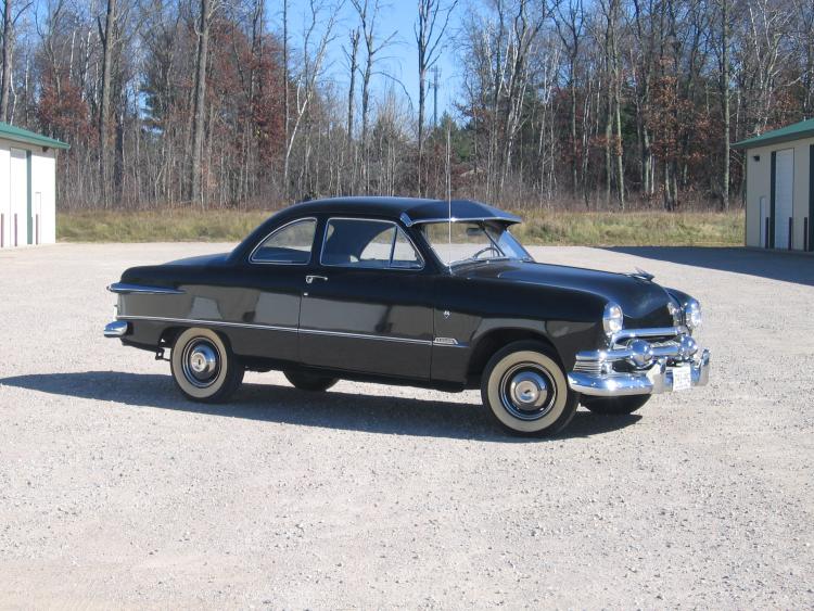

    That's a great car.
    The mind wonders. I've got a full plate but I can't help but think of "one day" project. I would like to find a 51 Tudor sedan. I would use a 1950 grille and 49 hood on the front. It would have a Y block with 3 94s. Stockish interior but with a roll bar. It would be either light gray or black, probably black.
    I really do like your sedan.
    What do you have planned for it?

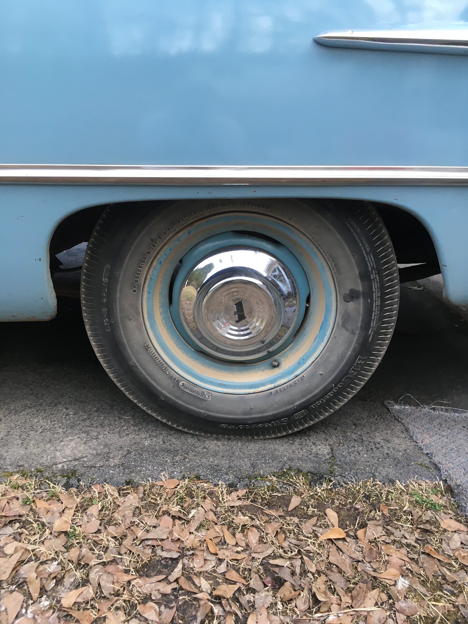

    How much did those springs lower the front? I would not mind coming down just a little but not too much...maybe a couple of inches.
    For some reason it's not as apparent in the photos, but mine does have a little rake. I would not mind just a tad more.

  13. Like you I'm a bit of Dreamer also. Your vision is very doable but I'd skip using the 49 Hood. Starting with a 51 you already have the hood hinges most 49 owners are looking for. Ford did an upgrade in 50. The 50 Hood will bolt directly on the 51 hinges. If it's the Block letters your after just add them to a 50 Hood and fill the badge holes for the 50 badge.

  15. tubman
    Joined: May 16, 2007
    Posts: 8,221
    tubman
    I didn't measure it, but here is a before picture :
    And here is an after :
    Follow the side trim forward to the front wheel and the change becomes apparent.
    Also note that the first picture was taken when the car had 4 6.70-15 bias ply Firestones and the second when the car had 195/75 R15's on the front and 225/75R15's on the rear. On the first picture, the rear shackles have been "pulled down", and in the second picture they are back to the stock configuration.
