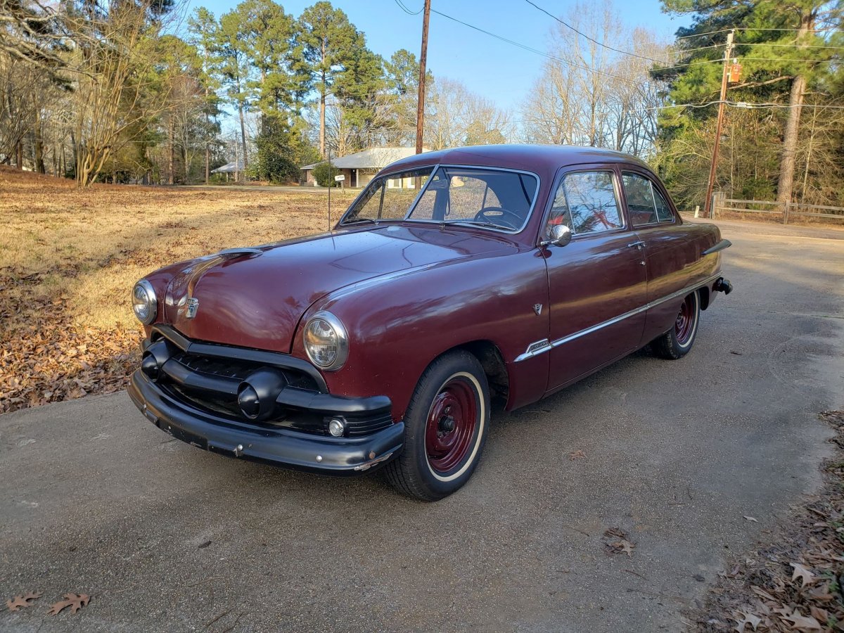

    How's it going, everyone! I made an introduction thread already, but I felt like I might as well start a thread to chronicle the restoration/modifications as I go on this 1951 Ford Custom. Snapped a few extra pictures today, so let me start with that:

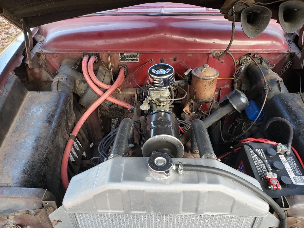

    First things first will be mechanical: Fixing some slight leaks. Getting the steering box rebuilt (probably exchange with Shoebox-Central) and whatever else is needed to tighten up the steering. Relatively minor electrical maintenance.
    First decent length drive was today. Everything seems to be functioning well. About 8.3 miles round trip. Baby steps.
    Cheers,
    Juice
  2. My boy, I like what you’ve done so far. Good work. Fixing the mechanical problems is a great start. After that just drive the wheels off the thing.

    Before ***uming your steering box is whipped make sure it is adjusted properly. Also make sure the two bolts that mount it are good and tight. The rivets that hold the bracket to the top of the frame are known to loosen up or pull through the frame in which case weld it back in place.

    Seeing that it is still 6 Volt check your wiring very closely. Especially under the dash. Mine was so brittle that it almost caught the whole car on fire but I caught it in time. Rebel Wire who is an Alliance Member and vender here is where I got my new 6 Volt harness. You got a nice car to start with so check it very well as it is only 70 years old. A lot of heat and cold cycles in it's life time and who knows what has been spliced etc.

    Wow! A Fordomatic. These transmissions were air cooled. Make sure it's getting air. The vent system can stop up on these causing the transmission to overheat.

    Those battery Cables are not adequate. They may work OK right now but they will give you trouble. You need the right size, around 00 gauge to carry 6V.

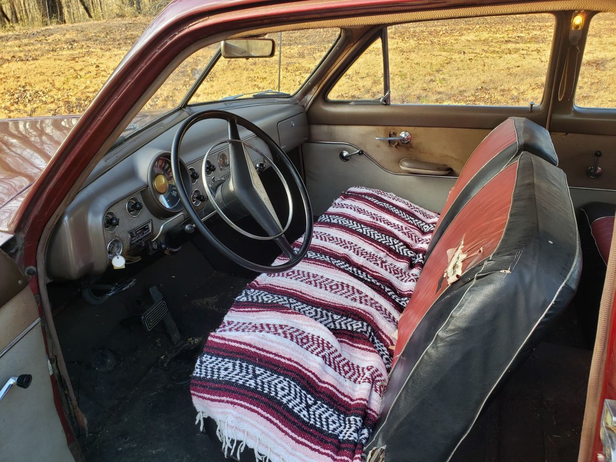

    If you plan to run the original dash gauges, get the King Seely original senders. The modern reproduction senders are not the same design and are not accurate.

    Yes definitely change out those battery cables on second look. 6 Volt generally needs twice the size wire as 12Volt throughout the entire wiring systems in the car. It is the main reason why all vehicles went to 12 Volt, Bean Counters. Lower cost boost profits. Half of the copper for the same purchase price or more of a new car.

    My seat bottom has had it. It looks the same on yours. With that said, I'm OK with my seat back. I'm going to run it. I will have to cover the seat bottom.
    I have already found a roll of similar material (it's a solid color but it is close enough to the seat back) from the local fabric shop. I'm simply going to use that material to cover the bottom cushions front and rear, leaving the seat backs in their old fabric. I may do some sewing but my present plan is just to hog ring the new overs over the bottom cushion and neatly fold them over on the edges. Padding? We'll see when I get the seat took down.
    It looks like your seat back may be better than mine. I see the original striped material through the vinyl so those backs may be presentable and you can just cover the bottoms. It's really simple to do and you get to enjoy the original stuff for as long as it lasts. Then you can do the tops.
    Once that Old stuff is gone, it's gone for good.
    When these cars were 20-30 years old that interior stuff would be ripped out. Now, Being 70 years old, my personal thing for my car it to keep that stuff and try to preserve it.
    The cost of new upholstery orbits the moon, so that's another motivation.
    If the bottom seat cushion springs are broken, they be repaired fairly easily. Most of the time all that's required is realigning and clamping the coils back into position. Broken spring frame (the heavy wire) can be repositioned and repaired by steel tubing and clamped.
    Your car is what's referred to as a Cream Puff.:D It's not quite Cherry but is definitely a little Cream Puff.;) It is very probable that that paint is original. If not it's a simple respray of the original color.
