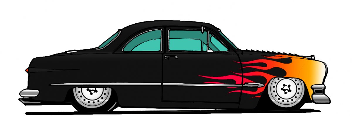

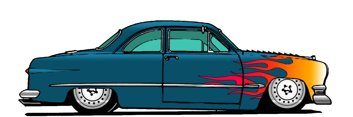

    Messing around with some concepts while I drive whenever possible and wait for a couple of parts to come in. Sprung for the non-universal wiring harness, a couple of interior odds and ends, and a new oil filter canister since the old one is drippy. Still haven't gotten a chance to figure out the transmission leak but it appears to be a very slow one.
    Found a small crack in the head on one side. Dad thinks it's from freezing (he swung by for the Superbowl and to give the car a test drive).
    Anyways, just playing around with some colors and rim options. Liking this general feeling. Lowered some, aluminum rims, louvered hood. I've tried it with and without the side trim, but I'm leaning toward leaving it for now. Might change my mind later.
    Shame that the maroon is my least favorite (of these three), because it'd certainly save some time and effort to not have to start fresh with a new color. Thanks for all the continued information and support! concept1.jpg concept2.jpg concept3.jpg

    Realized upon posting that that last one's way more red than maroon. Had been staring at the screen too long. Here's something closer to the original color (Looks a lot better now). concept4.jpg

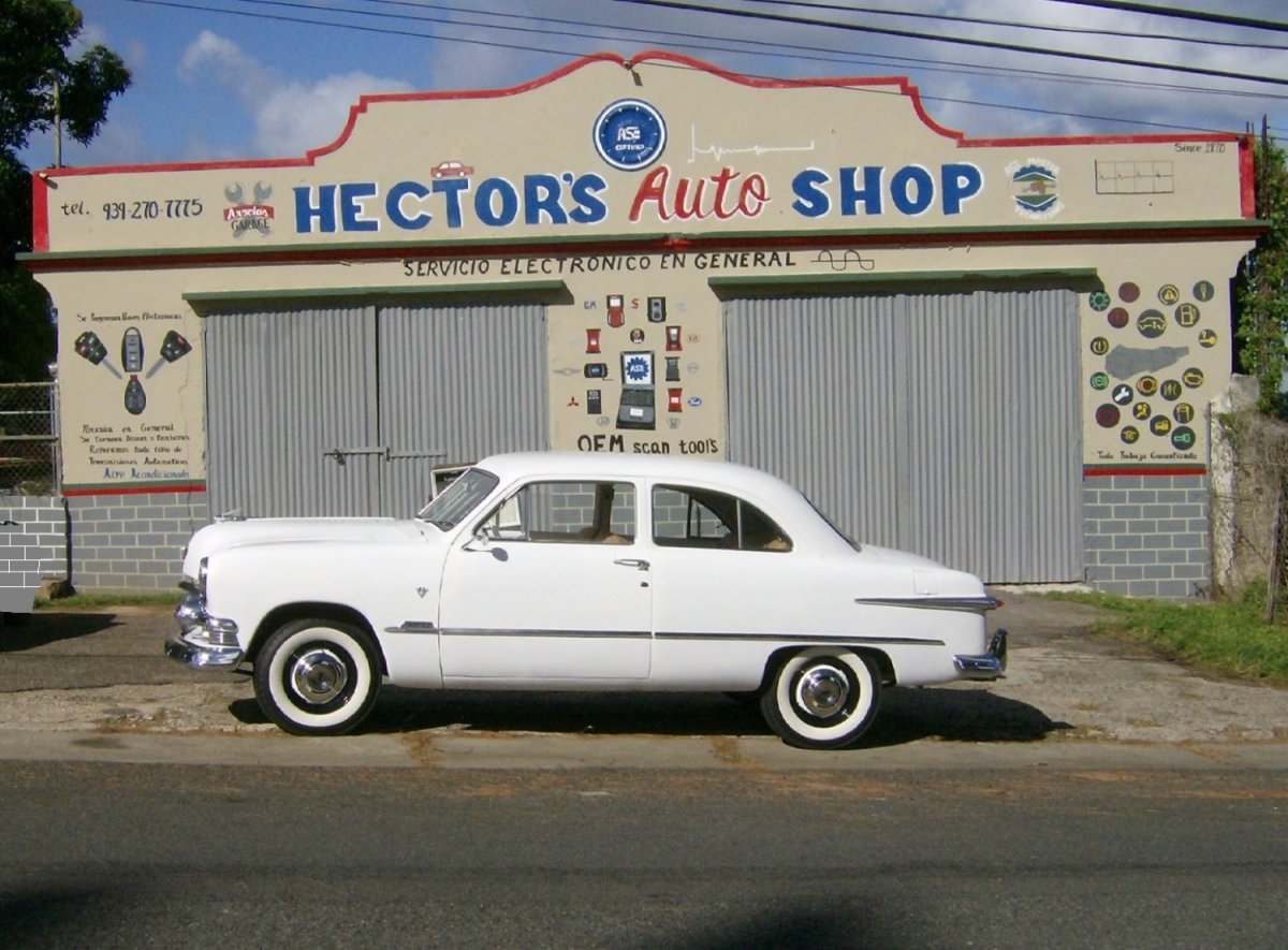

  16. Juan Ford
    Joined: Oct 29, 2020
    Posts: 40
    Juan Ford
    Hello Juice
    I just bought a 1951 shoebox and I will be following this thread for information and ideas for my car. I will be upgrading the brakes to disc and dual master cilinder as I`m not happy with the brakes. I installed a front sway bar from Jamco to improve handling. The car has a few things that need fixing. After reading this thread today I will be cheking the mounting of my steering box and adjustment.
    Juan

  18. Juan; Nice little Sedan you have there. Having one myself and have owned several I know the Stock drum brakes can't do what late model brakes can. That said I also know that when the Stock Drum Brakes are in good operating condition they will stop that car just fine, now that's depending how how aggressive you drive. Also if you live in the Mountains and like to straiten out the curves I might want something better but then you have the limits of the steering itself to deal with also. I would think long and hard being there is NO kit out there that will make doing the change over a simple job for you. I know what the Big Color Adds say but none are as advertised. The aftermarket suppliers are in business to sell parts not make them work for you. I would do a total overhaul on what you have long before doing the change over. There is also a Right way to do a brake job and it's not just installing fresh parts. My advice being your fairly new here, Spend some time reading about all the Headaches that are Self Inflicted by guys trying to follow instructions on a Disc swap. If there's One there's a Thousand, It's a never ending Question here. I don't even reply or try to help on them anymore. Hit the Search menu and you'll see what I mean. If it were as simple as buy this and follow instructions 80 percent of those would not exist. Don't discount what you have unless it's just not good enough for your driving conditions when in it's best condition. This personal point of view is coming from a Guy post 70 and has always believed the Best Stock Car is the Best place to start building Hot Rod. Restored cars are for Old Men and the New Factory stuff is best suited wrapped in Vintage Tin. However not everything needs to be upgraded on all Old Cars just because. Looking at your Car I think it fits in my last sentence. I like your Car, keep it Safe and keep things Simple and enjoy what it is as it is.

    ^ I have to agree with this.^ I have a '51 club coupe with stock brakes and a "warmed-over" '51 Mercury engine. When I built the car, I made sure I used all quality brake components and replaced all of the hard lines, even though they looked fine. I have never had any problems or even complaints on their effectiveness.

    Juan, listen to what Pist-n-broke is saying. He is well aware of the capabilities of these cars and yours appears to be sitting at a stock ride height. Have you considered lowering it at all with Aerostar front springs and lowering blocks in the rear? You only have 9 Posts so you cannot PM anyone until you have 10. When you do either PM me or Piat-n-broke for information on the proper handling and suspension on these cars.
  21. Juice1990
    Joined: Feb 1, 2021
    Posts: 21
    Juice1990
    Y'all can feel free to just share here! I'm planning on lowering a few inches as well so it's relevant.

  27. Juan Ford
    Posts: 40
    Juan Ford
    Thanks Juice. I will be saving the 51 Ford drawings that you posted,All of them look good to me. Lowering the car makes it look real slick!
