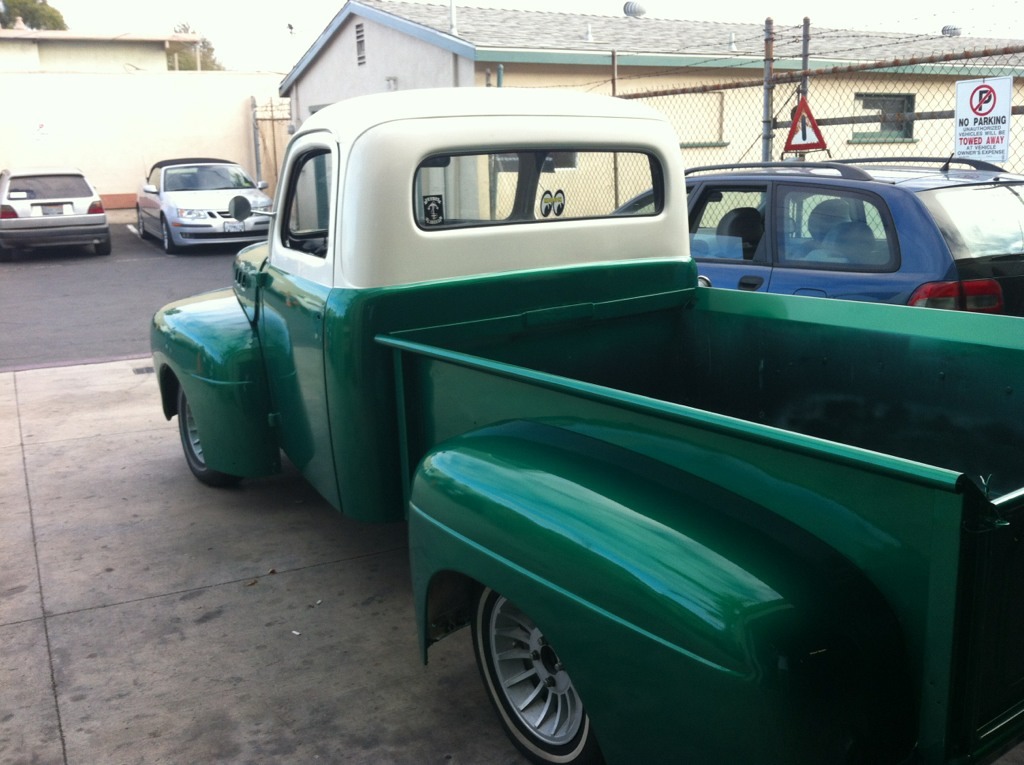

    Thanks guys!!! I'll be putting the bed and hood on it tonight but will wait a week to ***emble everything else so that way the paint is harder. ImageUploadedByH.A.M.B.1379437265.176589.jpg ImageUploadedByH.A.M.B.1379437328.698819.jpg ImageUploadedByH.A.M.B.1379437356.129375.jpg

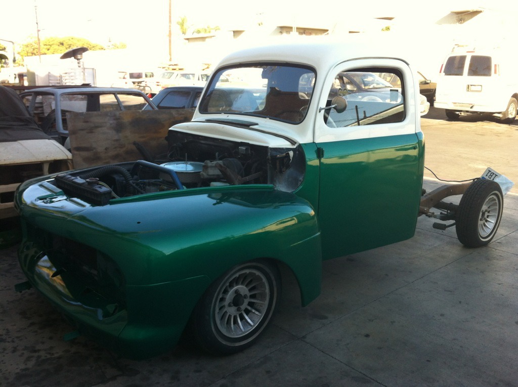

    Skinnydennis , I'll check it out because that's next. Here's how it sits right now, I need to put the grill on tomorrow. ImageUploadedByH.A.M.B.1379463923.634113.jpg

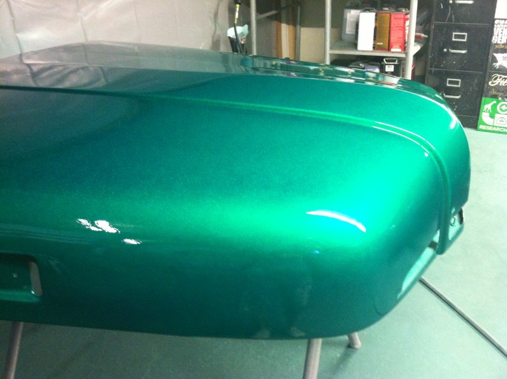

    Drptop70ss it was the emerald green metallic acrylic urethane. It is single stage metallic so it is kind of a pain to lay on even. We used a sealer over the whole truck to get the color more even. The sun almost came out when I got it in my yard so I snapped another shot. ImageUploadedByH.A.M.B.1379469422.531010.jpg

    We used a slow reducer so it would flow better and not tack up so quick. I would recommend a BC/Cc like you mentioned. It would be way easier than SS metallic. It would be much better to color sand/polish as well. I'm worried if I color sand it, there will be some shadows in the metallic.
