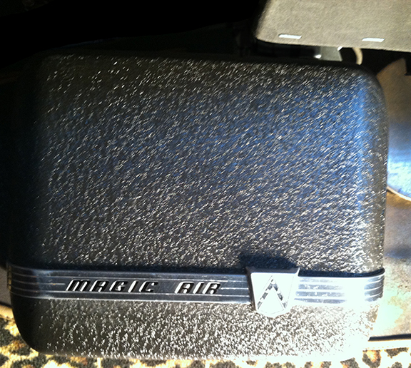

    This is in my '51 Woodie
      335 KB
      226

    Just went out and looked, and this is the Ford heater in my '52 Five Star Extra. I have a NIB aftermarket "universal" heater that I picked up at a swapmeet, I remember installing a few of those in my gramps' old coal delivery and milk route trucks when I was a kid in NY. Kits came with the switch and even the hoses to hook it up
